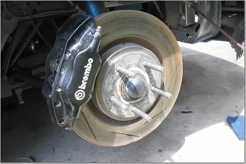

I am going to have to agree with Bimmertech on this one, I would send those rotors back if the veins are as you say.
:nice:
there is a strong possibility that the cooling vains are straight, then it doesn't matter--other than looks.
if he says his instructions say to mount it that way then i believe him, it is just a little unusual to me.
how about this one, which way is right here? :D
Guys, I have those same brakes. He has the slots going the right way. He is 100% correct, so dont knock him for it any more. The rotors even have arrows pointing to the front of the car. I made the mistake of thinking that I put them on wrong and switched them. Now I have to switch them back, not too much of a PITA because I plan on doing my rims up before I hit the road again. Since winters still here in NE I have to sit around and wait until things clear up and I can re-register my car.
