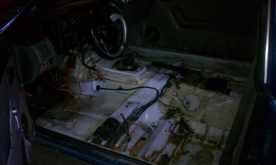

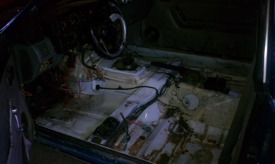

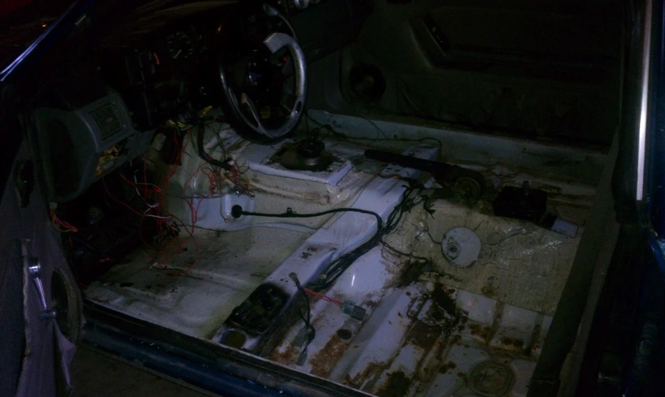

I got my interior cleaned out, noticed a couple of tears in the floor pan that need to be welded up and a little bit of rust. Going to get it welded up this weekend and get my interior back in. MM Subframes and CAI from LMR will arrive this Tuesday the 19th and I'm going to get those in and get this damn car on the street!! I'm getting fever to drive it or get rid of it.
Uploaded with ImageShack.us

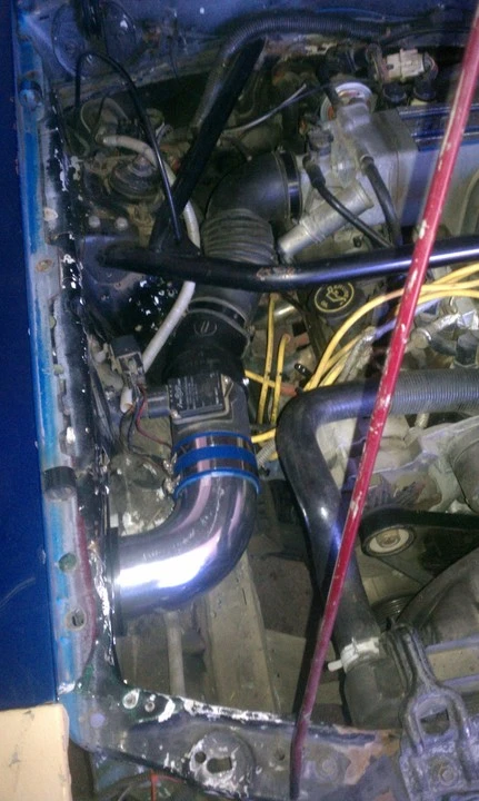

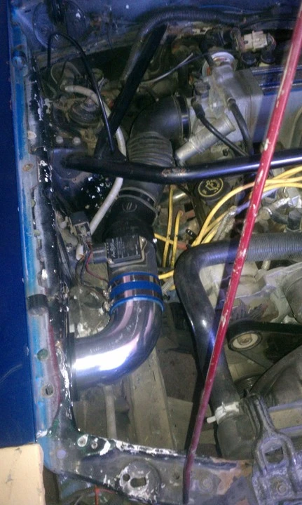

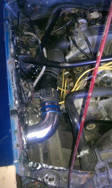

Anyways, got the CAI installed. Couldn't get it to fit right with matching chrome pipe that came with it so I'll tackle that another day.

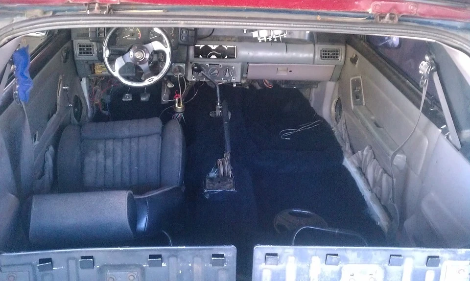

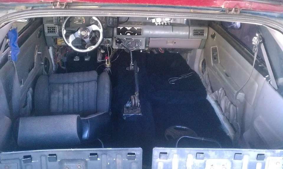

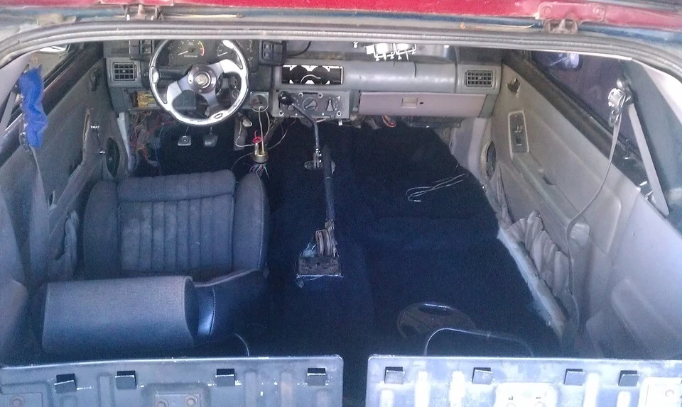

Now for the stupid. I got the floor pans welded up and new carpet laid out inside and holes trimmed for the shifter and e-brake. I had been trickle charging my battery all day and wanted to fire her up since it's been about 2 months since I did it when I did the A/C delete and PS pump relocation. As I was installing the carpet I kept looking at the oil pressure line that I disconnected months ago and was thinking I need to hook it back up before starting it up. Needless to say I forgot and I had a puddle of oil on my driver side under the peddle assembly.
Carpet laid in before the Exxon spill
Feel free to verbally flog me on being an airhead. At least it's black carpet and I'll only smell it, lol

That sucks man. :(
All you can do to try and get it out (and the smell) is use your favorite flavor of baking soda based Carpet Fresh. Let it soak up as much of the oil as it can, vac it out with a shop-vac, and repeat (many times).
As an alternative (if you want to remove the carpet) is to use warm water (hot to the touch) and a dish/laundry detergent mix.
Stay away from harsh detergents/cleaners.

Thanks Noobz, I was wondering what kind of cleaner to use and some baking soda should make a big difference.
I need to replace the line anyway. I have the clear plastic/PU like line and want to upgrade it to a stronger more reliable line. Any suggestions? Is there a S.S. braided line for OP gauges?
