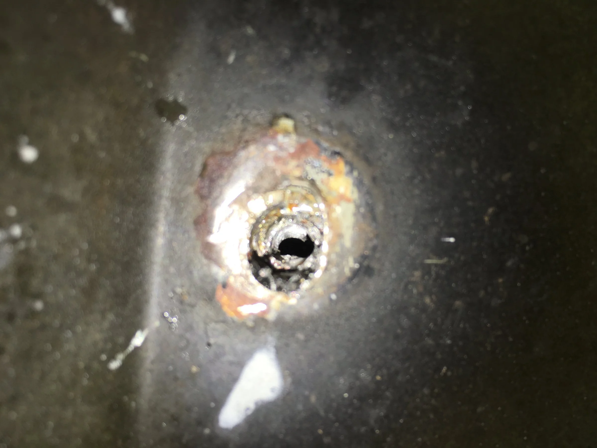

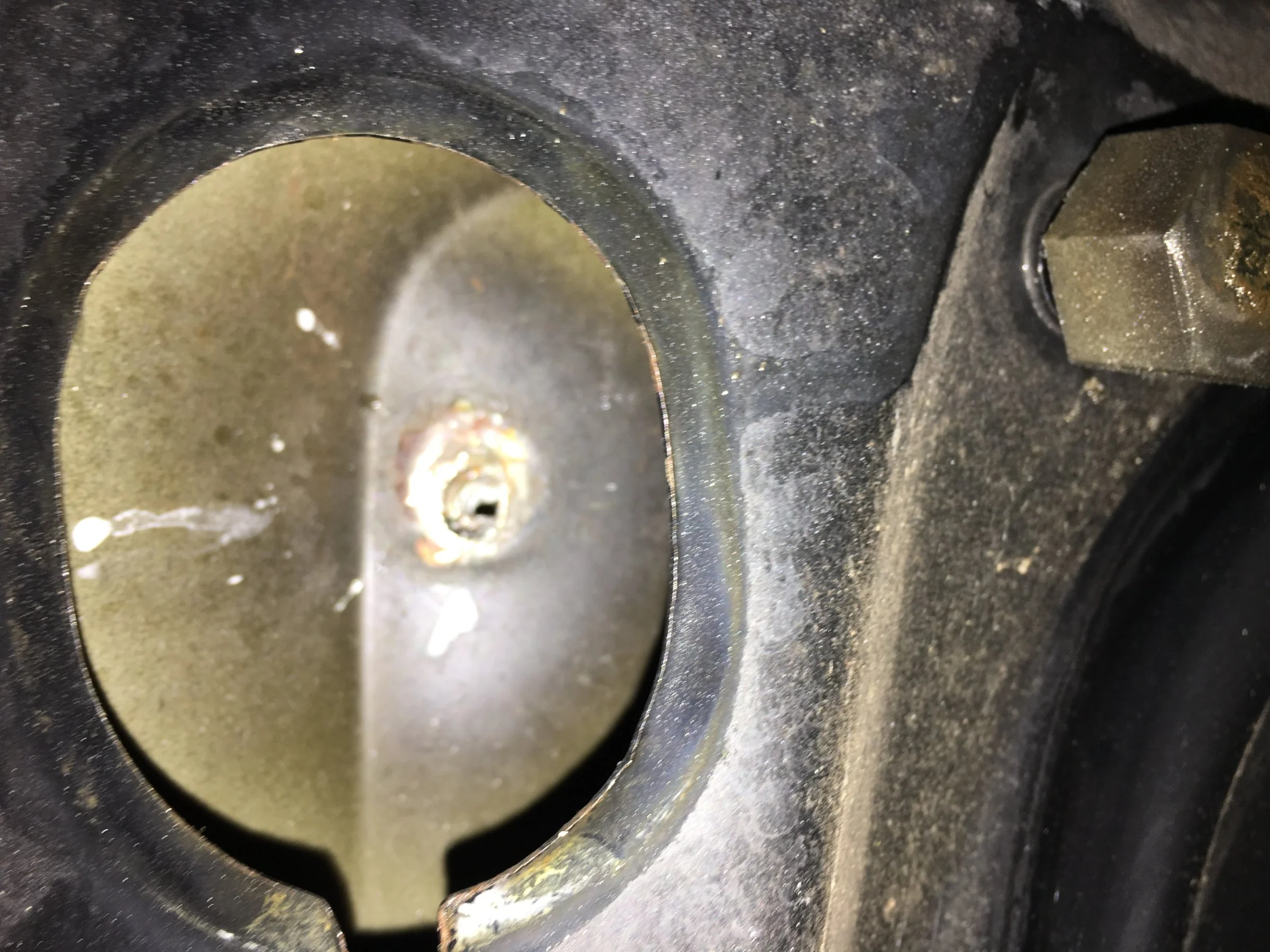

I was installing a saleen wing on my 93 gt. Got them all in, was just tightening them up and the back pass side bolt broke. The head came off. I used brand new 1/4 bolts from Home Depot. I tried to drill it and get a flat head to turn it out but couldn't do it. Got an extractor, that didn't work either. the way it is now , it's basically a broken off bolt with a hole through it a little smaller then 1/4. Any ideas? I was thinking about just using a strong glue on that part and just having the rest of the bolts hold it down if I can't figure anything else out.

How thick is the metal that you are working with? A picture would help.
Use a 13/64" or a #7 drill bit to clean out the broken bolt remnants, then use a 1/4"-20 tap to re-tap the threads.

From the looks of the hole, it is thin metal. What you need is a rivnut...
View: https://www.youtube.com/watch?v=AfQIYLSKGwI
Google 1/4" rivnut for more information.
