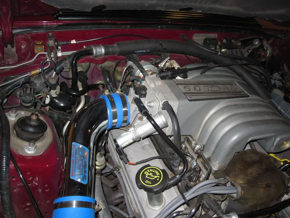

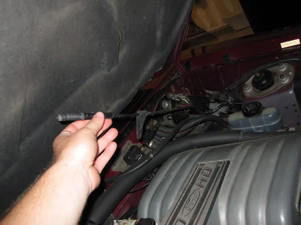

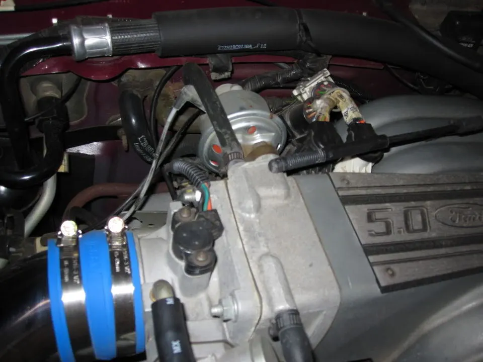

I bought a mustang with 10K miles on it - the only problem is that the cruise control does not work. The cruise control cable that is in place, is too short (no idea why).

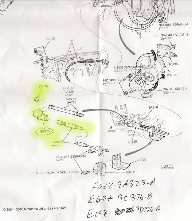

1 - Looking for a cruise control cable with all the right parts. The part that seems to be in place is something similar to 9A825 (although too short & missing other pieces). I also need the other 2 parts for proper connection.
2 - I have been looking everywhere for these parts. Ford does not sell them. I was told that any 5.0 cruise control cable will work. Is this true? Here is what I found on Ebay, not sure if this will work.
http://cgi.ebay.com/ebaymotors/86-9...r_Truck_Parts_Accessories?hash=item2559c77a8d
Not even sure if this has all of the pieces, although it looks like it does.
Here are some pics that I posted on here showing what I have currently:
