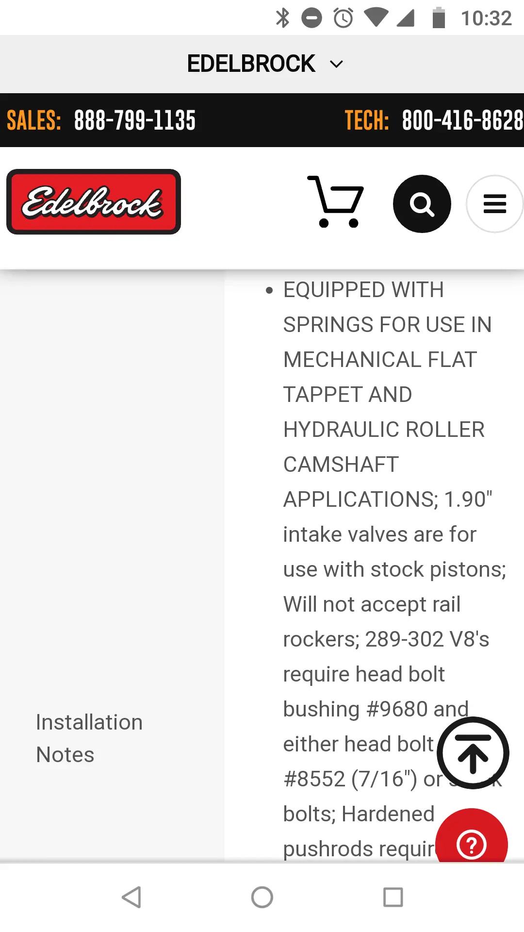

These are the install notes. Says the springs are good?
