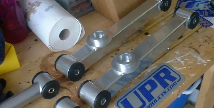

I have UPR aluminum ones. They are a little pricey, but I love the control I have now as compared to before and I allready had subframe connectors.
