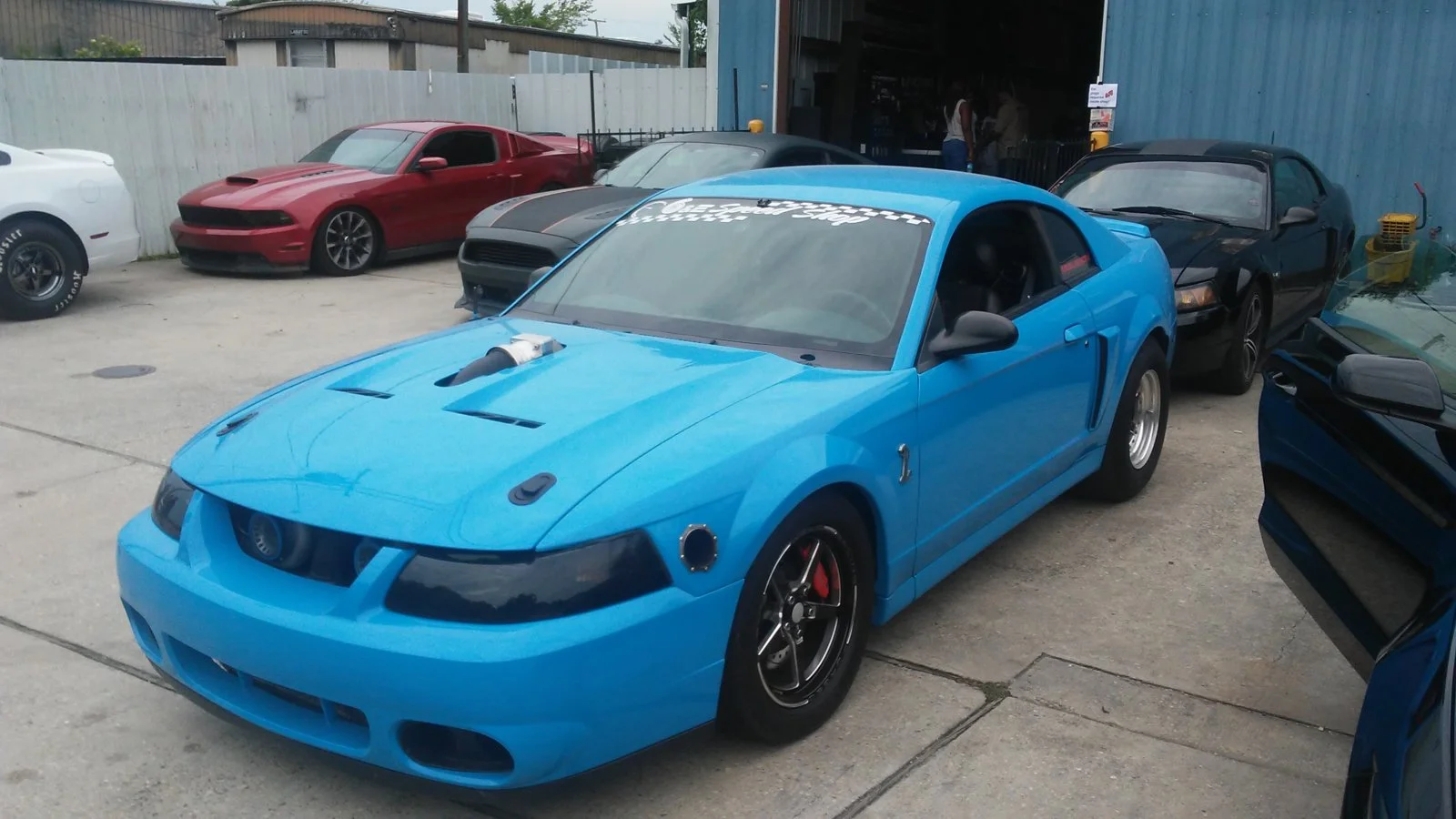

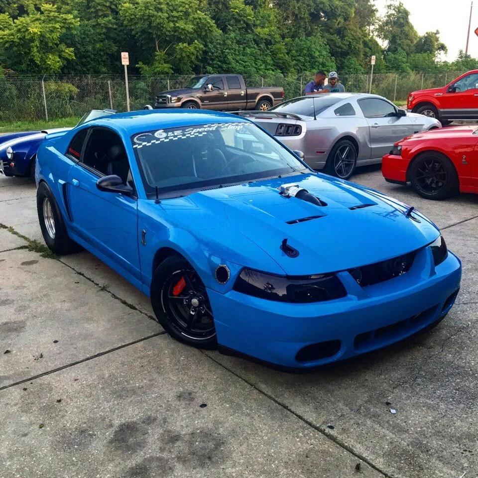

Twin turbo. On a 03 4v cobra.. 6 speed.. If you want power. This twin will push 1300hp
That's a pretty nice club car. Think I'll stay with mine but I am impressed.
