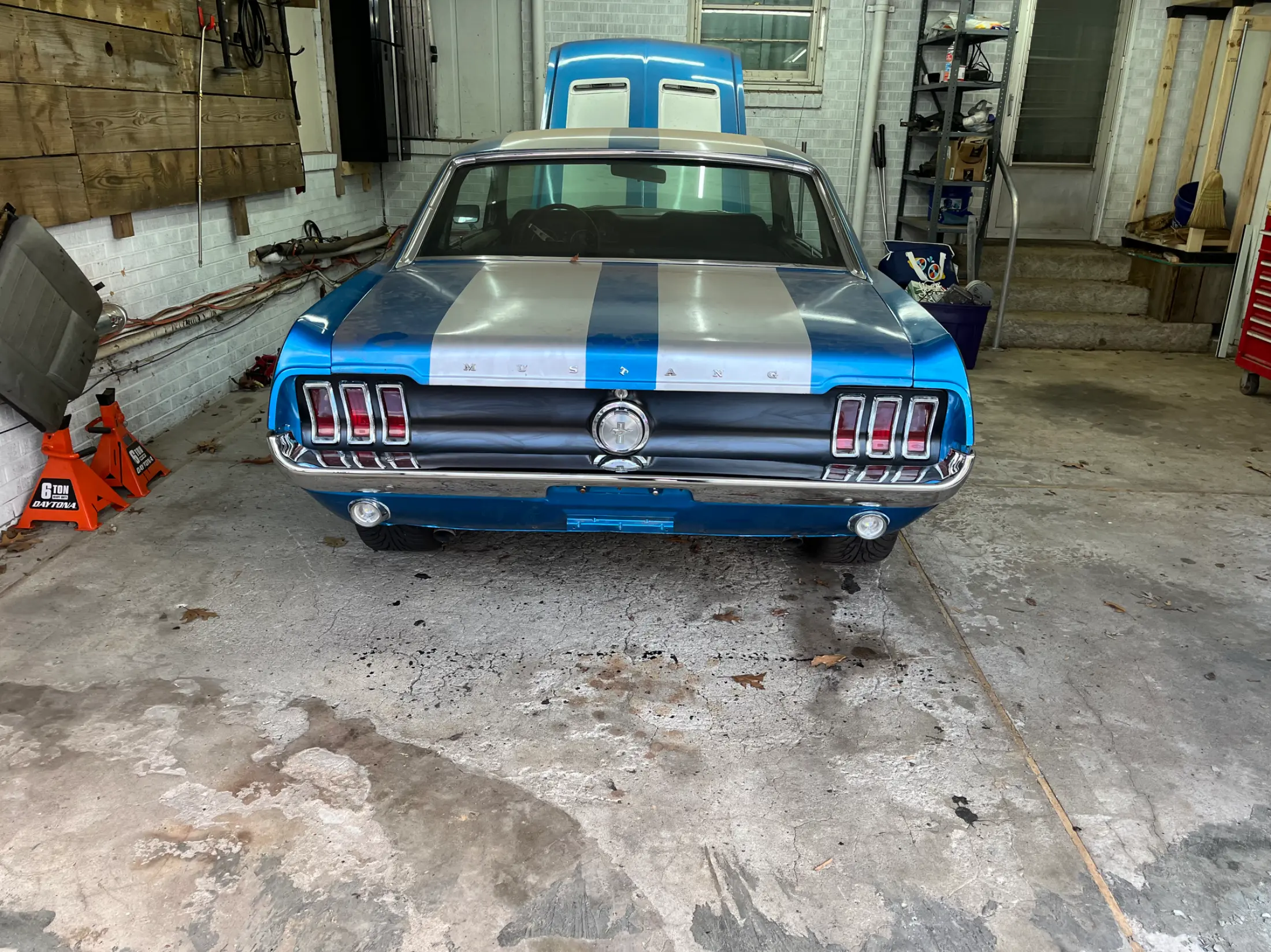

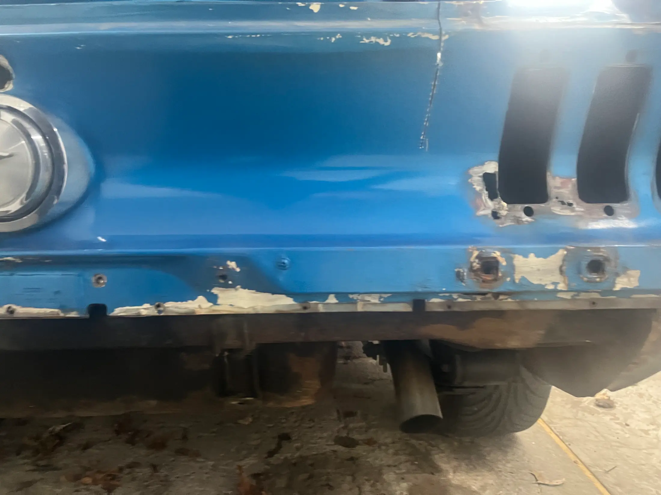

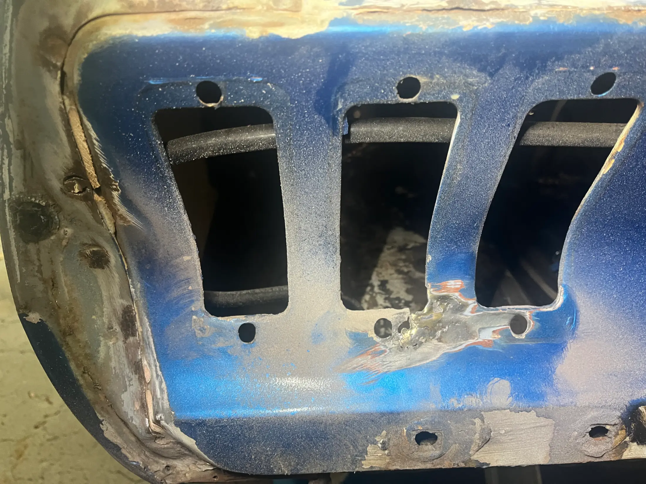

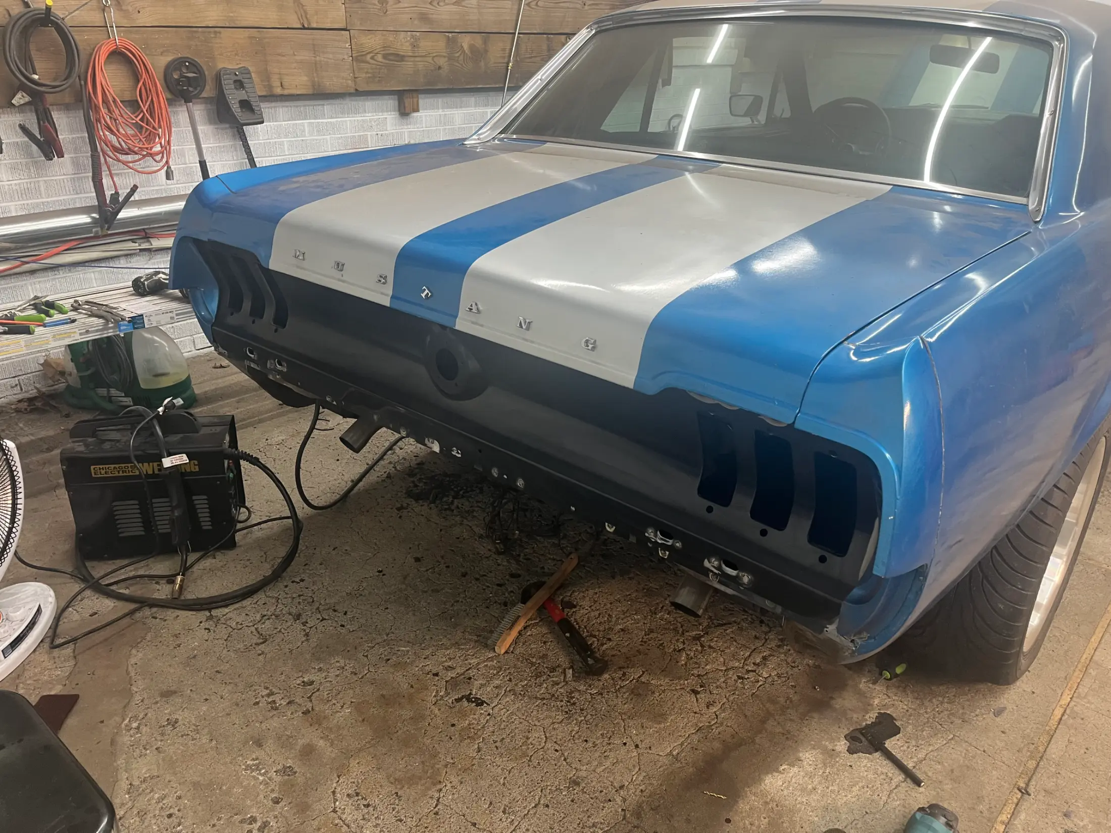

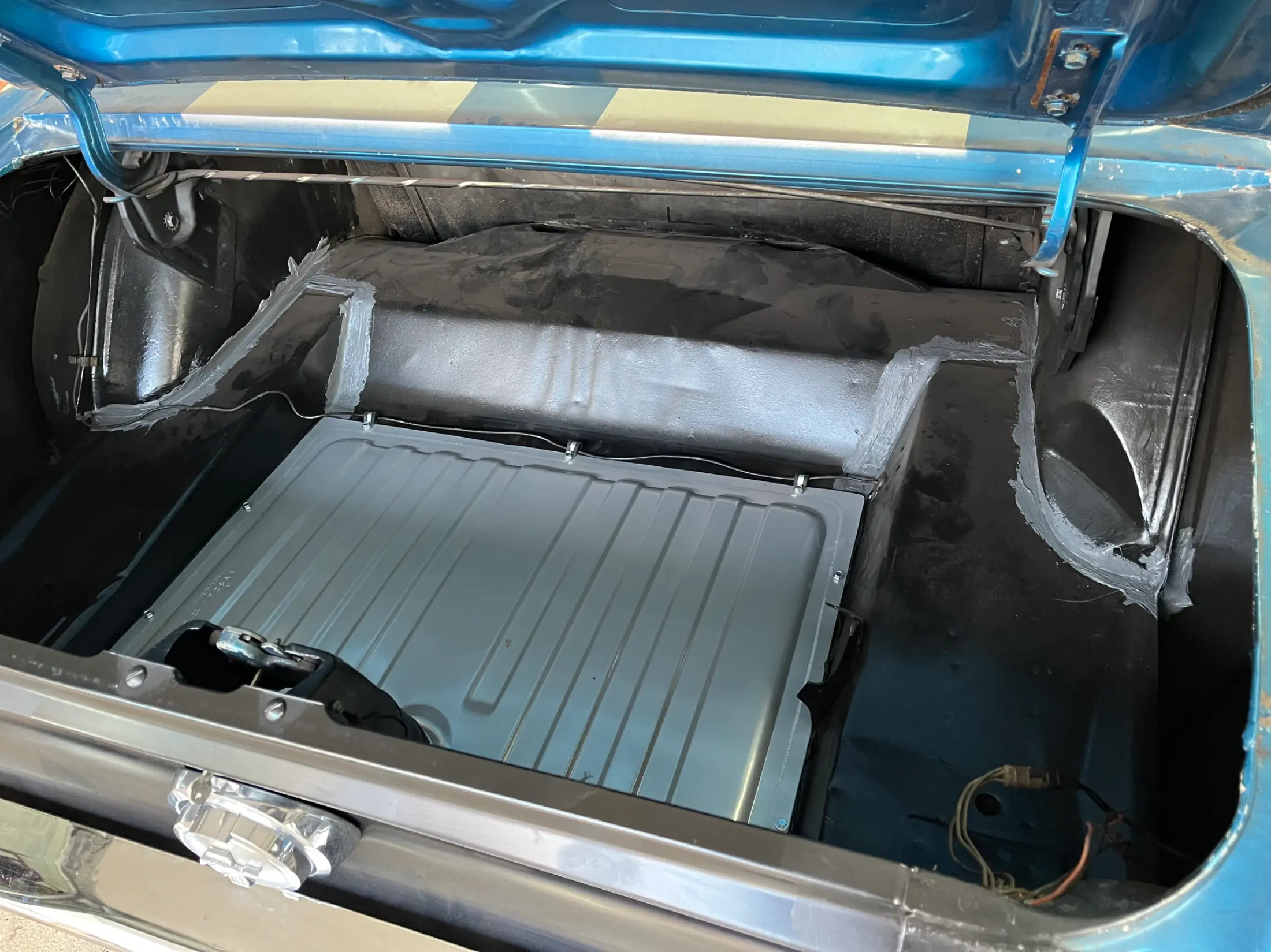

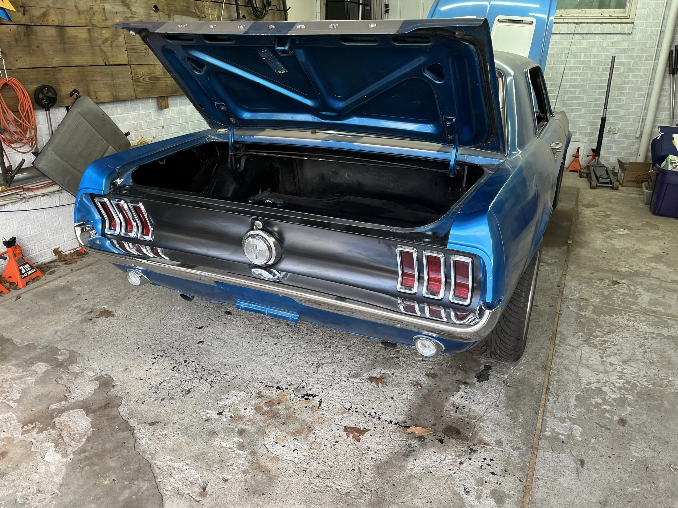

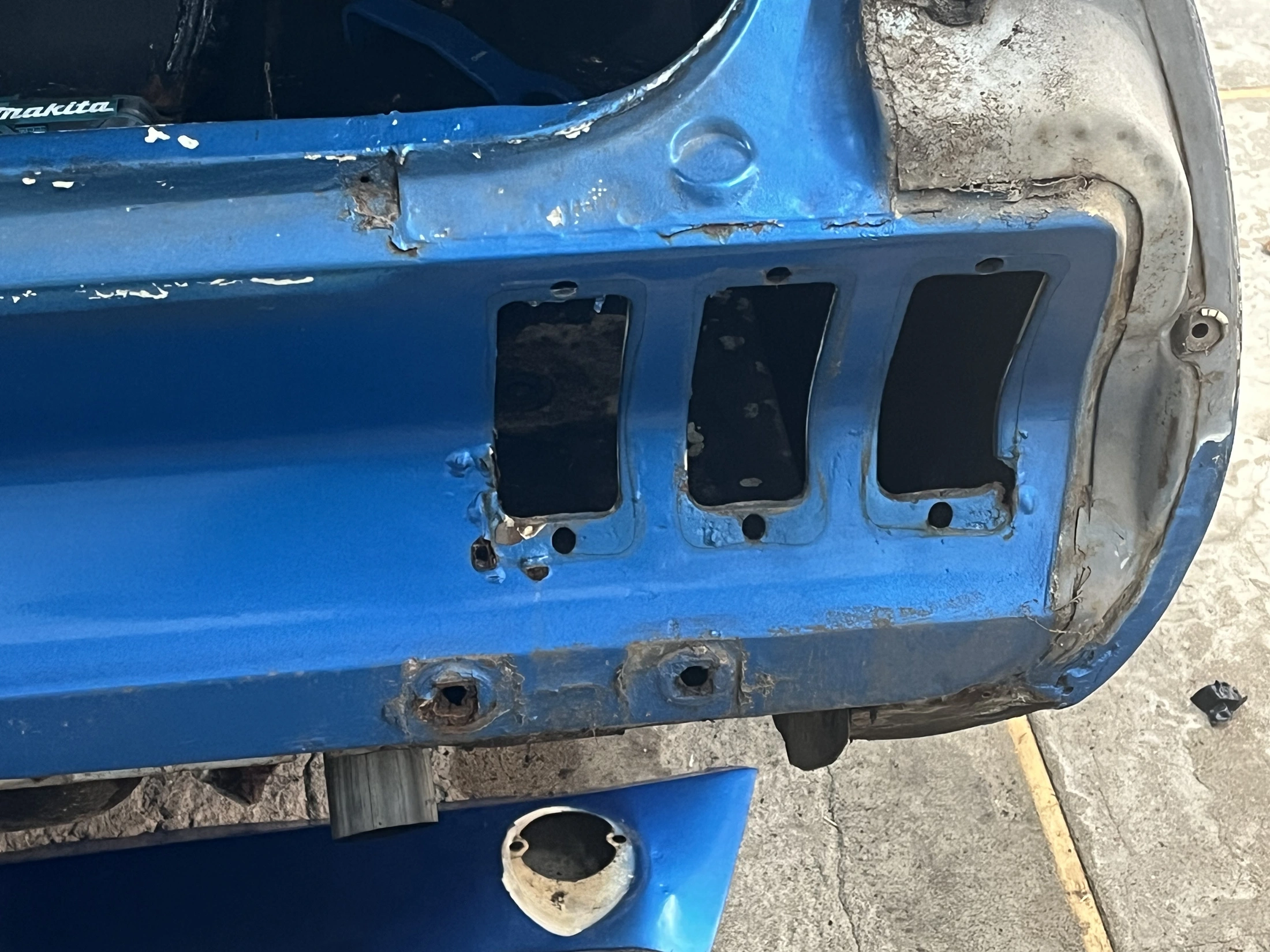

Figured it was time for an update.
started my winter project.

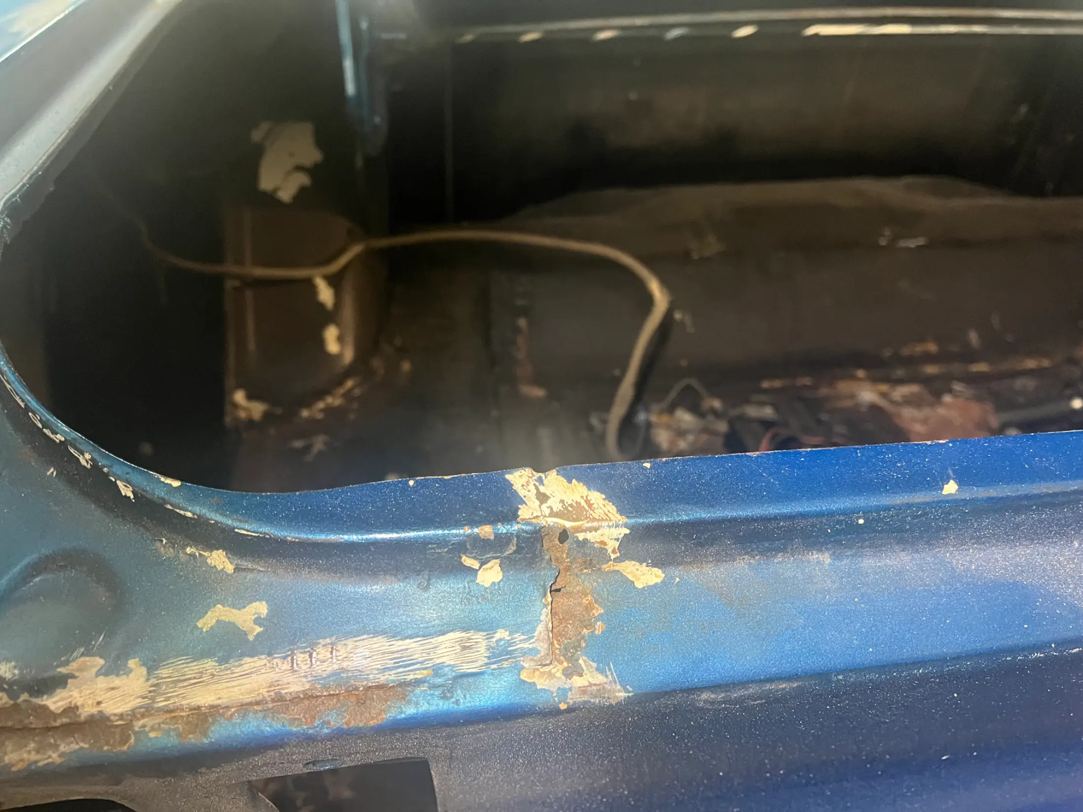

Goal was to clean up the inside of the trunk. Remove surface rust, prime/paint.
Then do the same for everything rear of forward leaf spring mounting point.

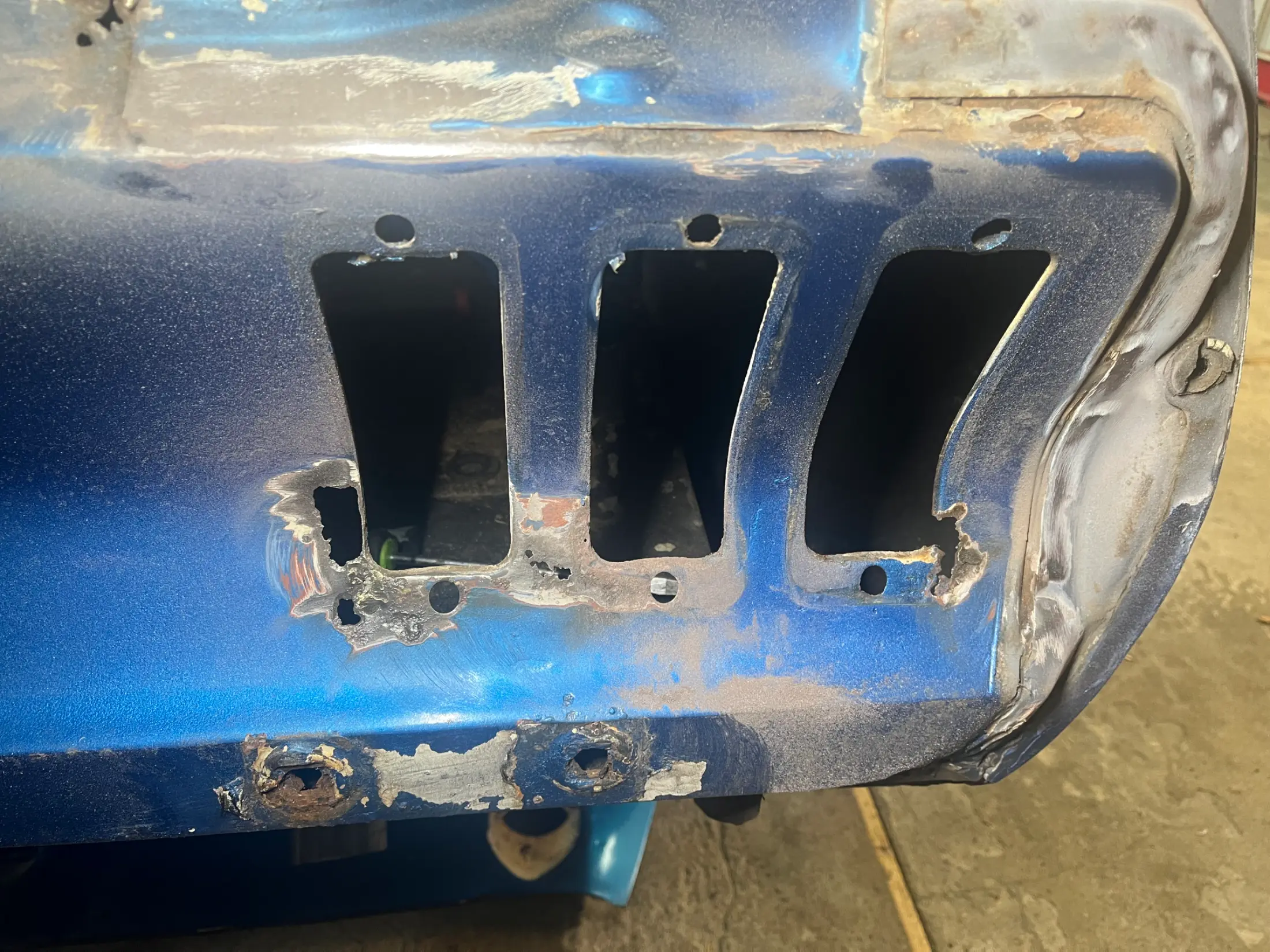

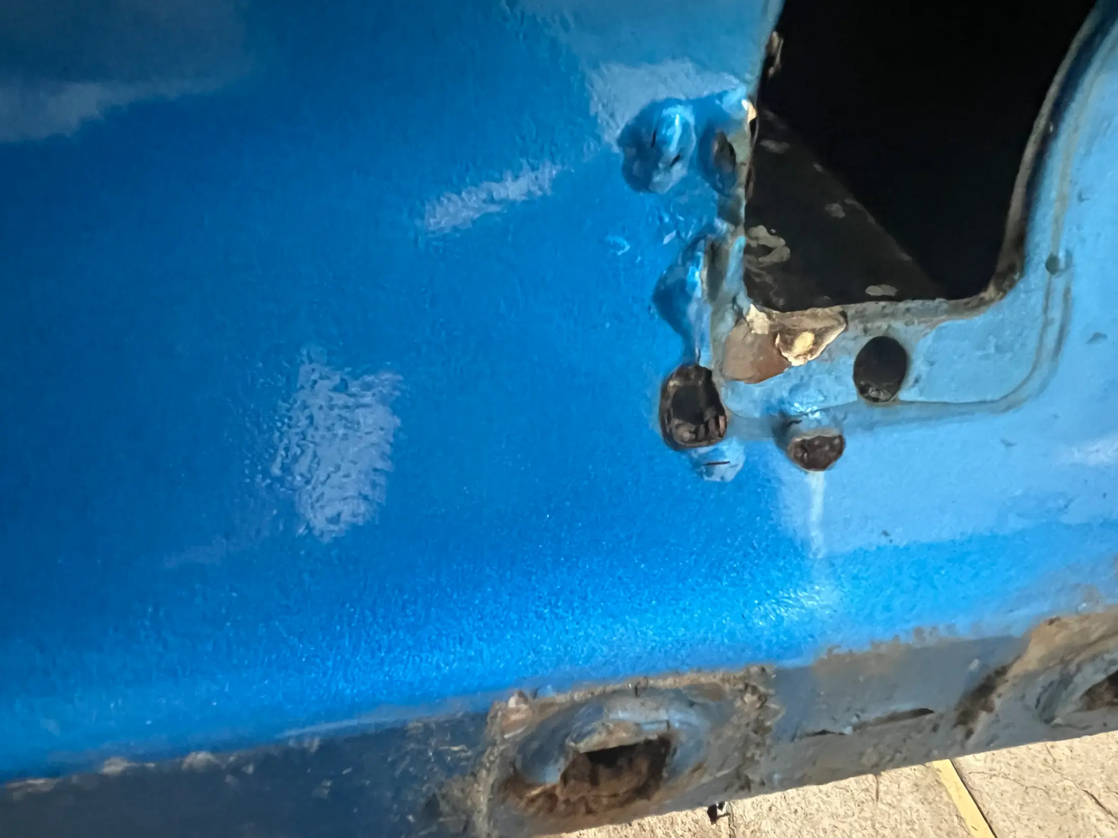

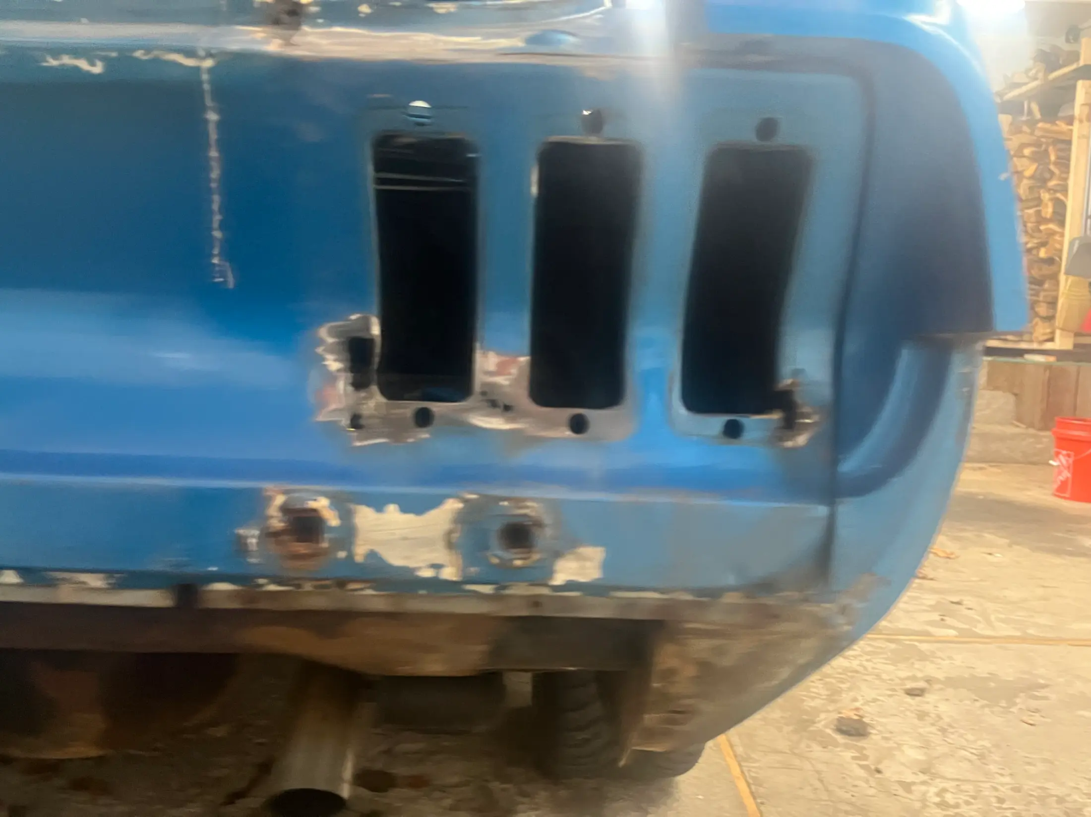

Discovered that the taillight panel was rusted through in several spots and had been repaired once before with some mid welding and a bunch of bondo.

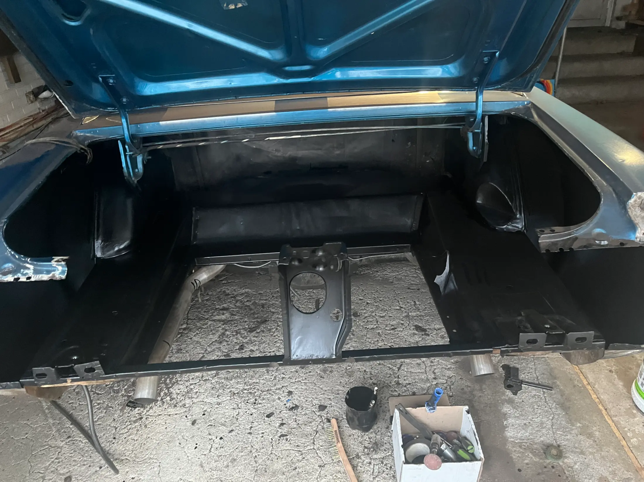

so far I stripped the trunk , got it primed ,
And replaced the taillight panel.
I really need a heater in my garage
