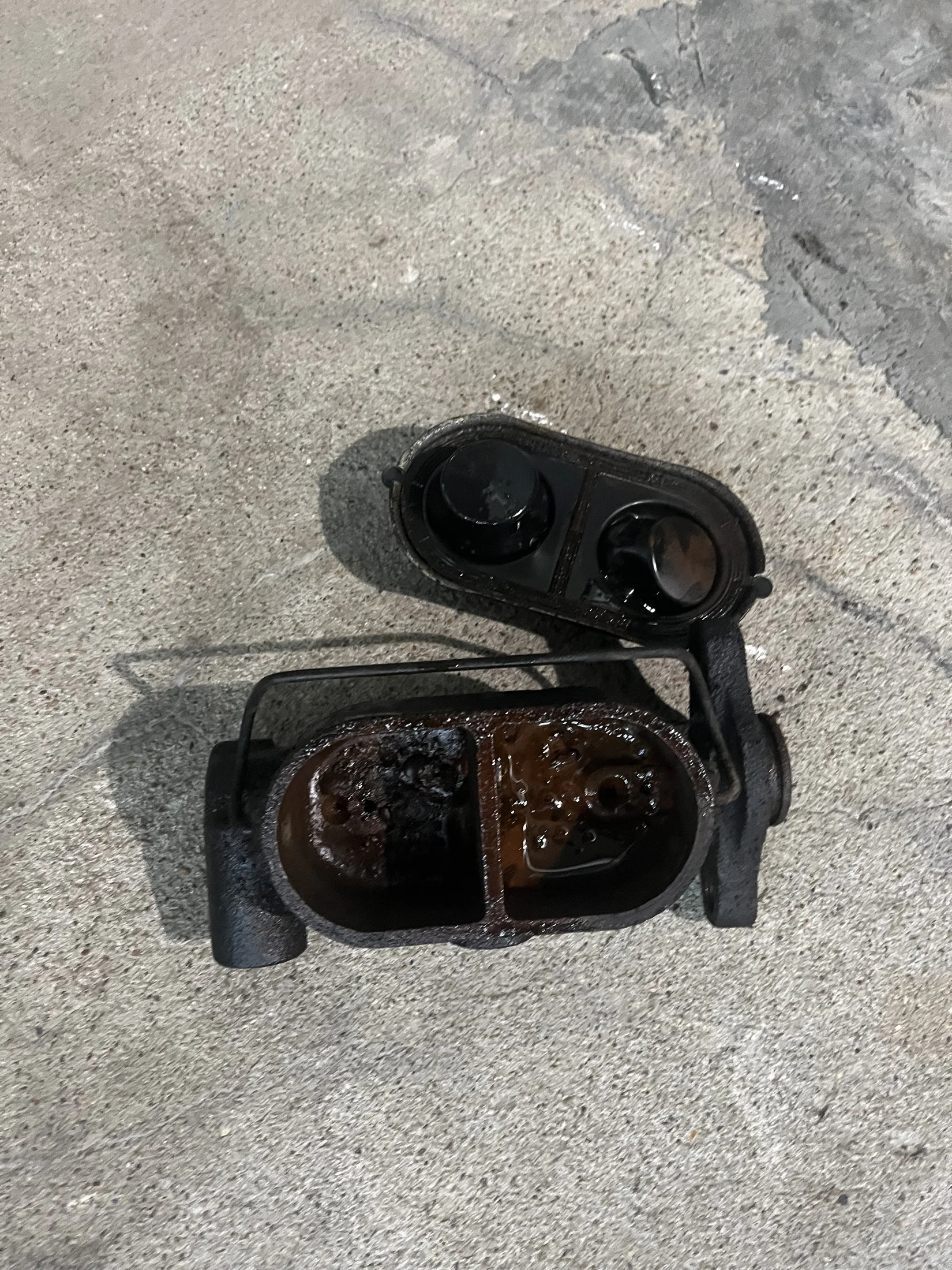

Recent purchase with very little drive time due to complete failure of the brakes.

Brakes** 4 wheel manual drums. They were pretty soft when I test drove it, I assumed it needed bled, but found the Master cylinder to be full of rust and nearly no sign of fluid in it. The car was driven to a cruise and in a funeral perssesion the day before i got it "saw the videos myself." Brakes are getting over hauled.

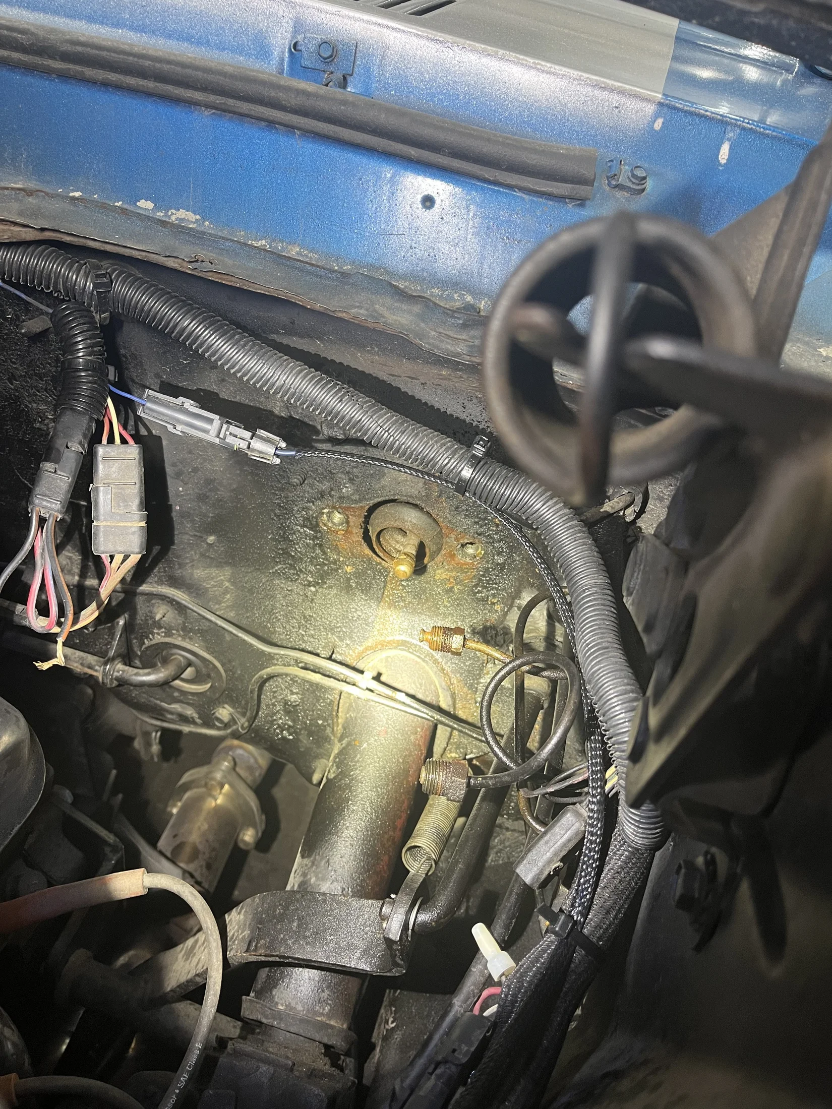

Trying out purple power to clean things up. The only hardlines are soaking and seem to be doing the job. They'll get inspected tomorrow but i'm probably gonna replace them.

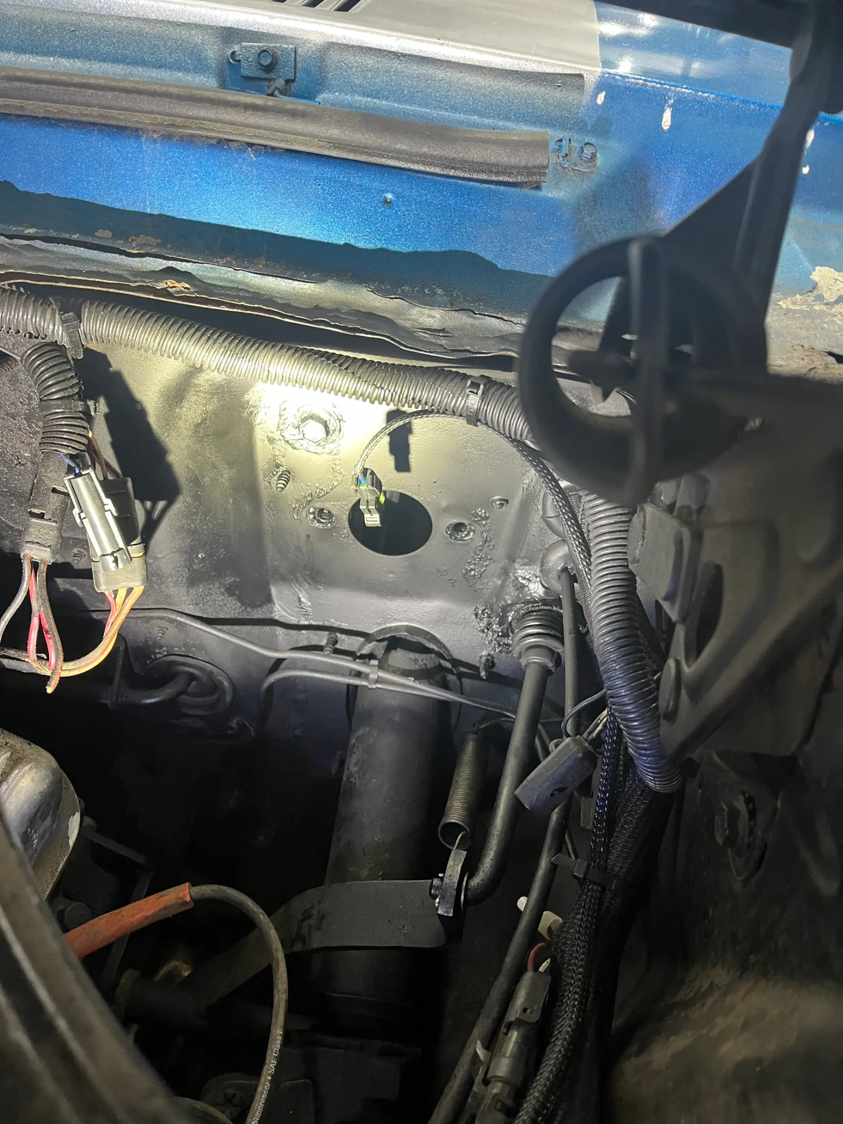

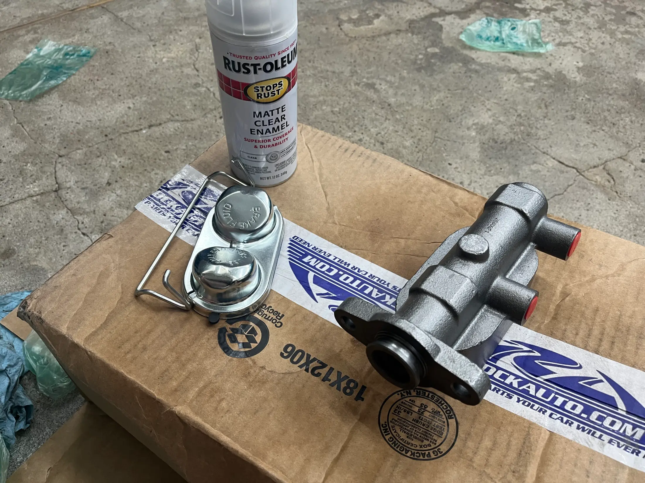

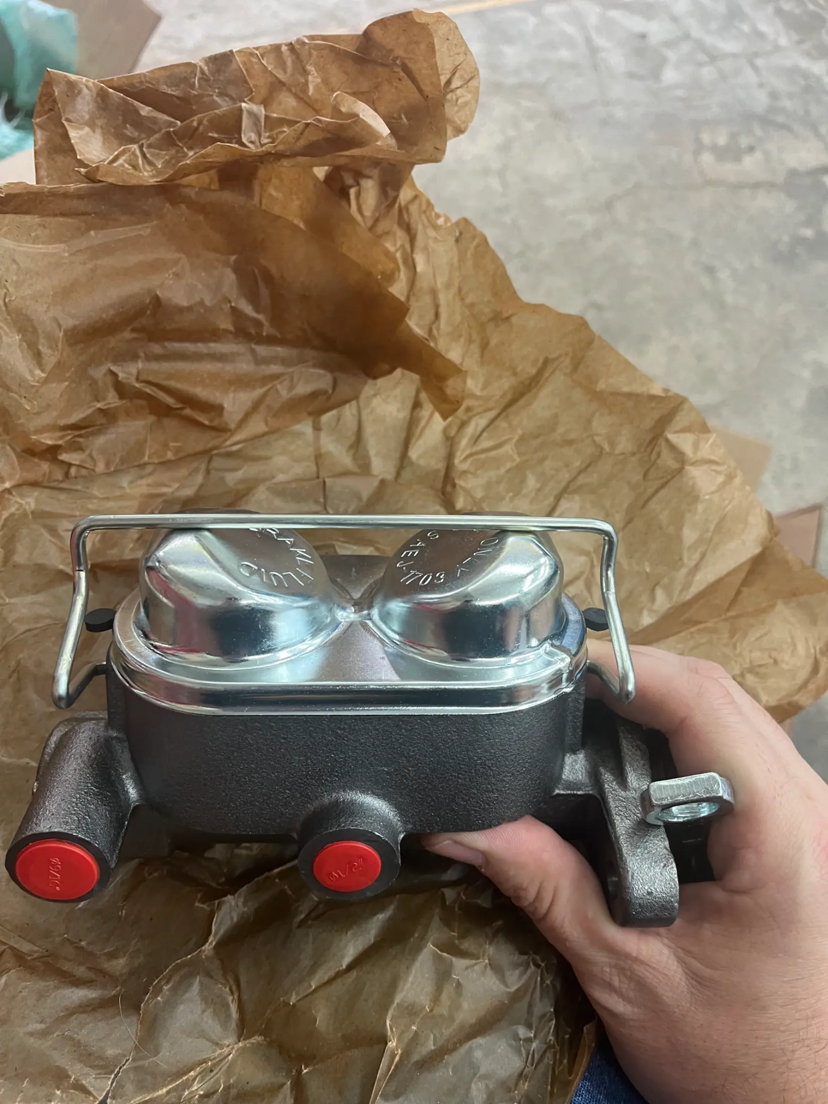

New master cylinder is in, it looks good. Unsure How I feel about the chrome lid but that's a detail for another day. The master cylinder got 2 coats of matt clear so it'll stay looking new.

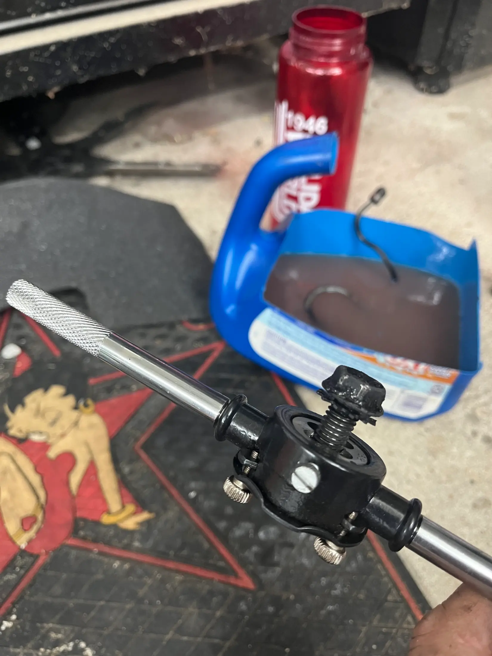

The hardware for the Master is soaking in purple power and threads are getting chased with tap/die
lastly, the firewall where the master mounts got got a detailed scrub down and wire wheel. Only surface rust, so pretty happy there. hit it with rust converter, primer, paint and letting it dry. The threads will get chased tomorrow.

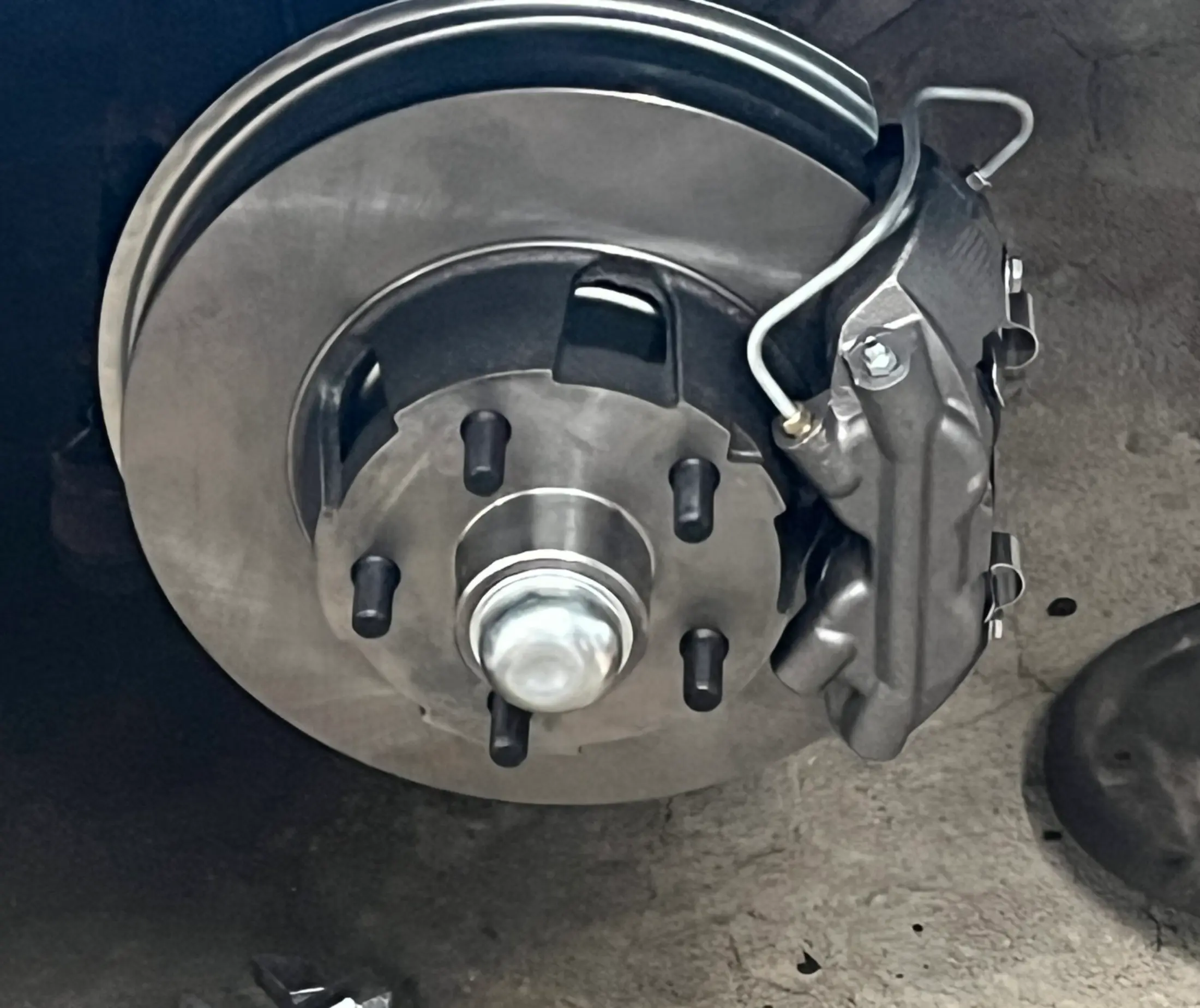

Edit. To clarify , I decided to ditch the front drums and replace with a bolt on kit from chock

Just curious, you speak of front drums but show a pic of a disc brake?
The rubber hoses, from the steel lines to the cylinder/caliper can collapse from the inside.. Good idea to replace..
The rubber line on the rear brake system, from steel line to the "splitter" on the rear end housing, will do this also....
sorry. Should have been more clear. After seeing the condition of things, I decided I would upgrade instead of strictly repair.

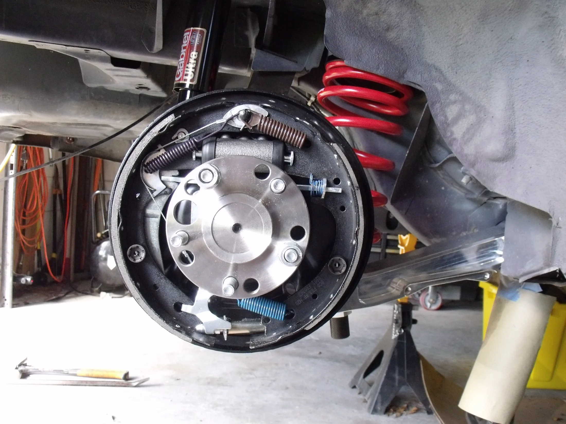

The front discs are completely installed

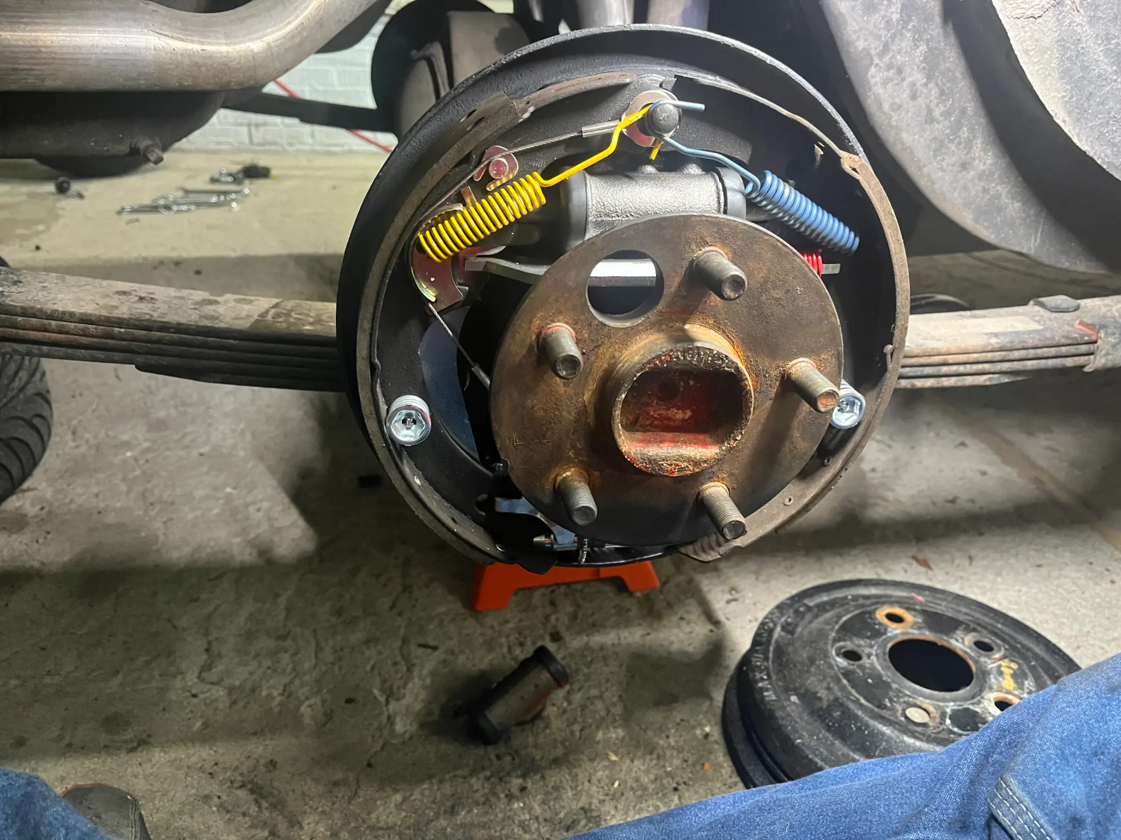

the rear drums are now rebuilt now with the once missing parking brake components.
the rear parking brake cables are installed .
front parking brake cable is attached to the car waiting for the handle to go back in.
all that is left is the parking brake handle , then attaching the 3 cables
bleed the master , bleed the system and test.
Side note. I’ve not worked on drum brakes in maybe 15 years. It’s not any more fun now than it was then.

Everything is now installed. Getting the parking brake cables in place was a blast.
Started the bleeding process . Fronts took fluid quickly without issue, couldn’t get fluid to the rears. Gonna try again tomorrow with a helper.
Hoping it’s just an air bubble and not a clogged or collapsing line.
