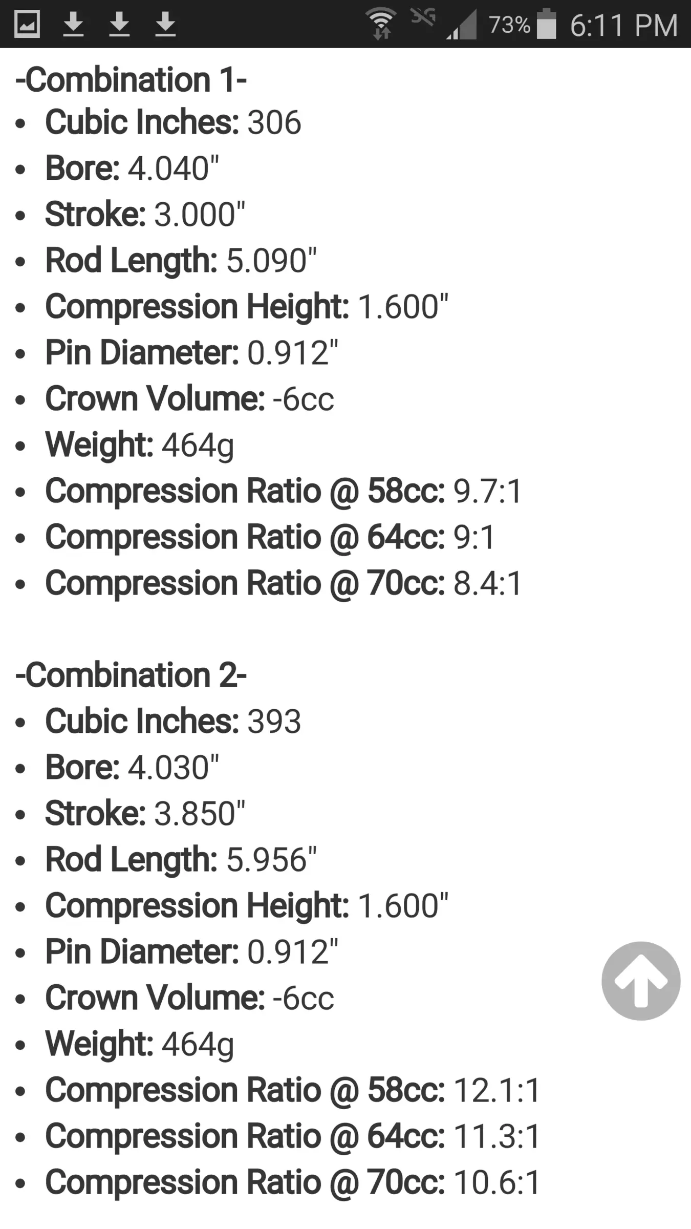

I'm in the proses of building a stroker 351 windsor. Going with the 393 with stroked crank. Stock lenght rods and 302 pistons. Now my problem is I found pistons but can't find if they will work. All info says they do but I'm not sure.
Everything I heard said to use stock spec 302 pistons... I'm no expert. Never built a 393....but a lot of folks will like seeing a thread about it.
