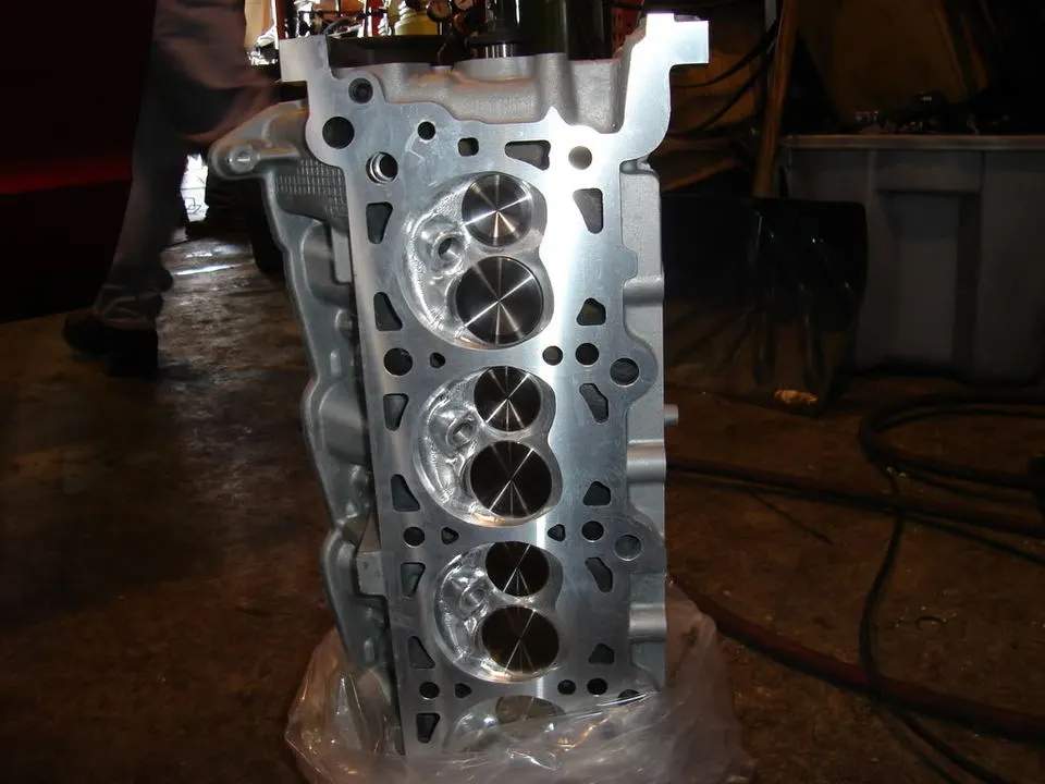

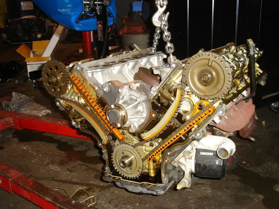

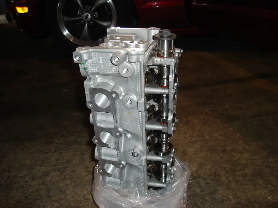

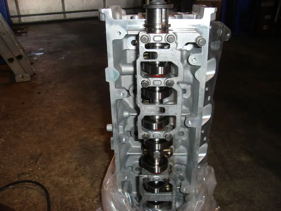

rebuilding the motor as we speak, a couple pics:
head shots
old motor
http://i157.photobucket.com/albums/t53/saleenkid01/Picture061.jpg[/IMG]
big hole where the motor used to be
new block with heads mounted
new ported heads

who's heads and cams did you use? looks good
01saleenkid144
Feb 25, 2006
39
Apr 18, 2007
  • Apr 18, 2007
fox lake stage 2
