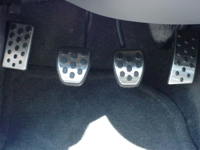

Bullitt pedals are installed, the only real problem was re-installing the accelerator pin, but they look and feel great...will take pic's soon. Thanks for the replies...here are the pic's.

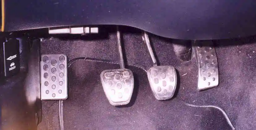

Here's my bullit pedals...I'm ashamed to post this pic cause my interior was dirty :shrug:
