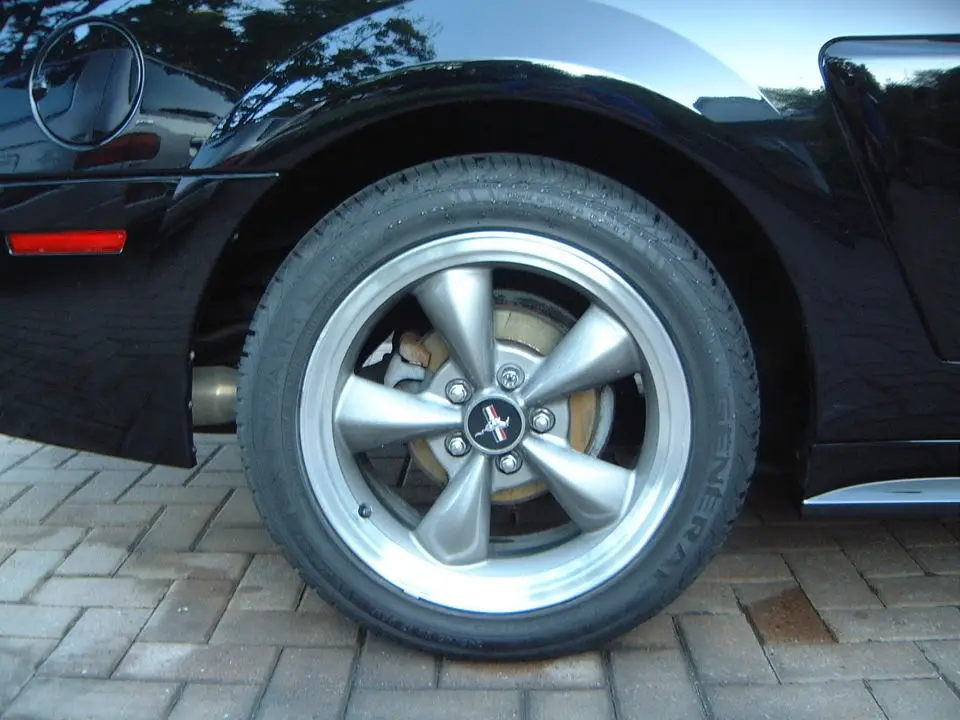

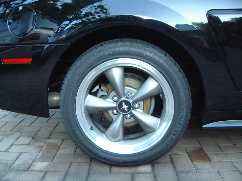

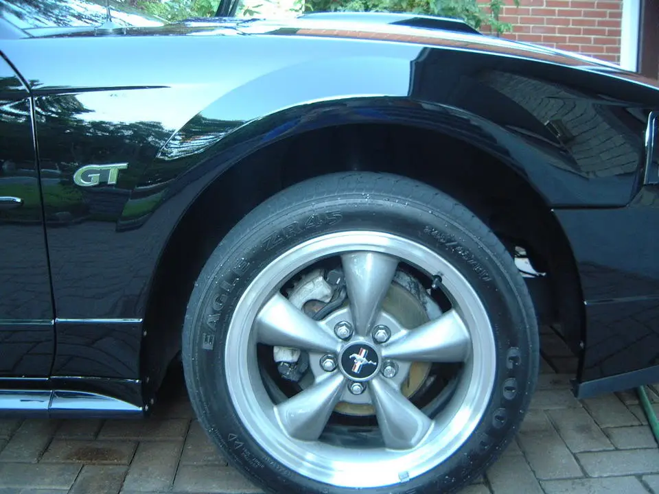

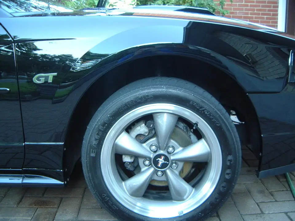

Here are pictures 4 days after the install
The front is SO high
Rear looks ok
So where did I go wrong?
Here's an idea:
(Do this yourself or take it to a suspension shop...)
Support the car such that the weight is on the wheels but that you can get under it (e.g. drive-on hoist.) On the front, loosen the lower control arm nuts & bolts a turn or two and then jounce the suspension a few times. Re-tighten the hardware to spec. (Have both sides loosened at the same time before jouncing the suspension.)
If you like, you can do this at the rear as well if you think it's not sitting right.
One theory is that if the suspension bolts were tightened with the suspension in droop, the bushings may be "wound up" like little torsion bars and might be holding the car up a bit. Loosening the control arms bolts should allow the bushings to free themselves and attain the neutral position...jouncing the car will help ensure this and settle the ride height.
One idea, anyway.
When I did the Bullitt kit on my car, I purposely didn't use the isolators. I got just over 1.5" drop in the front and about an inch in the rear after it settled. People have mixed feeling on using no isolators, but I have had no problems after 40k with none on the car. If you try everything else and are unsatisfied with the amount of drop, I would go that route. Worked for me anyway.
Yeah the front is WAY to high...i know this might be stupid but did you compare the Bullit springs to the stock ones before installing? wondering if the parts #'s were wrong and you got GT's springs that should of been bullit springs... just a thought..
