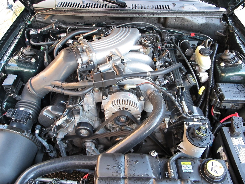

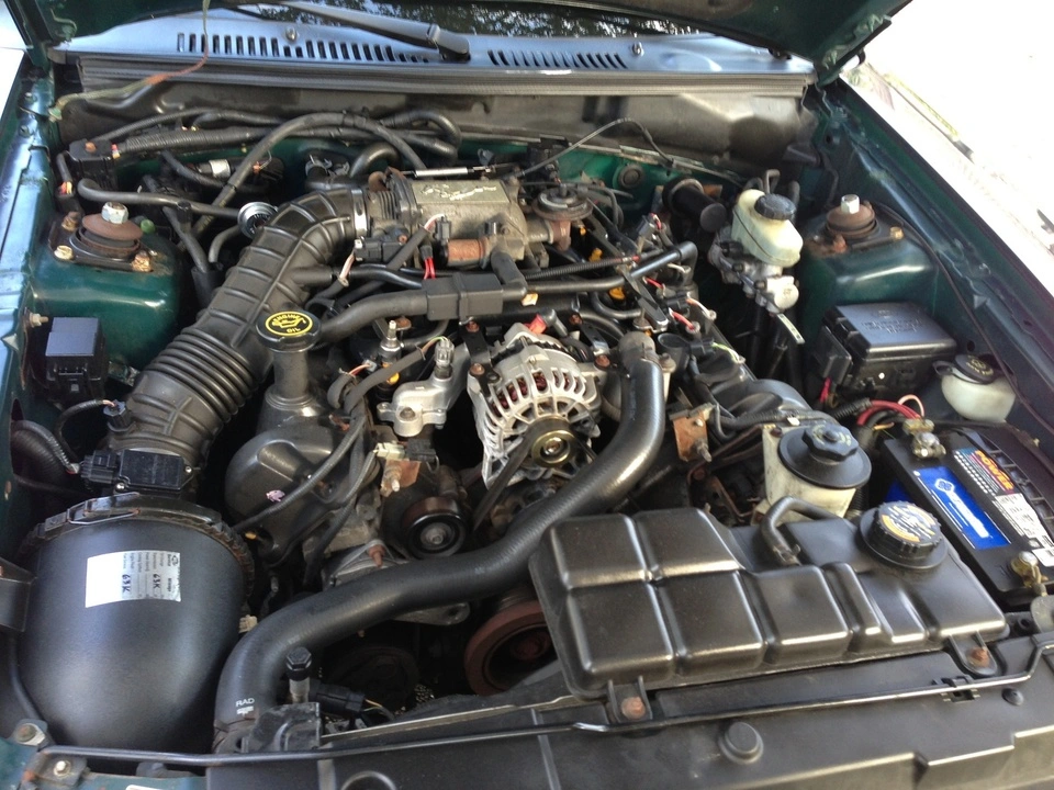

In addition to what's listed above, the engine is different. Most people who create fakes, dont spend the money on the proper intake manifold.
Sticker in this photo. You can see it on the driver's shock tower onthe front. You'll also notice the intake manifold here. This is a bullitt engine bay
This is a standard Mustang GT engine. It's also green, but you can notice the shade is slightly lighter
