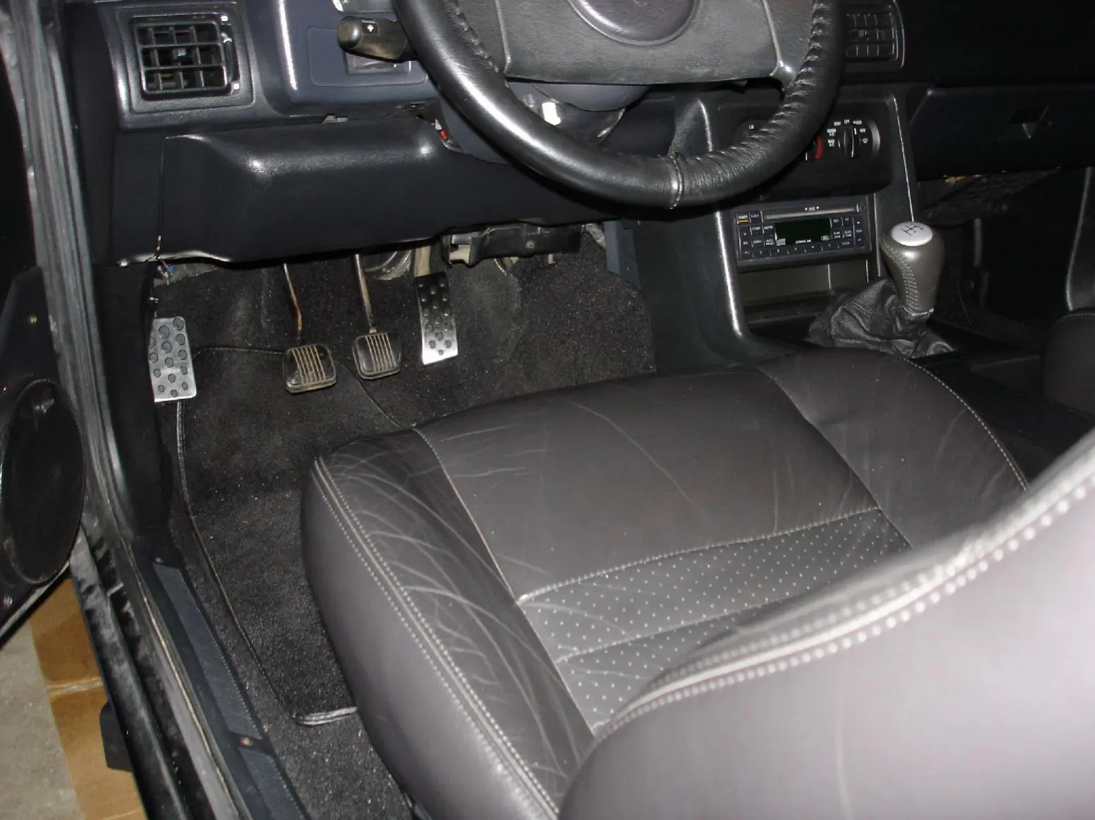

I got the dead pedal and accelerator pedal installed today. Dead pedal easy...gas pedal a little tougher. Seems the sn95 pedal is easier to remove than the fox. You gotta take the pedal out. A little tricky, but once out, just drive the pin out and swap the pedals.
Gotta tackle the brake and clutch another time. I think the brake pedal can go on without trimming.
I trimmed my brake pedal a little bit, it's still very tight on there with absolutely not slip. If you have a tough time getting it on, just cut it. You shouldn't have anything to worry about. Driving the pin out of the stock accelerator pedal was a big pain in the neck, that's for sure.

I'm fairly confident the brake pedal will go on without cutting anything. Just need some soapy water and a tool. I need a hooked tool so I can reach behind the metal pedal and grab the rubber. Will have to see what I have at work. I figure the less trimming I do in general, the better the pads will stay. I don't want to have to use epoxy to hold them on as some do with the clutch.
Clutch pedal will need a corner trimmed. I just want to do it as little as possible. I'll save this one for last.
