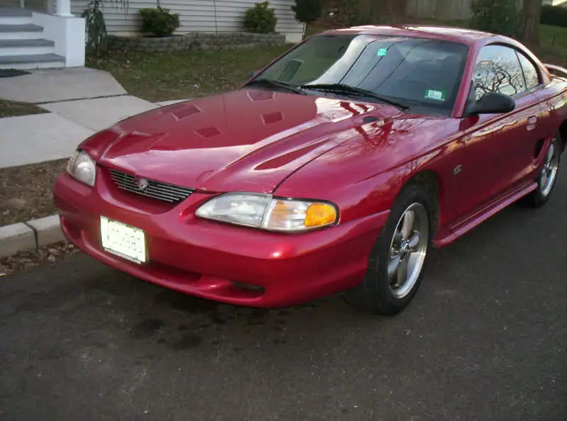

autumn_again New Member Oct 2, 2007 356 0 0 Hamilton, NJ Jan 10, 2008 #2 Jan 10, 2008 #2 it'll rub on the front tires when turning all the way, but they'll fit. i have them on my car, they are from an 06 mustang, on a 94. they fit kinda funny. theres a picture you can see how they look Attachments 2.webp 35.3 KB · Views: 92
