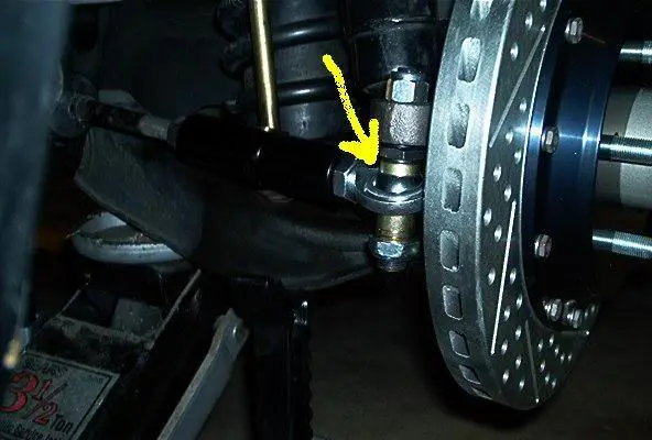

Yes there are spacers on the kit, but the actual link between the spindle and tie rod is a sperical rod end. I'd link you directly to the steeda photo but their website doesn't allow it. http://www.steeda.com/

Steeda
MaximumMotorsports
Part #: MMTR-2
Manufacturer: Maximum Motorsports
MM said:
Bumpsteer is a term for the situation where the front toe changes as the suspension moves up and down. If the toe changes more than a very small amount it will cause the car to change direction, making the car unstable and unpredictable. MM offers two types of Adjustable Tie-Rod Ends. The tapered stud type can be used to make moderate changes to the geometry. It is best suited for use with a stock K-member, and does not require any modification to the spindle. The bolt-through spindle type has a much wider range of adjustment. It is required for most situations when installing a MM K-Member and requires drilling out the tapered hole in the spindle to accept a 5/8" bolt.
The installation of any adjustable tie-rod end requires that your car be measured for bumpsteer. This can be done by following our copyrighted step-by-step instructions. Look at our MMT-4 Bumpsteer kit for all that you need to be able to measure and adjust the bumpsteer on your car.

I have a set of BAER's on my 89. I didn't get it aligned I just made it level at resting height. It definately is night and day on michigan roads. I just ordered a set of MM for my dads car and they seemed pretty adament about getting it professionally done. If there was a place nearby I would probably do that.
