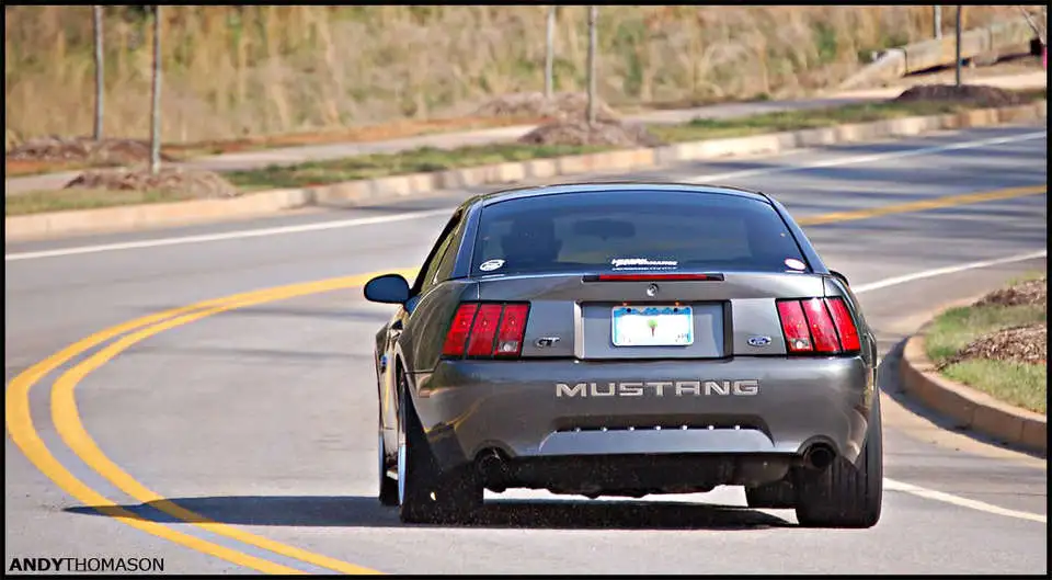

oh and here is my car running about 60-70 thru a turn here in town...

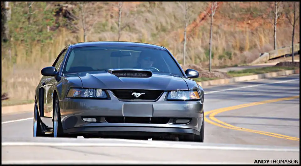

and coming back a little straiter at about 50
