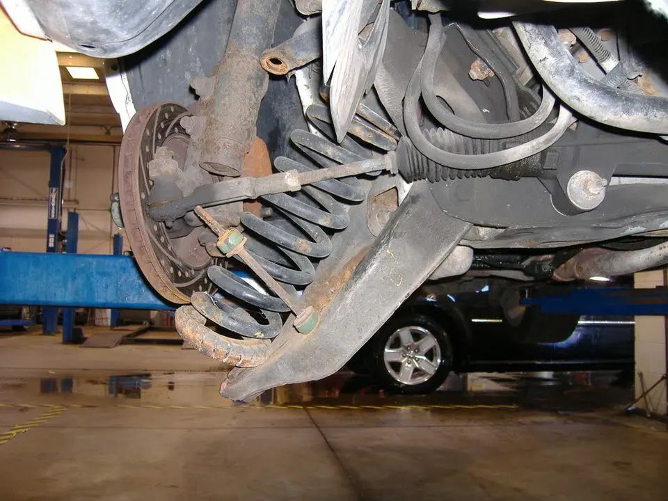

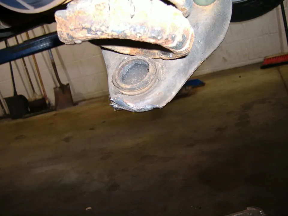

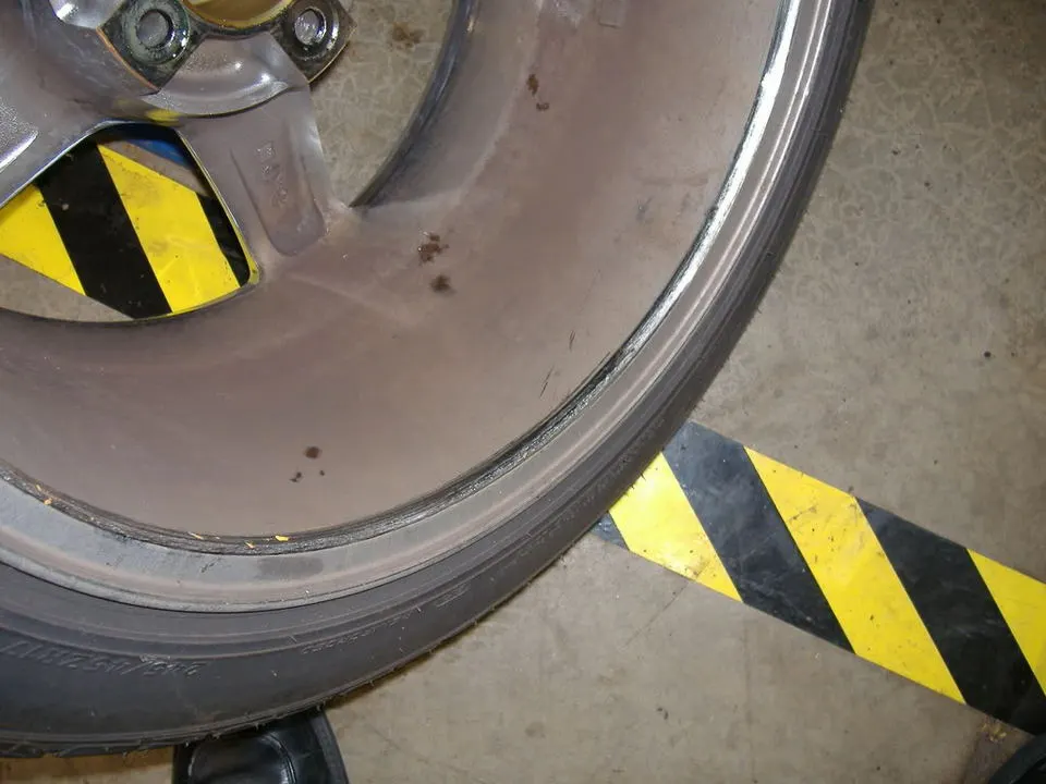

Well people I haven't had a chance to survey the damage but Friday night my balljoint/control arm broke on me. LUCKILY.... it didn't happen 20 minutes earlier when I was rippin' on it. I managed to make it to my parking lot before it got too bad but she was def. grinding. I managed to stick my hand in and feel the wheel and it didn't feel too bad, again... LUCKILY.
I'm wondering though, what else should I do when I replaced the control arms (w/balljoints)? I still need to look for damage to make sure nothing crazy happened but it didn't go very far after the grinding started. There's still a lot of dust all over everything so we'll see.
1992 GT with 245/45/17... will a 1.5 in drop be too much? I was getting a little rubbing on TIGHT turns. But, I wonder if new control arms and bushings and everything will make a difference in that?

I had the same thing happen to my fox 2 summers ago. The ball-joint pulled right out of the knuckle cuz it was worn so badly. It is possible to only replace the balljoints if you're on a budget. The best thing to do though would be to grab yourself some aftermarket arms while you're at it. They wont cost that much more than just the balljoints, and they'll improve handling/turning radius. I also opted to upgrade to 95+ spindles/brakes and 5-lug while I was at it since they require a shorter ball-joint, and I didnt want to change the balljoints twice... although you could just shim the fox balljoints if youre going to go 5-lug in the future.
