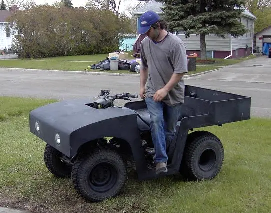

a good way to get alot of practice is to make something like this.
lost of welding here about 20 hrs worth
