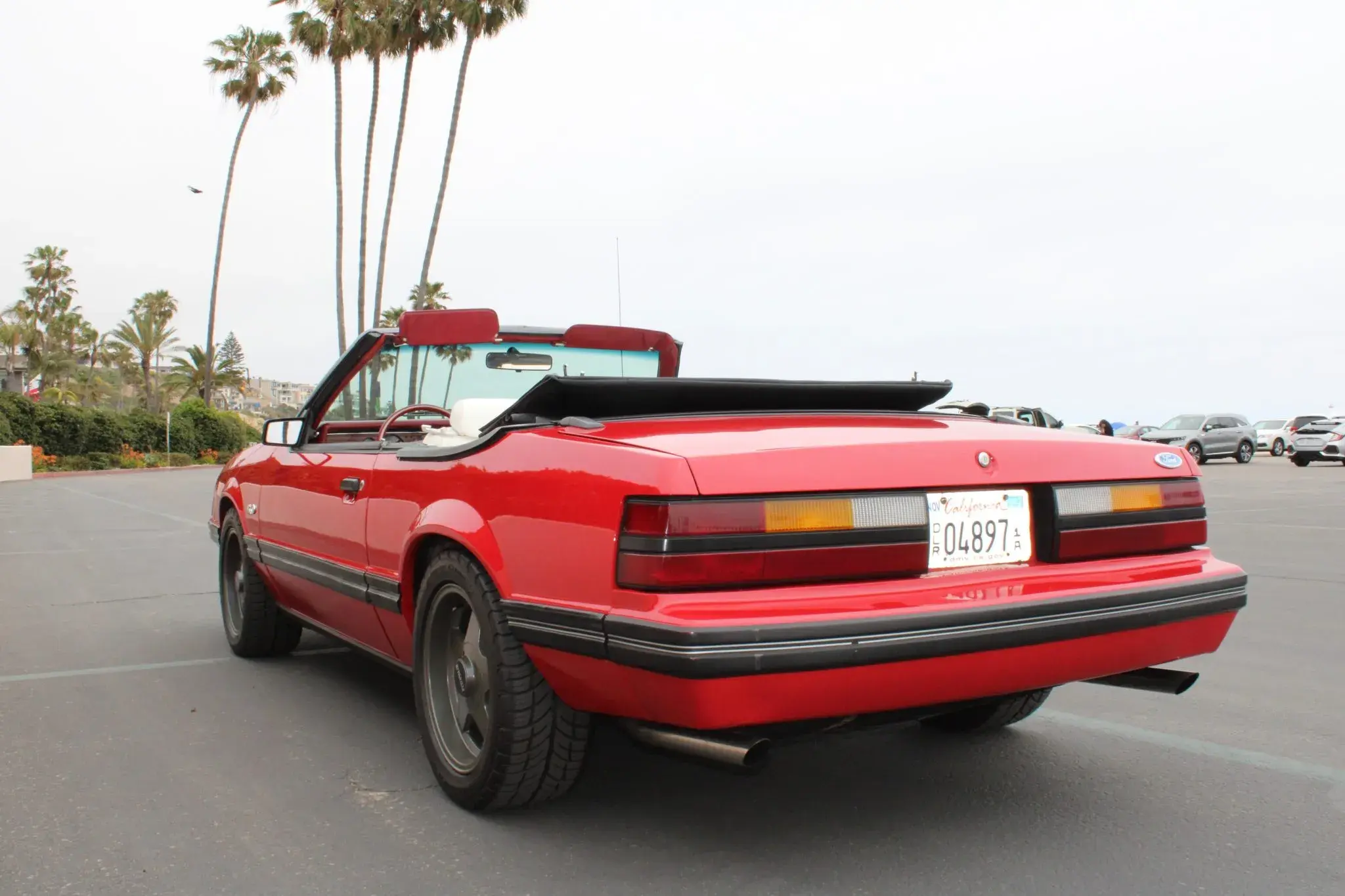

Maybe i'm confused, the pic on page 2 with the tail pipes turning downwards, those are your new tail pipes or your old ones? If they are the old ones, disregard my comment.
If they aren't, that's how an 87-93 gt is done because you can't see them.
An LX gets lx tailpipes which are visible from the sides of the car. Best looking tailpipe setup in history as far as i'm concerned.

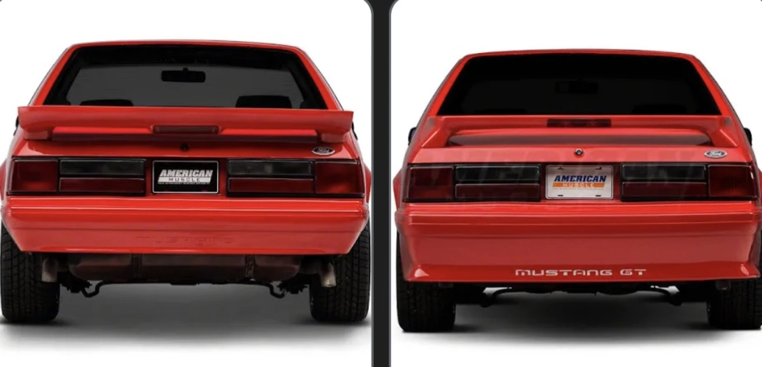

@limp he is talking about looking like this vs what you have:

I like the turn downs but I kinda buck the majority sometimes, I think it's the old skool in me.
Only issue I can predict would be they hang a little low and look awkward, my have to tuck them up a little but than may entail shortening the vertical pipe behind the rear axle.
I also think the turn downs sound different than the straight LX pipes. More deep? Maybe because they bounce the sound waves off the ground. :shrug: Blame it on the coffee :p
Rear bumper cover on a GT blends into the ground effects so it does hang lower. LX on left (oddly enough with turn downs) and Gat on right. You can see why some may feel they are too visible with an LX bumper.
Reactions: limp and 2000xp8
While the lx photoshop pic above is a concern, i would be less concerned about the turn down (the turn down portion is preference) and more concerned that there is going to be 30 inches of exposed bare steel or aluminized exhaust pipe that was never meant to be seen in the profile view. Which is why lx exhaust pipes are chrome or polished.

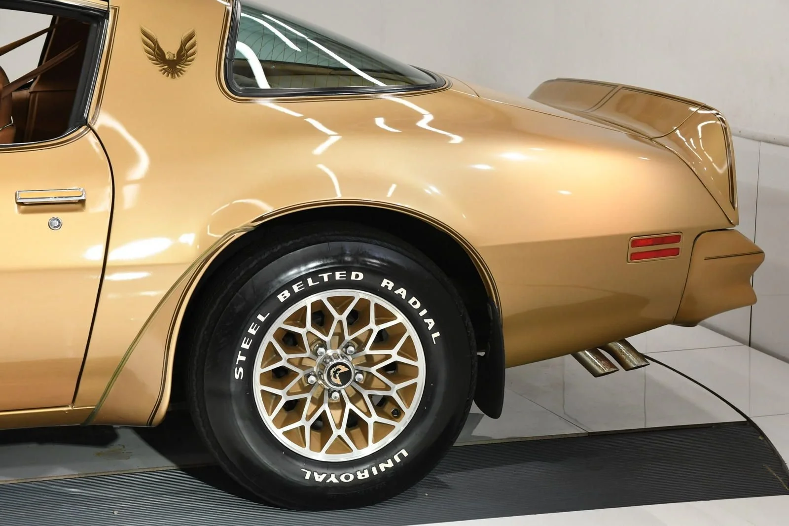

I also really like the split duals on the late '70's Trans Am's.
I am old enough to remember when those were new...
I wasn't a fan of those exhausts but I hadn't forgiven Pontiac ( and the Chevy Z28 ) for ruining the front end on these cars in 74.....

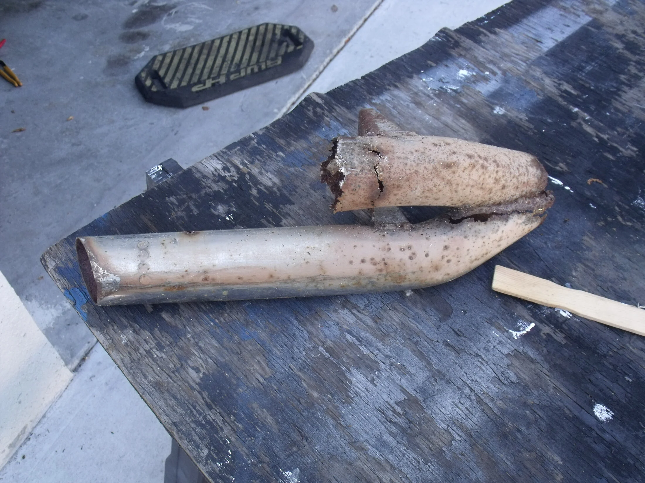

Here is a pic of the stock exhaust tip that came on my single exhaust 83... You can see its no good, 1/2 of it is rusted gone... The single exhaust converged to this dual exhaust tip that came out under the bumper on the drivers side...
