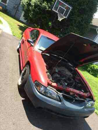

Im buying a 95 cobra either tomorrow or wensday. It needs the harmonic balancer replaced and a 2nd gear syncro and its got around 161, xxx miles. Thats all I know of based off of the craigslist ad. Is there anything else I should look for its my first mustang.
I included a pic of it too.

Pull the dipstick out and look for any shiny specs. Inspect the crank snout and front of block for signs of damage. See if you can bump the motor over to see if it will turn- don't start it. Pull the cap off the radiator and oil and look to see if there is cross contamination. For 1300 you could part that out and make money . Be prepared though to have to tear down the motor.
At that price, it's a steel, grab it. The Cobras go for $8k in good condition. Advance Auto rents a whole kit to do the balancer. It's not that hard. Not sure of your level of experience with transmissions, so I can't comment there. At that price you could buy a whole new transmission and it would still be a good deal. I have a Cobra T5 apart on the bench right now. It had a bunch of busted parts. I got $700 of parts used out of a 2001 V6 transmission for $160 on ebay. If it's just a broken blocker ring, those are $22/each on allstategear.com.

Different color front bumper.
and the radiator cover is missing.
make sure it wasnt wrecked.
look it over well.
Clean title?
Check the VIN, make sure its really a cobra.

+1 on checking the vin to be sure it's a real Cobra. Too many people use that term loosely when they simply bolt on a couple Cobra parts on a GT.
If I get it I plan on fixing it up and keeping it. He said all the numbers match ill check when I get there. Where can I go online to get the numbers to make sure its a real cobra
