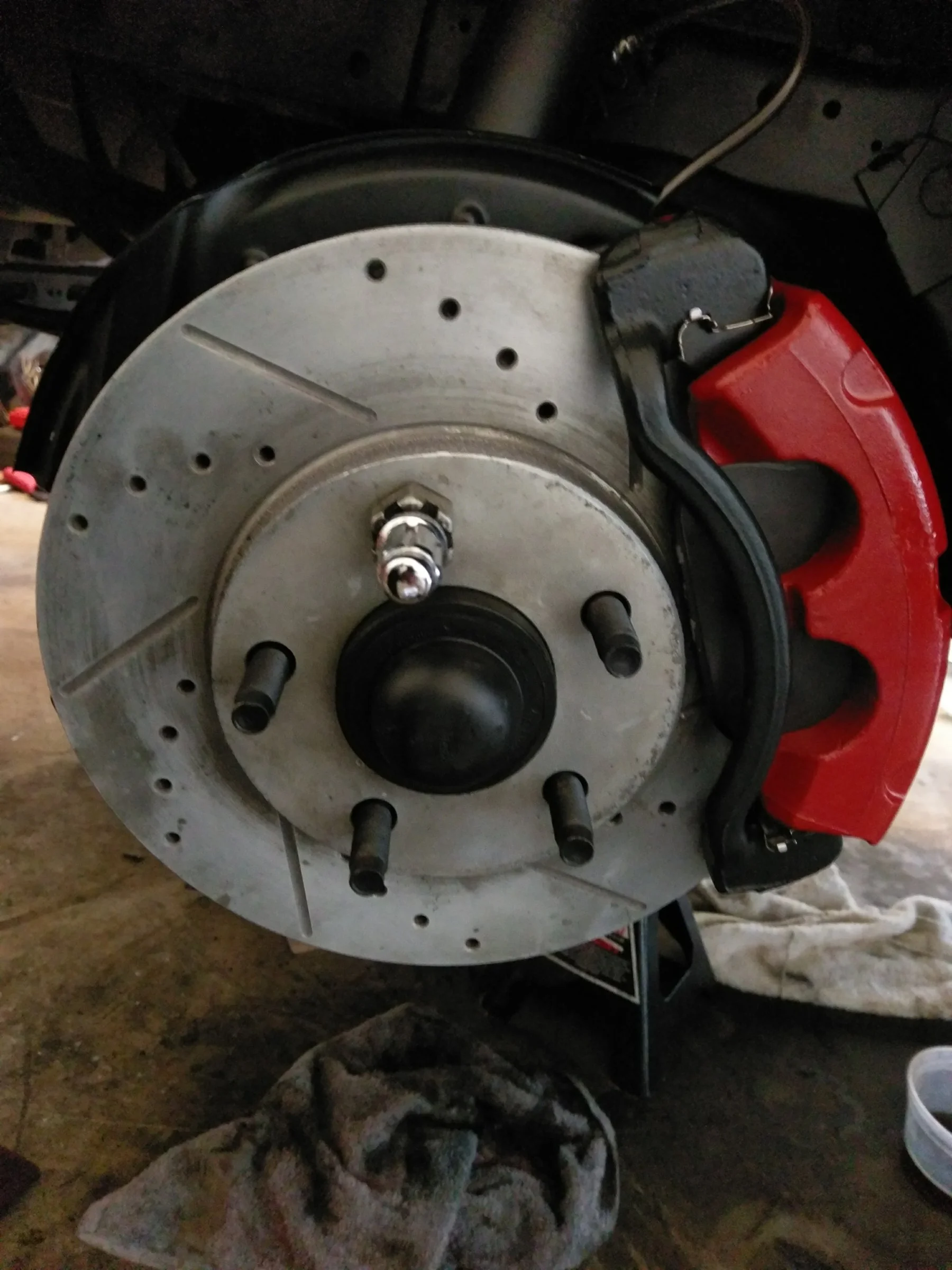

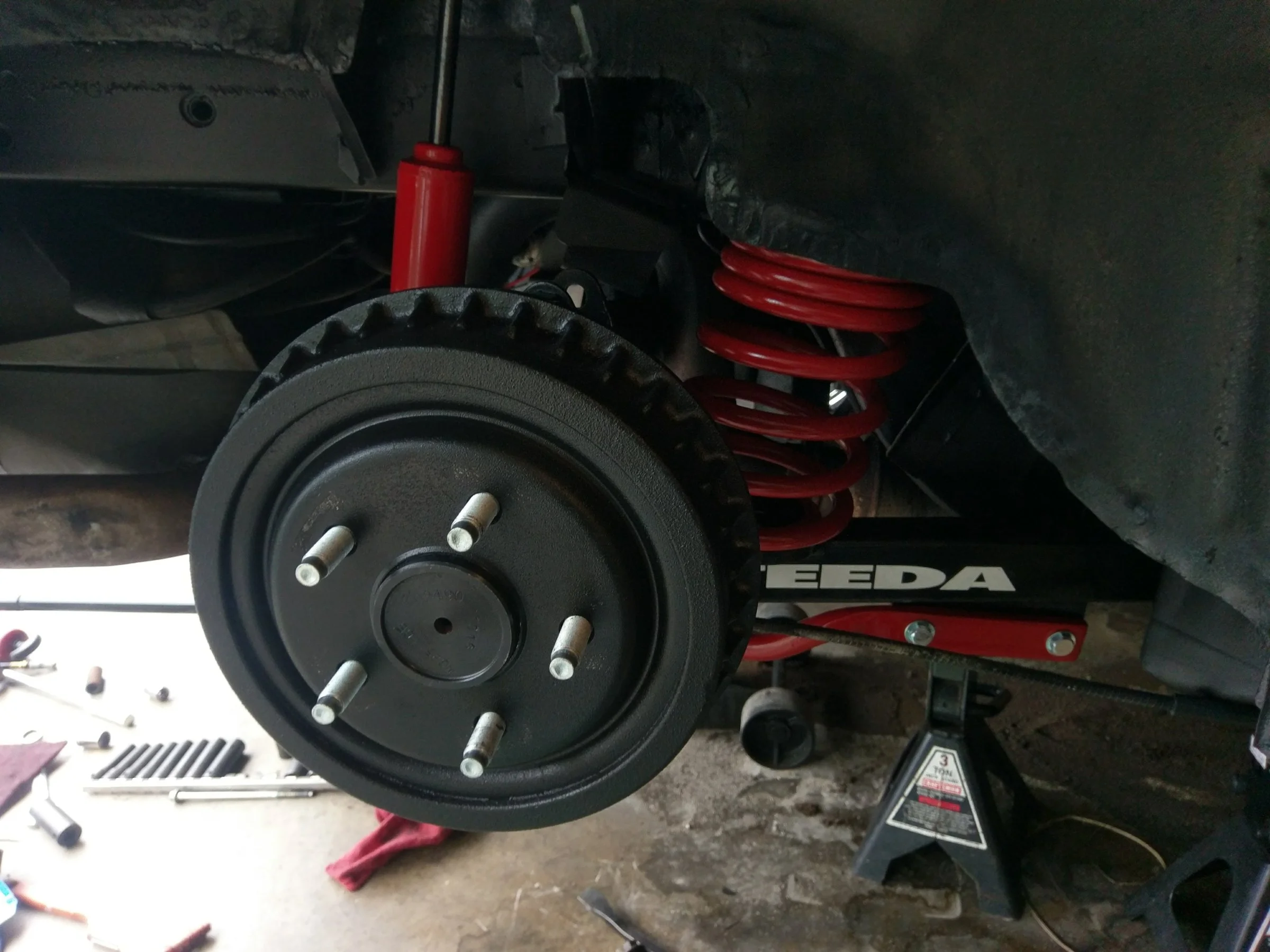

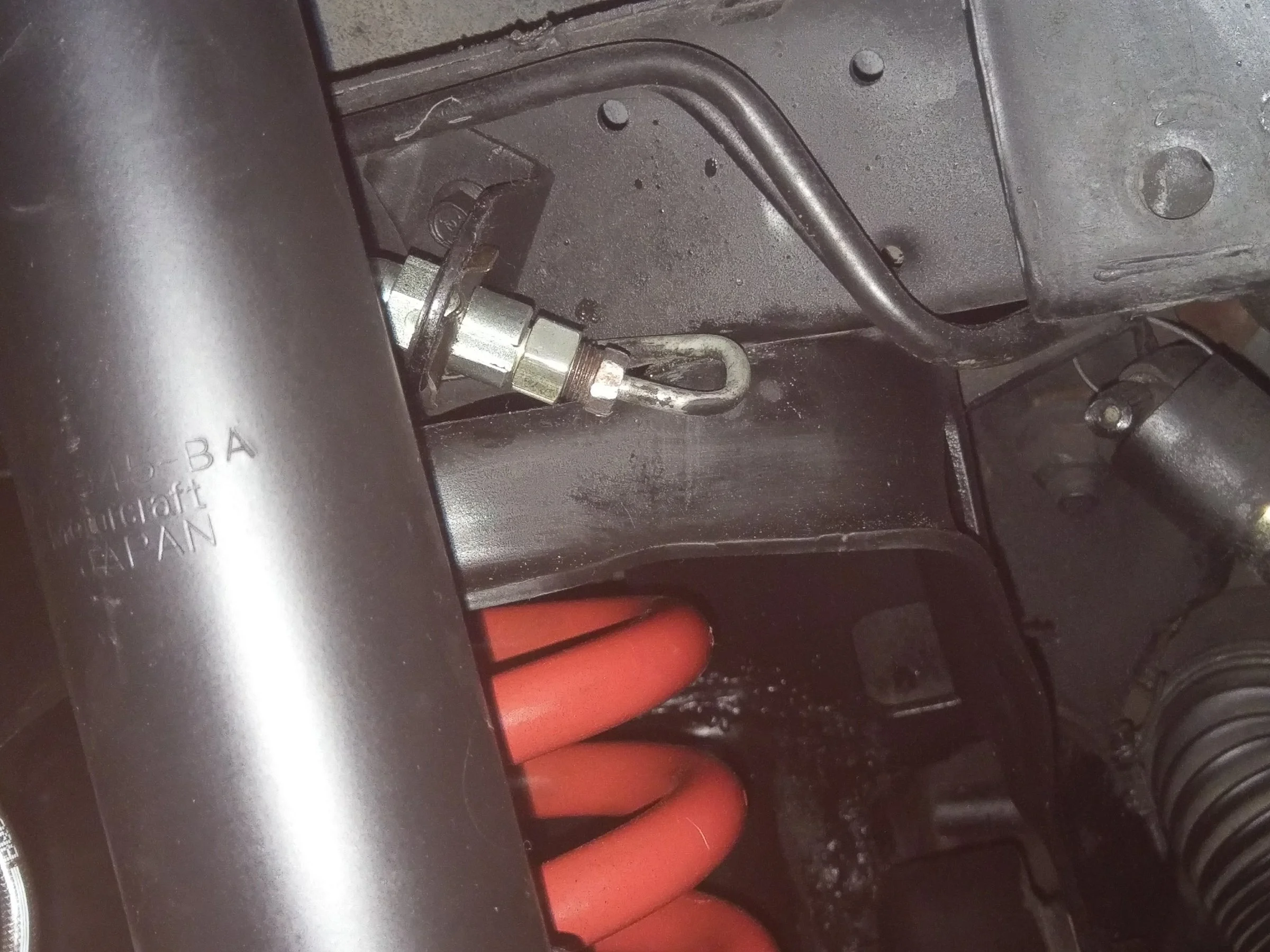

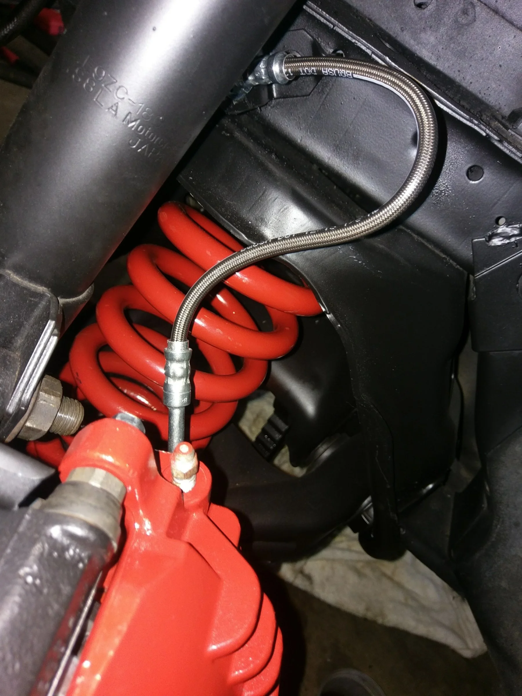

I just did mine a few months ago. As far as the rear axles, just make sure the splines on the axles look good, and arent deformed, broken, etc. On the front, check the spindle bearing for binding, and "play". The hub should turn with little resistance, and feel smooth. You'll need a brake line adapter on the drivers side, because the 95 uses a different size fitting. This adaptor can be found on LMR for like $5. Overall easy to do. While your there, you might want to check your ball joints. I replaced mine when I did the spindles. Here's a few pictures. Hope this helps!

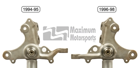

know that you want 94-95 front spindles as 96-98 alter the front end geometry
I picked up some 96-98 front spindles. I have 95s on my car now. Putting the 96+ front spindles on might give my front tires the extra clearance I need to avoid scrubbing the inner fenders. However, I don't know if that will throw off my bracketry and require other parts that I don't have. Any ideas?
Remember, the front wheels turn in an arc. The further you push the wheel out from the center pivot point, the larger the arc becomes.
So the 96+ spindles could actually make your run worse as the wheel moves further forward and aft

Oh man. Today is not my day. So, I have 96+ straight arm ones on the car and thw curved armed ones that I picked up are 94-95s. So, maybe they will relieve the scrubbing issue after all.
Reactions: WinnipegFox
Ok, now I've been straightened out on the years, the ones on my car (96+) are indeed further out and swapping to the 95s might get rid of my scrubbing issue. That said @Mustang5L5, I'm aware some grinding might be necessary, but is this just a straight forward remove/replace, or is it going to require other parts, given that everything is already set up on my 96+ setup?
You only need to grind if running the 99-04 GT/V6 dual piston calipers. Just need to clearance for the Pistons slightly.
After that it's a direct swap. Dust shields are the same. Hubs are the same. Just might need to check alignment
