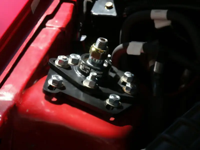

maximum motorsports has the best plates you can get. and they tell you exactly where to put the alignment specs for the car.
http://www.maximummotorsports.com/

the problem is you used crappy 3-bolt plates...
get Maximum Motorsports 4-bolts...

Maximum Motorsport Caster/Camber plates hands down if you can't get it into spec camber. I love them.

got a link to a good spot to by some M&M C/C plates? Do i HAVE to get the 4 bolts? Dont feel like drilling throught the strut tower...

they only come in 4 bolt.
a cheap alternative would to be installing an 18MM cam bolt in place of one of your strut bolts. they are like $20 for a pair and will give you about 1.5 degrees more movement.

Why? They show you exactly where to drill and it's not difficult at all - don't skimp on suspension parts bro!

The M/M plates have the provision for the 4th bolt but can be installed with only three.
