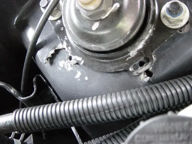

You can always add the c/c plates in the future, if you find that you need or want them. The stock plates have a rivet to hold things in place. Drill it out before you take it in for an alignment to give your alignment tech the most adjustment available.

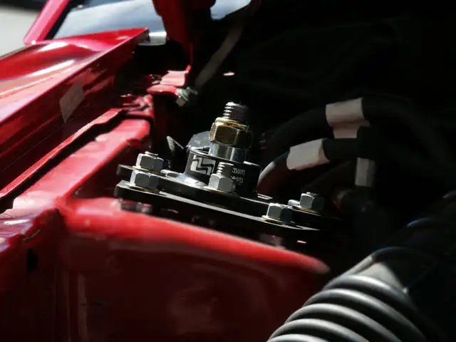

FWIW, I have Steeda springs but I put Maximum Motorsports c/c plates in just because I wanted adjustability, not because I expected they would be needed.
HTH,
Chris
You can get that adjustment with your stock C/C plates but... don't mess them up...
Above... not mine btw...
Below... mine...
if you have the money, get some MM C/C plates...

Curious, your sig says H&R SuperSports, but I see only one large spacer on the topside of your strut...shouldn't you have more? (I know the MM instructions, while very specific, are sometimes left to the interpretation of the installer).
I had Mach 1 springs (with 3/4 of a coil cut) on my 2002 GT and had two large spacers and one small one on the top. This is exactly what the (current) MM instructions tell you to use with a dropped ride height. (I believe these instructions have been updated however - I recall encountering some different verbiage when I installed mine)
On my current ride, the 04 Mach, I have Eibach Pro springs, and I have one large and one small spacer up top. This is the way I bought the car.

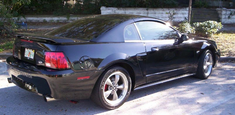

Old pics of the stock rear height.

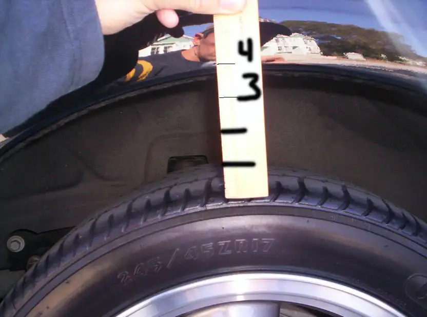

And the day I changed to Steeda's. They will settle a little lower after you install them.

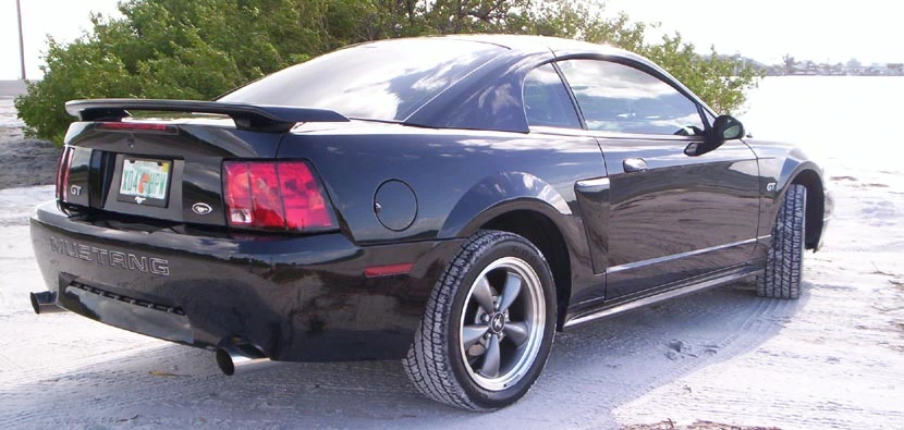

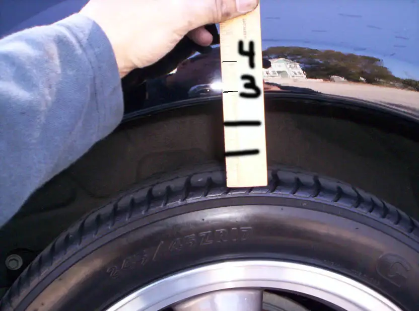

Before.
After everything settled.
