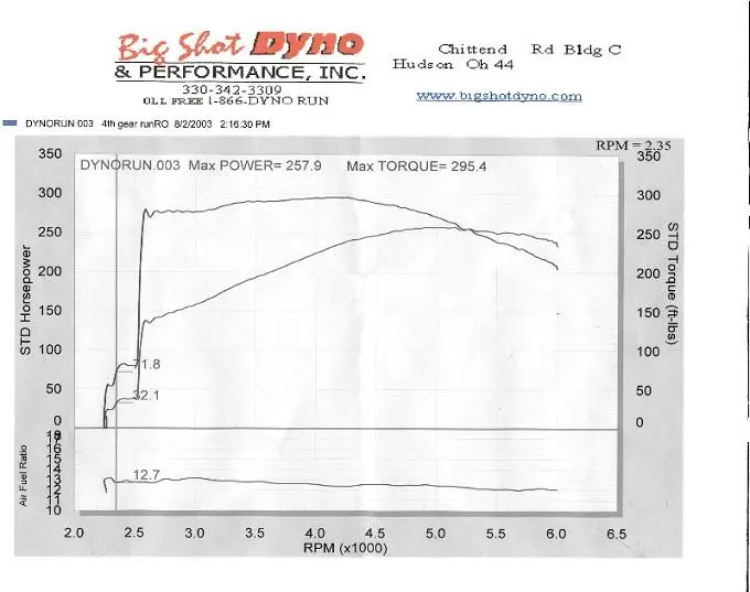

I am really confused and frustrated. Back in December I had Flowmaster Amer Thdr catback, FRPP 3.73, Pro 5.0 shifter and Superchip SCT installed by a local Mustang Only speed shop. I feel like I paid way too much for the chip and dyno tune ($627.00 total for the chip, install, & dyno time/tune) and the results, to me, were not that impressive. See dyno sheet below. What concerns me most is what I am hearing, learning, and about what it should be - the A/F ratio.
In February I installed a C&L MAF and Trueflow tube as well as an Accufab 70mm TB and plenum. The car has run perfectly since the install, is very responsive and does not ping at all. But I am learning that the C&L simply leans the A/F out more to make power. I am really worried sick now that the car is running way too lean. I have had absolutely no problems with it. I did leave a msg for my tuner, but he has yet to return my call - nice! Any advice? I am tempted to yank the C&L out and put my OEM MAF back in. My sincere appologies :hail2: to anyone I have offended out there, because I was I defender of the power the C&L MAF made...sure, it makes power...but I don't want to burn a piston or something. :( Any advice is appreciated.

Sorry to say but you simply wasted your money getting that MAF put the stock one back on and find a different tuner your A/F should not cascade like that it should pretty much stay 12.8-13.1 from 2200 to 6000.

As said on modulardepot, you are running too lean. You may want to take off that C&L or get a retune even though the tune will cost you. From looking at your dyno, your tune may also be causing a problem.
here is my dyno.

Yeah, I know, I'm a Mustang forum whore :D . I don't mean to whore around, looking for the answer I want to hear, but rather gathering as much info, experience and support from fellow bolt on gear heads who have had similiar issues. I do see you have a C&L MAF, but a much richer and flat A/F ratio :nice: . As you stated, my tune, which was before adding the C&L MAF, was a possible problem to begin with, which I am aggravating with the C&L MAF. :bang: Still no call back from my tuner since Monday...I think I'll try calling him again right now. Thanks for the advice.

Dyno was done with the newly installed Flowmaster American Thunder Cat-back and new 3.73s installed. Since then, my wife and I, in February, bolted on the C&L 85mm MAF kit with Trueflow Tube and Accufab 70mm TB and plenum.
