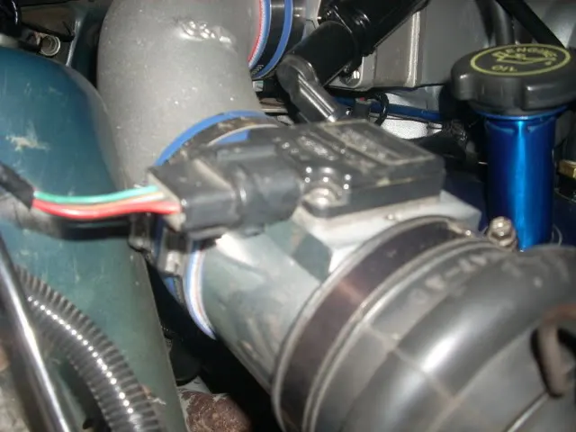

I have the C&L mass air system as well. I like it. It seems to me that the metal inlet doesn't bend or conform like the stock rubber tube when the motor rocks. If you left the mass air brace attached...something has to give. I just got rid of the brace all together. Everything stays together just fine.
Ditch the bracket. This is a MAC housing with the stock sensor. 24 pound calibration
