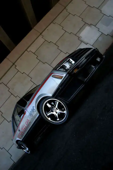

I have the C spings in my car. Its a pretty harsh ride but the car handles very well. I've taken some 90 degree turns at 50-55 mph and the car stayed glued to the road. I like the slight rake the springs give the car, its good to have alittle hight in the back so you can actually put things in the back of the car without bottoming out, thats why I havn't cut the rear springs.
Here's a decent pic that shows off the stance the C springs give.

Stephen, thank you for the input and pic. I also like a little rake (not stinkbug, but a little) especially since the vert rear-end is kinda weak anyhow. Your ride looks droolmazing. :nice:

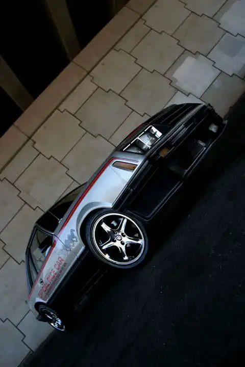

Just found a very old pic of when i had 4-lug and pony wheels. You can see the drop here
If i had to do it again, i'd go H&R springs, but i don't care about drop. They are just good quality springs. Even the B springs might ride better than my C's. They don't handle as well :)
