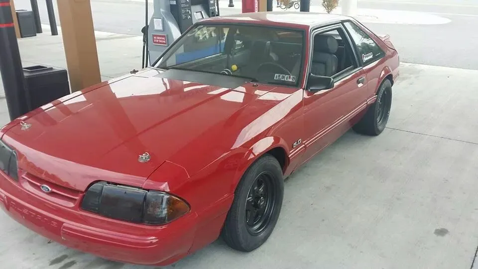

Fuel pump needs replaced shifter cable needs adjusted and a fee other small odds and ends. But she shifts HARD

took it out a bit last night still working on getting it running right on motor again.
but it def feels strong for sure! need to get passenger side O2 bung welded in and extend those wires so i can get it in closed loop
