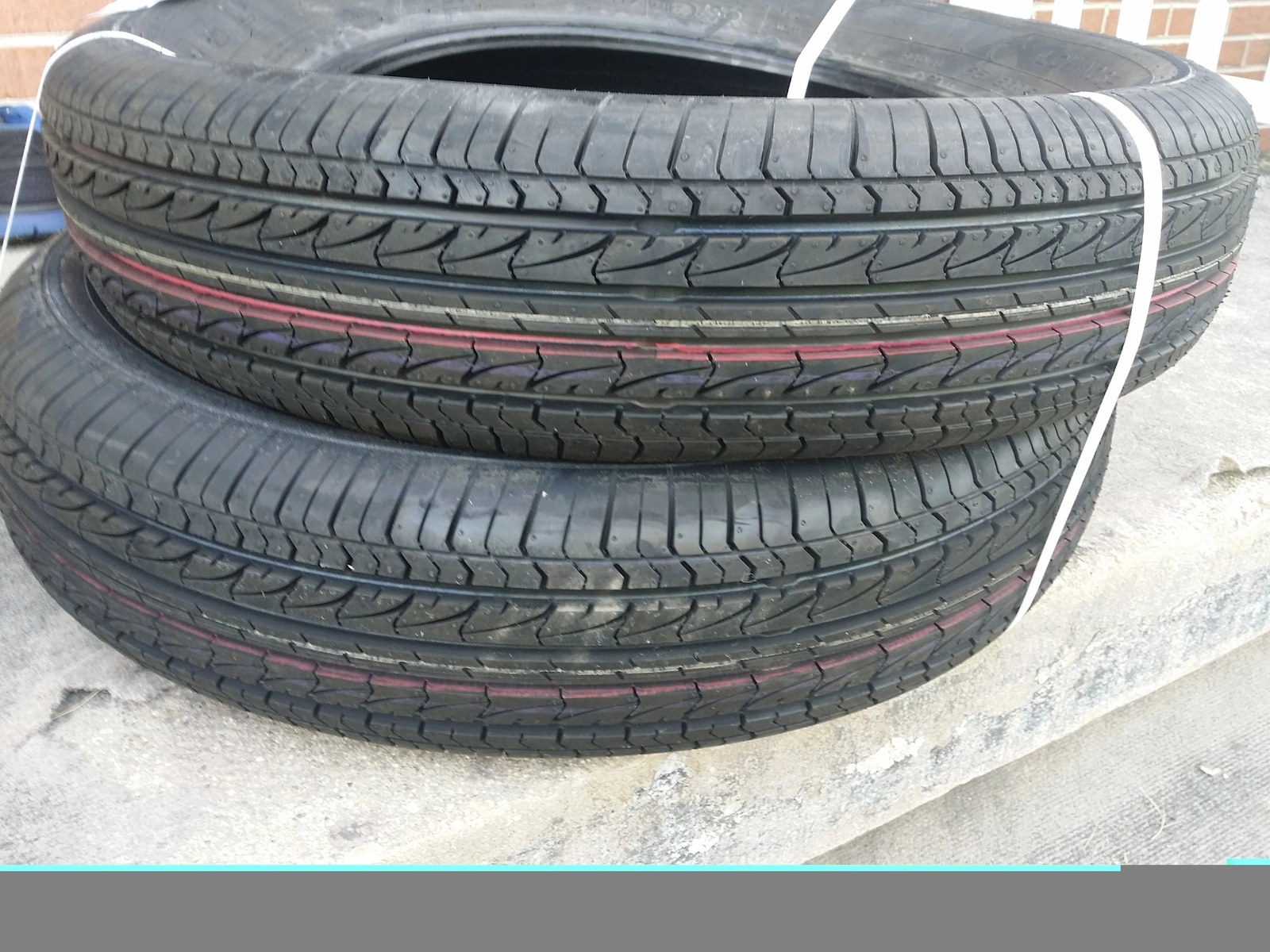

I know you have heard all the horror stories about using those VW tires on a mustang, but it really did happen to a friend of mine. The tire blew out going down the interstate.

Ready to throw her in some corners
