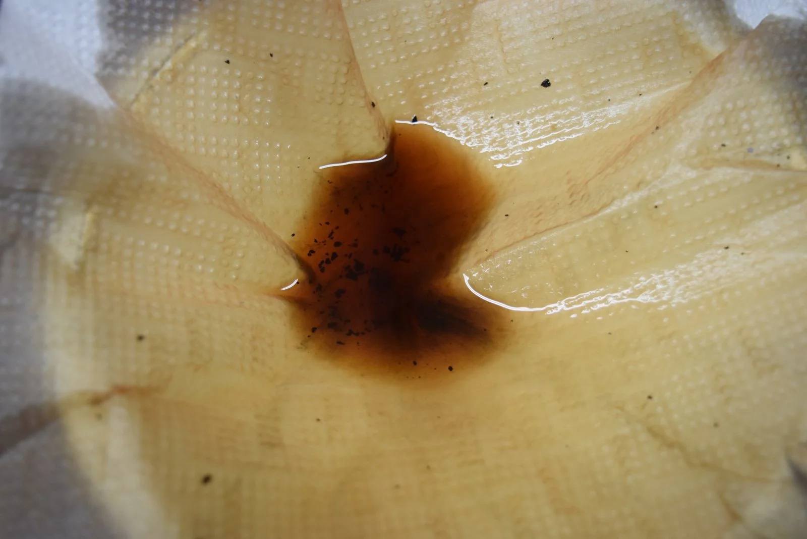

finally, most of the time if the sprag or stator (or, well anything else inside the converter) fails, it will fill the entire transmission, the cooler, lines, quick couplers, basically anything that the fluid touches, with metal particles. Remove the transmission oil pan and then check for metal. If there is any, you're going to want to disassemble and clean the entire transmission. Failure to remove all of the metal (by flushing the cooler, lines, etc) WILL result in repeat failures of components.

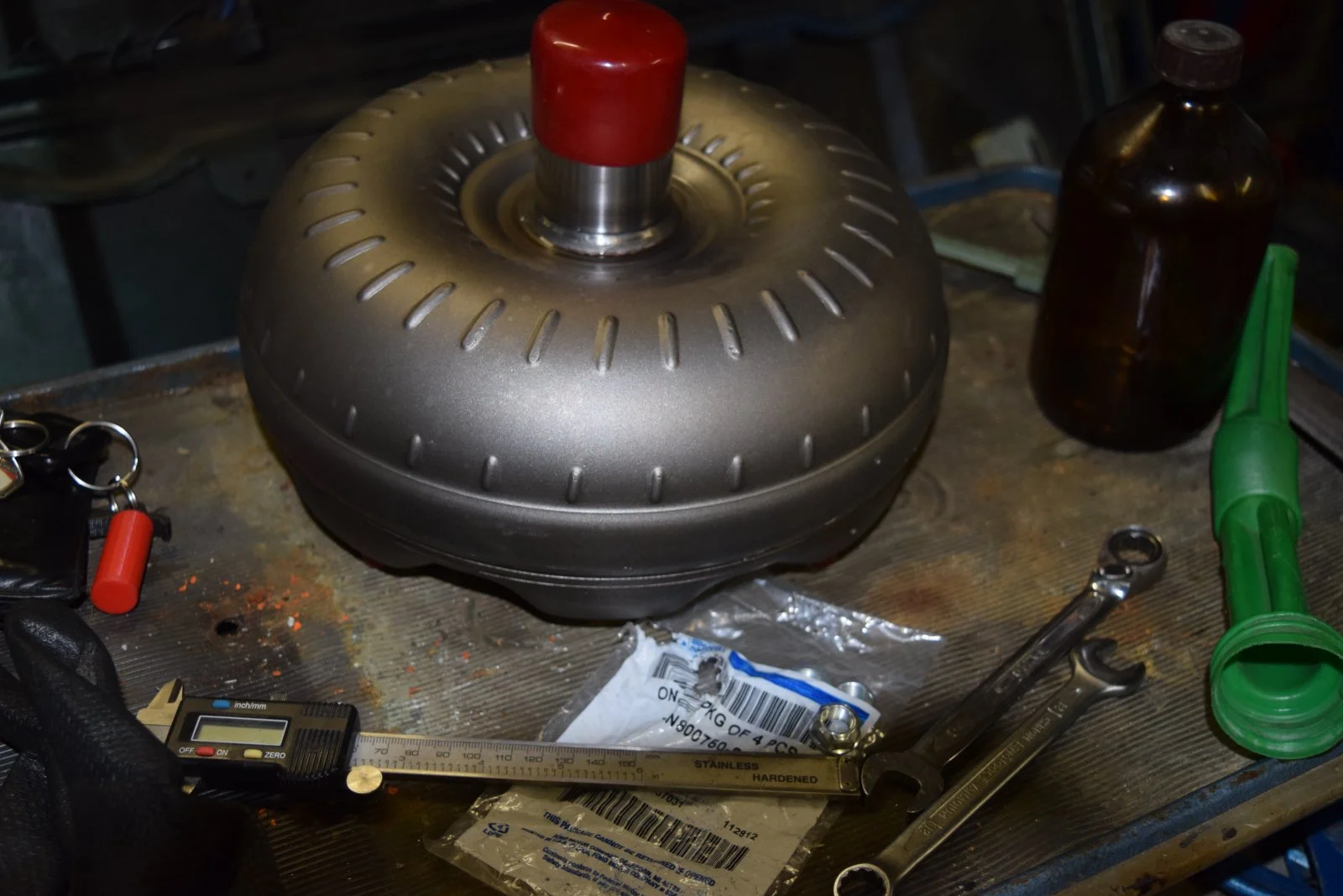

Hi everybody, Last week the overhauled torqueconverter arrived . Because the car has no MTO at this time i took the engine out with the help from a hoist from a friend. I took the oilpan off the trannny and there were no metal parts in there, only a few particles wich were non/magnetic.(brakebeltparts??)
I collected about 7,5 liter of ATF thats 7,8 qts out of tranny and converter. Has anybody an idea how much ATF stays inside the trans??. Otherwise i ran with too less ATF inside. Following the books it should be between 9.5 till 10 qts!!?? I always find it hard to see what the level was on the dipstick. Yes i followed the procedures- oil warm, shifting through all gears and back and then check the dipstick. Anybody some tips how to check better
Now its time to get the engine back in place. Last time i managed to do it on my own. Friday night it failed during two hours on my own. Tonight another shot and asked my friend to help on monday. Expectations are high on the new converter. Although no MTO i planned to do a roadtest end of the week. A fine is a part of the deal/risk.

The 7.5 Llr was in with the torque-converter included.So still missing a few pints.
You can't drain the torque converter completely, even after repeatedly dumping fluid from it and getting it to the point nothing drips out, it will still have a quart or two in it. There will still be fluid trapped in the valvebody and elsewhere in the transmission as well.
