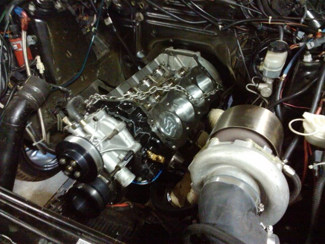

I have one in mine i am also running a turbo with about a 3.5 inch down pipe running right past the trans.hard to see in these pics but its what i got right now.

Zing! Yeah they are heavy but i guess 10.7 isnt bad with a heavy trans maybe i would run a 10.6 with something else.
Try 10.30 0r .40 w/ a c-4 instead.
If all it cost to run a trans that weighs 50 lbs more than it's little brother, with all kinds of extra internal rotational mass churning away was just a tenth, why in the hell isn't everybody doing it?
I guess it could be that much faster I dunno. Like i said before this was already in the car when i got it so im just gonna leave it till it breaks. If it ever does.
