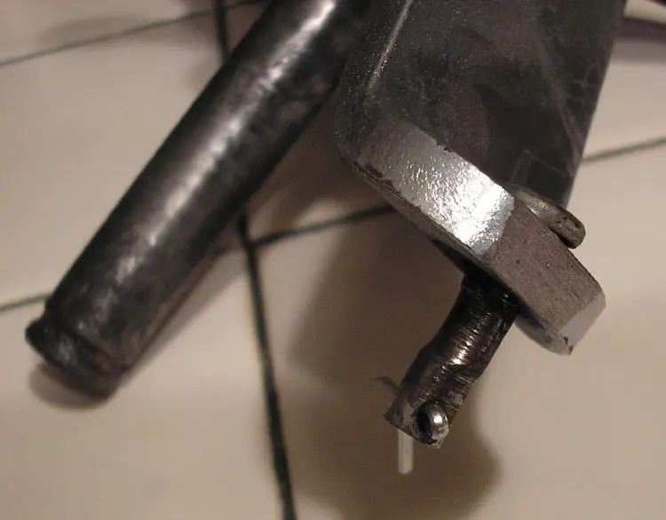

The Modern Driveline unit uses a unit-specific cable that may be hard to source if you somehow damage one. I have seen occurances where the pin that secures the clevis wears out on the Modern Driveline piece, where the Mustang Steve unit doesn't have that problem thanks to the clevis.

I am not dissatisfied with my MD piece, rather, the Mustang Steve piece wasn't availible at all when I bought mine in 2002 or 2003. I am not replacing my Modern piece, but if I had to do it today, I would choose differently.
