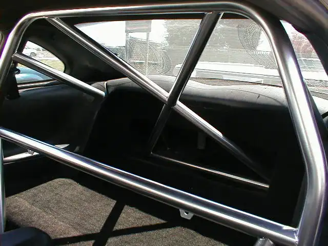

I'm thinking about taking my car out to Rhodes Custom to get mine done. I want mine with a cross brace. Picture below showing what i mean.
