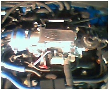

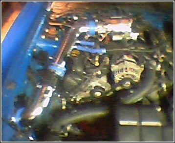

I got them installed but there is this noise, like a whining sound or something... any ideas?!
Heres some pics I took of it.. it wasn't totally done in the pics..

I do see that you have a fenderwell mounted cai. I know that the MAF sensors do not like the 90* bend, but I don't think that it hisses or whines. Spray some carb cleaner around all of the fittings, bolts and hoses and see if it gets sucked in anywhere. Then tighten whatever it is.
While it is running, of course.
I only really hear it when the hood is up, but you don't hear it much with it down.. and when your inside you can hear it a little.. I figured it would make the exhaust sound a little different but it doesn't.. Now I have my gears.. next to order is either my H pipe non catted or my underdrive pulley...

I have a Dragon Plenum and an Accufab Throttle body and was told since the Dragon plenum is dual chambered it will create a whistle sound..my sound only lasts for a few seconds while I am accelerating. Not sure if that is why yours is making the whistle..but its a good chance
