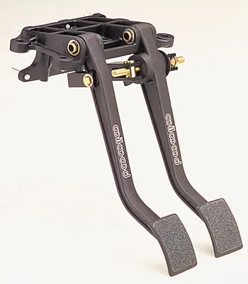

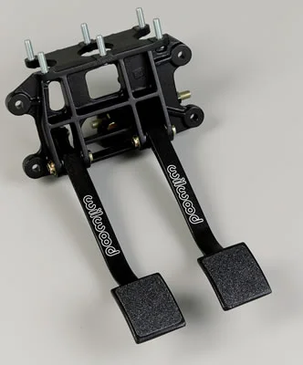

This is what I plan on using in my 70 mustang. The factory pedals are CRAP, IMO. I have had some many problems with the bushings, rods and all the factory crap. So here it is.
Only $197, cheap for a well built part.
http://store.summitracing.com/partdetail.asp?autofilter=1&part=WIL-340-3950&N=700+115&autoview=sku
Where does this mount? Under the steering column?

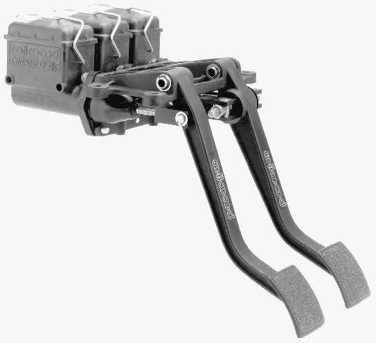

Neat stuff.
On the Summit site, they all say something about they are to be used with Wildwood brake systems, but I guess linkage can be adapted to anything...
There are several styles too, not just the one in the previous pic.
This one has enough holes forward to look like it could totally bypass any involvement with the pedal support...
Just bolt it to the firewall.

Looks like a cool setup, but will those Wildwood masters work stock stuff, or do you have to convert to Wildwood discs on the wheels too?
Another thing, all of the Wildwood kits I have seen are listed for either lightweight cars or racing use only. So I would question the ability of the masters to safely/reliably operate long term with the stock calipers and such. Am I wrong?
Here are the mounting instructions I found. I also plan on using their master cylnders for brakes and the clutch. I have not measured yet but I think they will fit.
