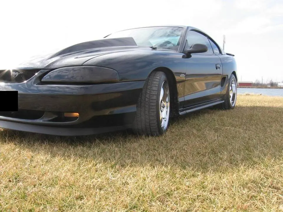

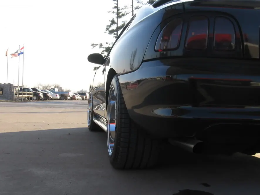

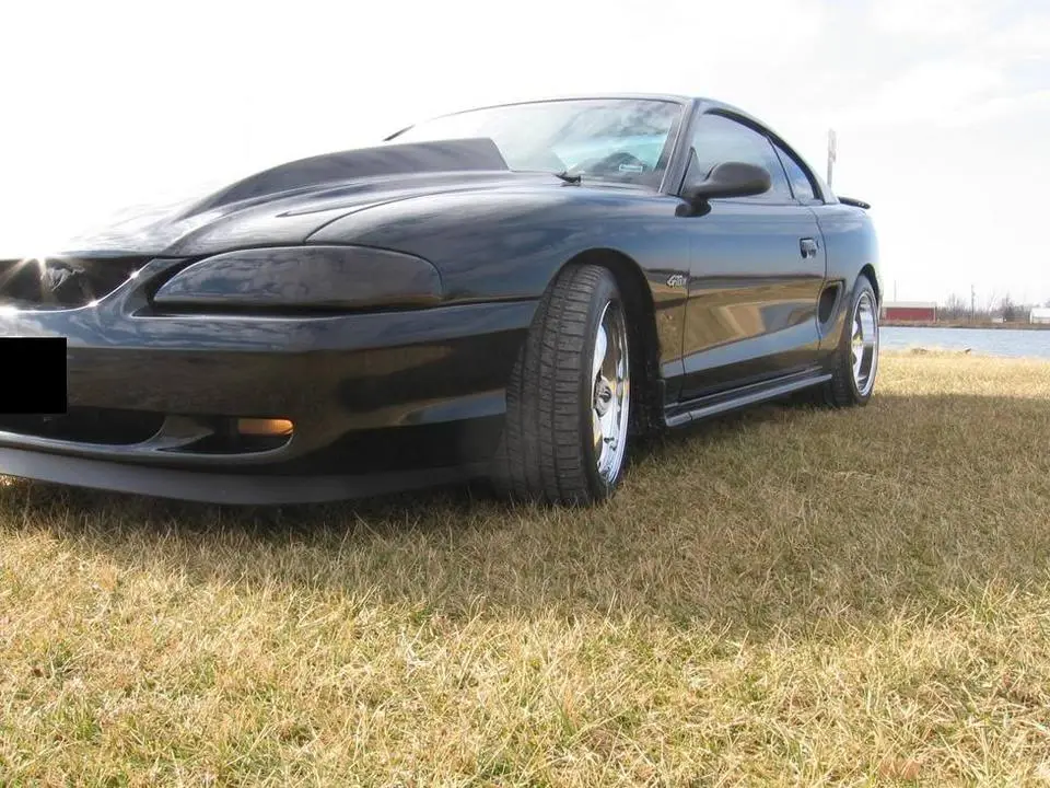

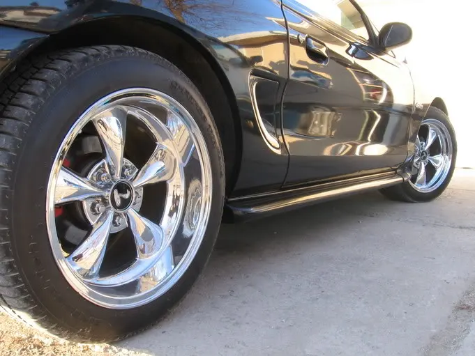

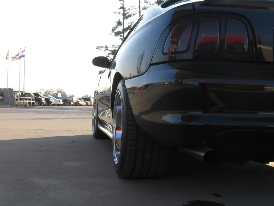

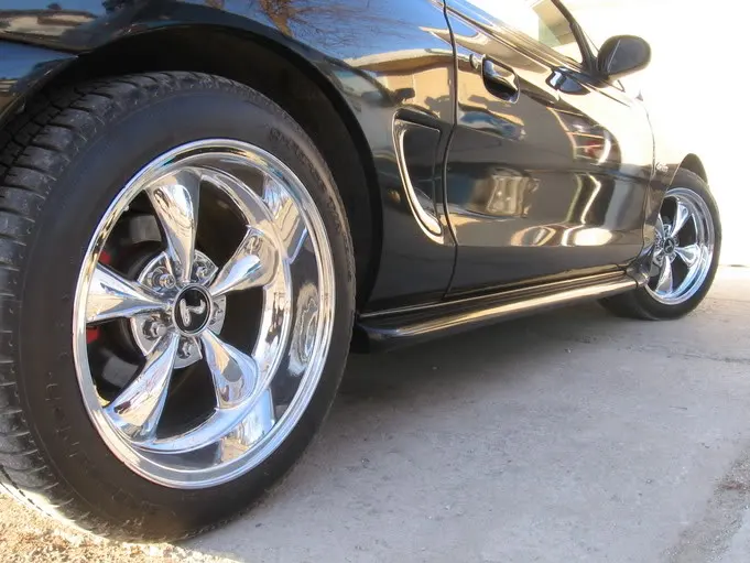

i have 17x9 front rims and 17x10.5 rims out back, they are chrome bullit style. The back tires are BFG kdws 285/40 17, BFG kdws 245/45 17 front.

Anything smaller than a 265 on the front will expose the lip of the rim (most tires have a vertical sidewall) and prone the rim to curbing.
If you look at Pughman's pictures, his tires offer very little sidwall protection for the rim lip. It's not necessarily a bad thing, but you gotta watch out when reversing into a stall with a high curb or pulling in to stalls where you can't see the curbs.
Just a word of caution.
