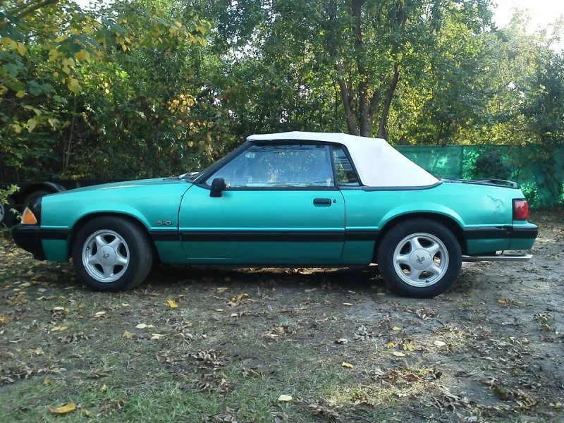

Bought a '91 LX convertible last spring for a pretty good price. It's Calypso Green with white leather sport interior. The seller said it had a new top on it. I'm sure it was new.....at one point in it's life! It was a cheap top, poorly installed with a totally roached vinyl window. The leather interior was also totally shot. There had been past accident damage to the front as well as the left rear quarter. The up side was there was no frame damage and nothing tweaked. The down side was he had tried to work on the rear quarter and made the damage worse.
I was able to use all of the negatives to get a decent amount knocked off the asking price and he wasn't asking a fortune to begin with. Bottom line was it was a highly optioned car 5.0 car, complete and unmolested and in a fairly rare color combo for '91 (106 made according to Kevin Marti). I was specifically looking a Calypso Green Fox when I found this one.
When I bought it:

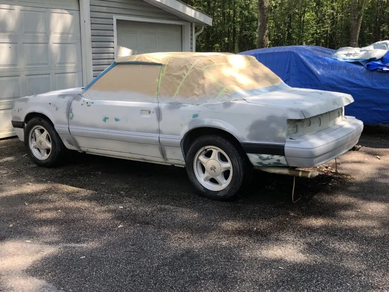

I began working on it in hopes of taking it to Foxtoberfest last year. I went, the car didn't! Weather really screwed me. I succeeded in rebuilding the door hinges with new pins/bushings, rollers, check springs and striker bushings. I also ended up buying new front and rear bumper covers, used original hood and both front fenders and a pair of good used hood hinges. I also had to replace the A/C condensor but fortunately had a spare original in my parts stash. All of the front end light assemblies were pretty much toast as well as one rear tail light. Replacements were added to purchase list. The costs began to grow! Once all of the sheetmetal was on and lined up I was able to get the majority of the body work done and the first coat of primer surfacer laid down. After the first blocking work came to a halt due to weather.
628860

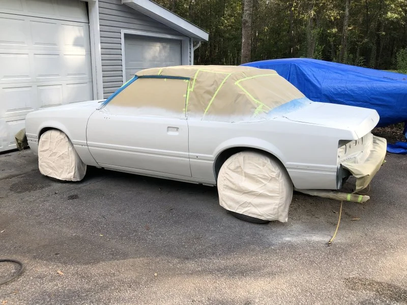

In the past few months the weather started to cooperate again and I was able to pick back up on the body work. I was able to finish the basic blocking, address any issues and lay down another coat of primer. I also got all of the trim that was removed and salvageable cleaned, prepped and repainted. Man there is a TON of black trim parts! Of course the most expensive trim pieces on a convertible were junk..the hockey stick moldings. Cha Ching..more costs!
628859
In the past several weeks I finished off the final block sanding and it was ready to head to the painter. Taking into account that all of the primers, sandpaper, tape, masking paper, fillers, sealer, paint, clear coat and associated reducers/thinners/activators aren't free, the costs continued. I'm sure glad I volunteered to work a lot of overtime and holidays last year!
628861
A big plus to the cost savings, or so I thought, was I had a painter lined up who volunteered to spray the car for me for free. He's well known in the area and is an excellent painter who worked at his family's paint and body shop. The car was FINALLY ready to go in to be sprayed last week. I tried contacting him to arrange a day, nothing but crickets was heard! Since he had offered to do it for free (though I was going to slide him some green anyhow), I couldn't complain but I was stuck. Fortunately my father and some of my friends worked or have worked in the paint and body business. I am blessed with having a lot of contacts. If my father was still with us the car would have been done last year (he painted all of my cars when I was younger). I reached out to another shop and worked a side deal with the owner. I was able to drop the car off this past Wednesday and was able to pick it up today. While I got a really good price on having it sprayed it certainly wasn't free. No complaints here because the result was fantastic. Just more added costs..uggh. I was able to pick the car up today and seeing it in paint damned near brought tears to my eyes.

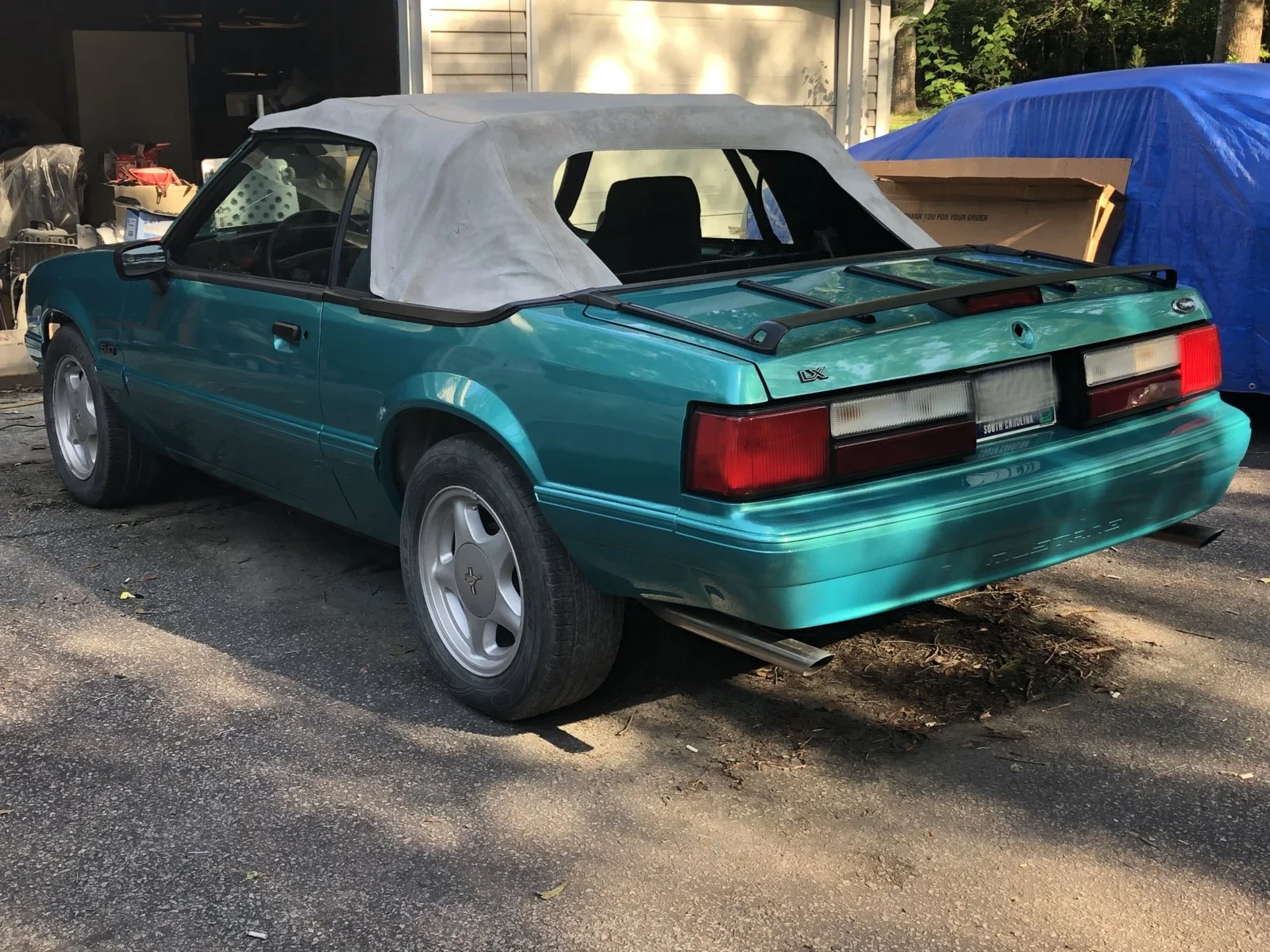

The back of the interior is currently stripped out but I'll shoot some pics of what's still installed...ugghhh. I won't be doing much more towards the interior until I finish reinstalling the exterior trim and getting a new top on. At a minimum the trim around the top (the hockey sticks), HAS to go on first. If not it's almost impossible to get to the attaching hardware with a top completely bolted up. I also hope to have a new windshield put week next week. That'll allow me to reinstalled the trim around it and the cowl.
I'm going back with the white top with a glass window. I like the white and Calypso color contrast, even if white is a total pain to keep clean. The top will be last so I can let my bank account recover! Hopefully I'll make some money from my trip to help it. The only "color change" I decided to make was the body moldings. I prefer 92/93 style body color over the original black. The car was almost a '92 anyhow as the production date was 08/91!!

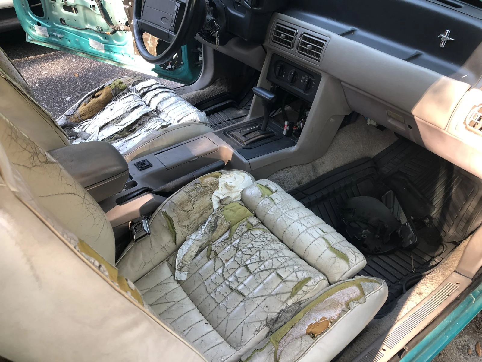

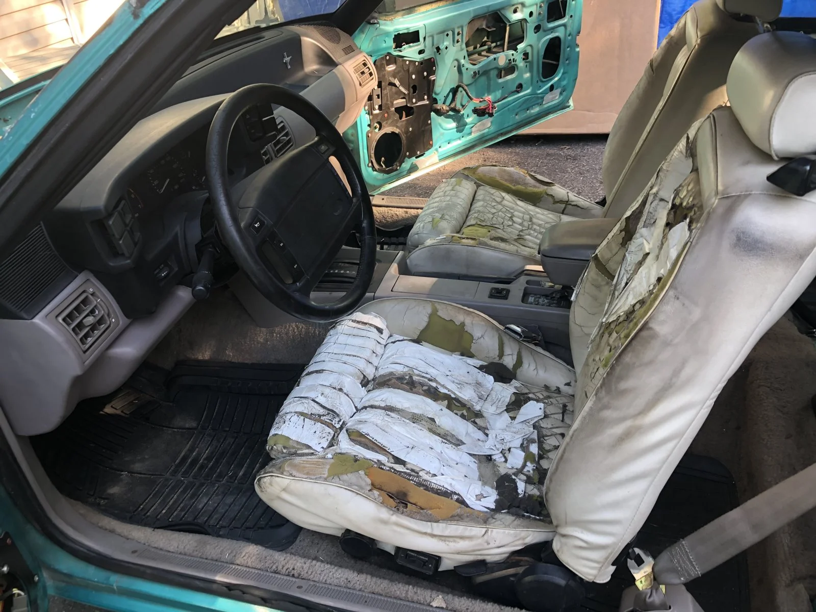

Okay, you asked for it! Here's a few shots of the crusty cabin of the Calypso Cashpit!
629915
629916
The front seats had some uber cheap covers on them. I took them off for the photos. The back seat area is disassembled and removed so I don't have shots of that.

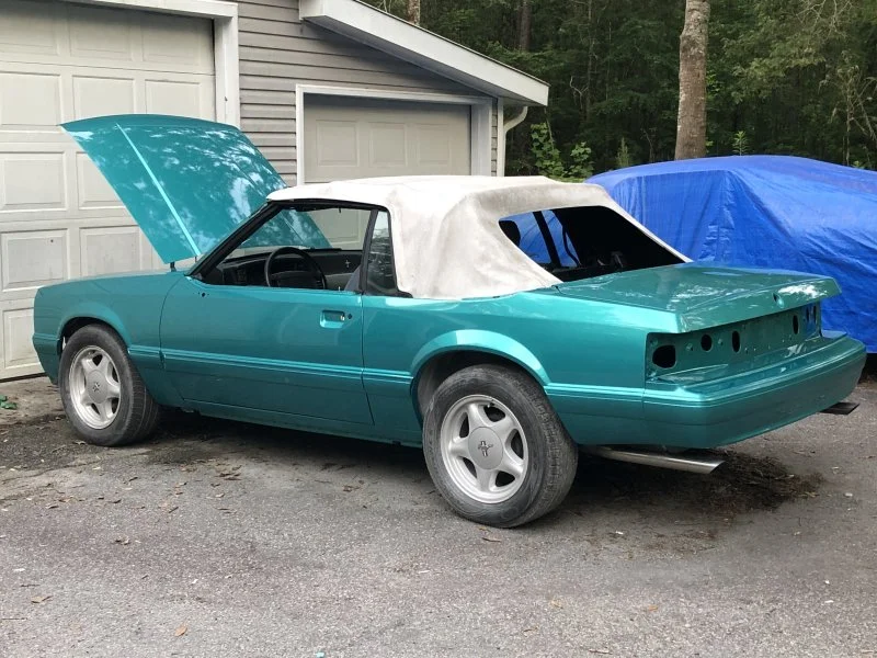

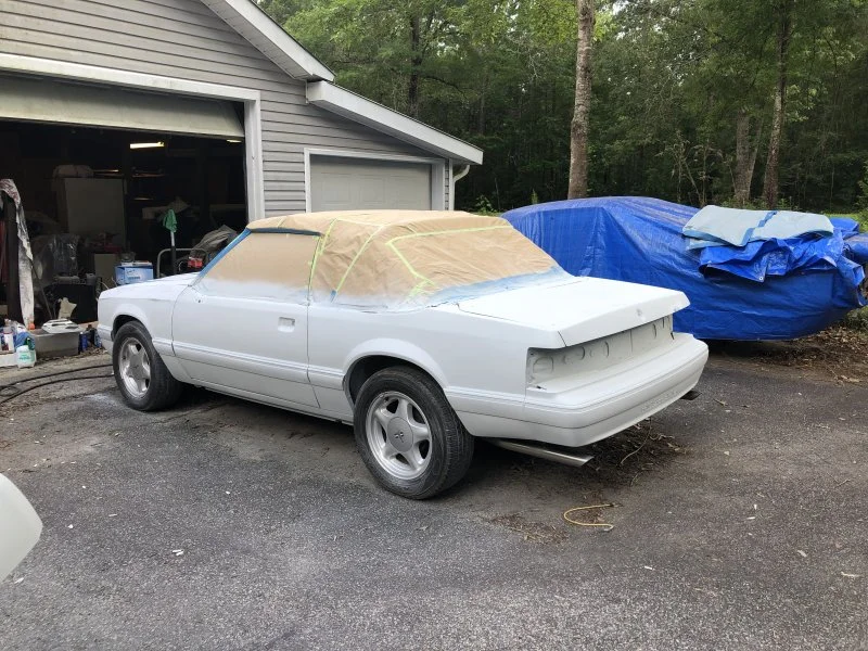

Since I returned home from my work trip I've been able to put a nice dent in reassembly. The car was supposed to have a new windshield installed yesterday but Safelite screwed up. First they told me Friday they couldn't get Carlite glass for the car (yep...the day before the appointment). Then they called yesterday morning at 8:00am to tell me they couldn't come out because no one had ordered the glass that they did carry. Grrrrrrr. I was hoping to get all of the front trim on! Here's how far I've gotten..
629918

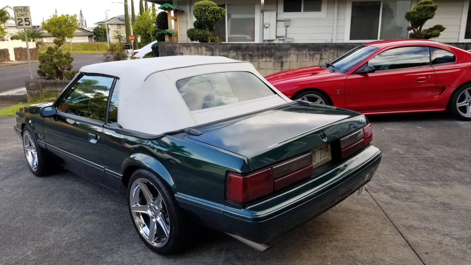

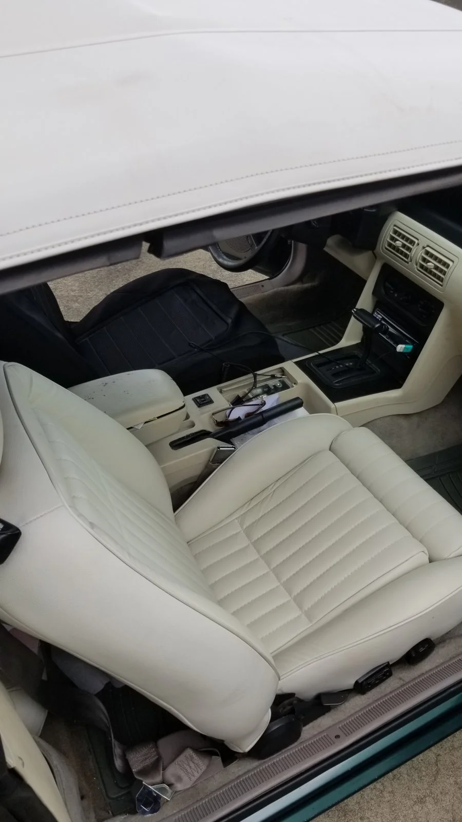

Awesome car. I did new upholstery (leather) and a new top on my 90 convertible myself. It wasn't really difficult, and doing the work myself saved a ton if cash. With new leather seats that thing will look good! Love the color! Here are my seats.
And top
Great looking work! I agree 100%, new leather looks super!! Did you do both seats and top?!

Yeah I did the top too. It wasn't bad. I swear. You just need a good stapler, mine runs off my compressor. I followed a DVD from late model restoration. I had another convertible before and had a professional shop do the top. The one I did myself on this car actually came out much better. For the seats I used the TMI leather and new foam.
