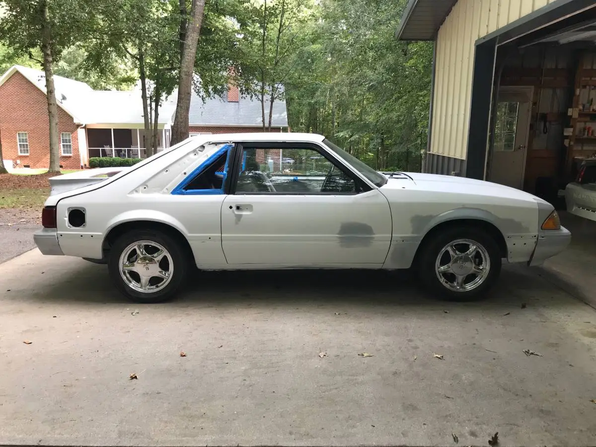

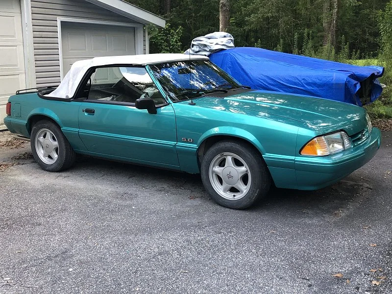

Been a few weeks since I've posted any progress but some has actually been made. A lot of what I've gotten done you really can't see, weatherstripping, quarter window guides, etc. Here's the biggest and most visible accomplishment:
630837
Yep, the front end was built out and installed. There weren't any front end shots previously because it wasn't on. I couldn't adjust the hood until after it was on but I got that finished too. I HATE lining up hoods! It was a true test of patience and I had cringed at the body shop when they said they wanted to take it off to spray. I have the "pleasure" of getting the quarter windows adjusted properly now. If anyone has any tips to make it a little easier, please pass them along.
I have a restored set of Pony rims with new rubber I waiting to put on. I need to clean up the inner fender liners first. Between work, weather and honey-do's my time has been limited on what I can get done. The days I have been able to get stuff done have been sweltering! Wrench, wrench, wipe sweat off of glasses and out of eyes....repeat. The heat index has been 100+ on most days and no breeze. When it does cool down it's only because a downpour is coming and you have just enough time to run around picking up everything before it hits. Getting closer though. I'm hoping to have it off to the top shop in the next few weeks. Fingers crossed.

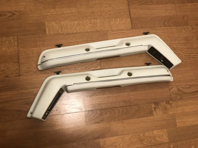

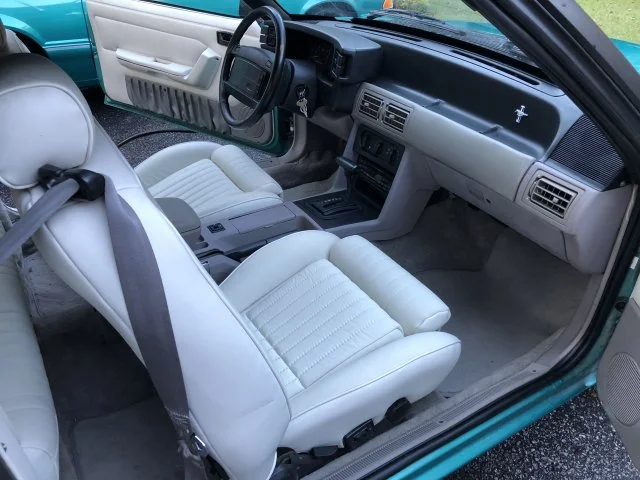

So far I've refurbished both armrests (new chrome trim, switch bezels and dyed pads). I found a white armrest assembly on Fleabay and used it for pieces, mainly the pad. There was a little discoloration so I dyed both to match each other. It's a little pricey but I gotta say I love the LMR vinyl paint/dye!

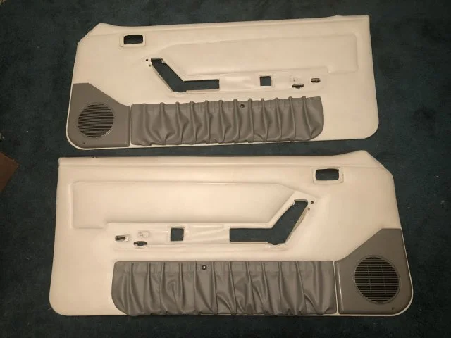

I also redid the door panels. At $500+ for a repop set I preferred to work with what I had. I cleaned the vinyl really well as it was in super shape (no re-dye necessary), put in new backer boards, inner door belt weatherstrips, map pockets and speaker grills. They came out really nice and for under half of what new ones cost. I have about $200 total in them.
I had the stuff to do them for a long while but was kinda scared to screw them up and really didn't know where to start. I ran across a Youtube video on a channel called House of Dula where he did a really good instructional video on how to replace the backer boards. Armed with that helped my confidence. I did spring for an air stapler and it's a huge help!

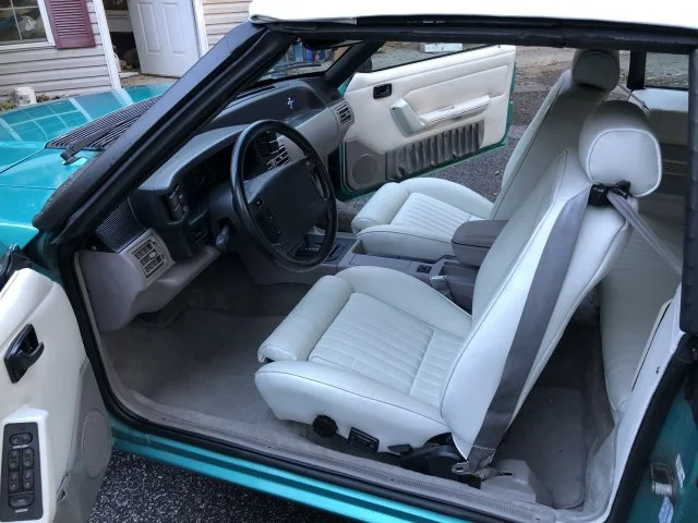

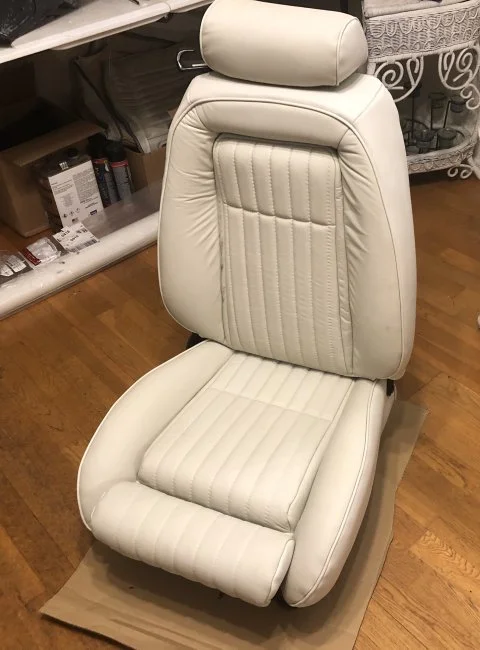

The last thing I've done is to finish the seat upholstery up. Again the air stapler was a great help when it came to covering the knee bolsters. I am by no means an upholsterer but I'm happy with the results. I can say the single hardest thing to do was installing the new covers on the headrests. All I can say is avoid at all costs! What a PITA!! This is the passenger seat (and the first one I did). The drivers seat is also completed and went pretty smooth after exerperience gained from doing the pass. seat. I also did the headrest first!
All that's left for the interior is to do some painting on the console and the glove box door and finish re-covering the rear trim panels and I can then install the new carpet and reassemble the interior. I'm hoping for some really productive time this weekend. Next shots to come will be the rear trim panels when completed.....and a little more frequent updates now. Then, on to a new project I bought myself for my birthday a few weeks ago....

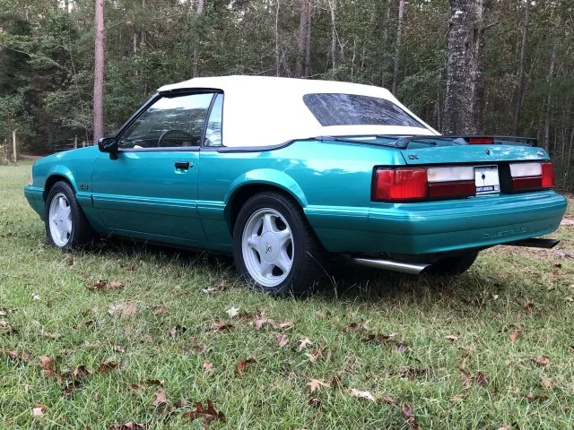

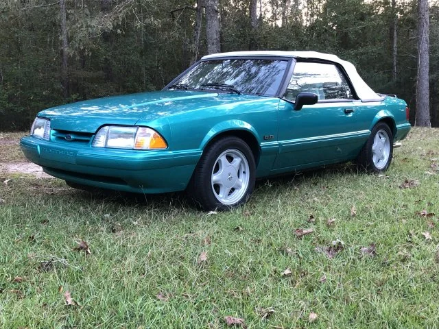

On the road...FINALLY!! I had off work all of last week, some normal off days and some vacation time. I put in between 8 and 10 hours a day working on the car. It was going to Foxtoberfest this year..period! A week ago this past Sunday still saw no interior. Several days of steady work and waiting out drizzling rain two days in a row but I got it all back together. Here's some pics. I've previously posted the "before" pics so here are the "after" pics:
Last Thursday it went for a front end alignment and Friday it was on the road to Charlotte. I've never driven the thing more than a block or 2 since buying it. The first road test was 3hours on the interstate each way. If you're gonna be a bear, be a Grizzly! Here's the "finished" pics before the road trip:
The trip up went smoothly and the car ran and handled great. I had the low coolant sensor decide it didn't want to work occasionally (even though it was full), a Check Engine Light that would pop on after 20 or 30 minutes of driving (but no hard codes, I think it's an EGR valve problem), and cruise wanted to work when it wanted to. Other than that it had no other problems on it's maiden trip.
I showed the car Saturday with the top down (to hide that ugly top). As rain moved in I started to put up the top and windows. First real casualty, the left quarter window motor gave up the ghost. When we got back to the hotel I had to do some shade tree engineering to try to keep the expected rain showers out of my fresh interior. A piece of cardboard and some duct tape did the trick and kept it relatively dry. Yes I have a pic of it, no I don't want to post it! As Dwayne Johnson said in "Skyscraper", if ya can't fix it with duct tape, ya ain't using enough duct tape! As if a windy and slightly chilly 3 hour road trip wasn't enough, the heater core decided it wanted to leave the party. The temps were good the whole trip but it got real foggy, real fast if you used the vent with the temp turned up!
I still have more work to do in addition to the new repairs to make. Although I worked on the right side window aligments for almost 3 hours, they still need work. What a pain in the a$$! It still needs the new top. The one on it is a 5 footer, I did get it to clean up quit a bit but it's still gotta go.
