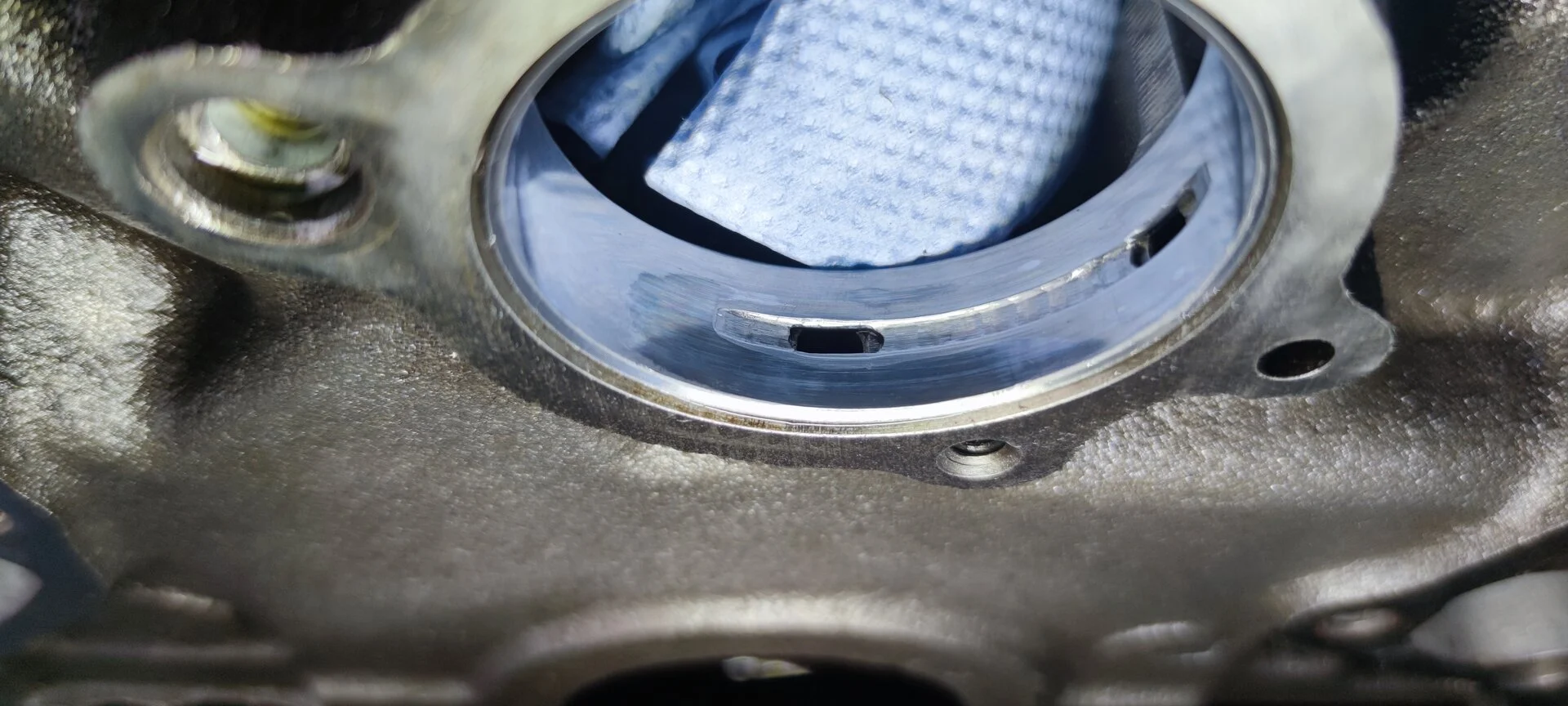

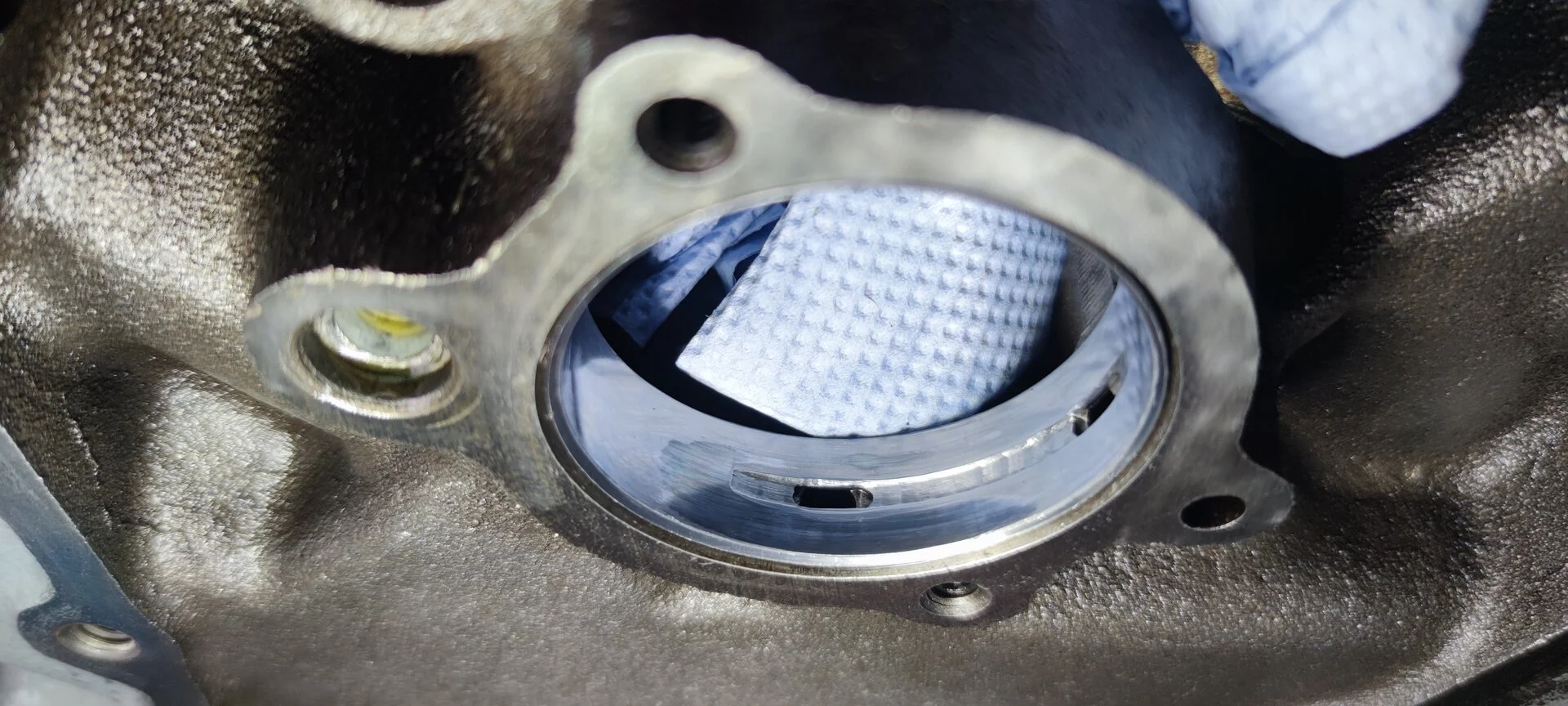

Hi!
Long story, but there are 300miles old cam bearings (Mahle performance).
I am changing mains and rod bearings, cleaning engine due to gold oil.
Would You change these or leave them as they are? This on picture is #1 which tool most damage, more to back less polishing there is...
They are polished at bottom.
Thnx for suggestions!

V block the cam with a dial indicator and check for straight (it is probably straight within a half thou)
Those bearings do not look all that bad to me (there has to be some wear some where)
It's the clearance you are worried about
gold oil.
oil touches every single internal part of the engine and some of it stays inside passages
if you had metal in the oil, some of the metal flake is stuck behind the cam bearings. Remove them, have the engine baked/washed/etc than have new cam bearings installed
at the minimum, have the engine washed out real well, and most shops when they run 'em through the jet washer, the cam bearings will be damaged anyway. Thus, replace them.
And one other issue. If you don't replace them and a few thousand miles down the road your oil pressure is down, are you gonna question your choice to leave them?
Thnk guys.
According to common sense and that I had engine out, I changed them. They were performance ones, I changed with regular.
Unfortunately can't mic bearings. They sincerely looked like they 'adjusted themself to cam/bores' but I didn't want to take a risk...
Camshaft is new Melling, no sign of wear, few scars here and there, goes out with 2000 grit polish. Bearing journals took less damage than few lobes (only scratch, cant feel it with fingernail, and again, polish with 2000 grit removes them).
Heads are on, pistons in bores, so I cant jet wash engine, but I have in plan to splash it really good with lacquer thinner and brakecleaner and blow all out with compressed air.....
Wish me good luck.... :-(
