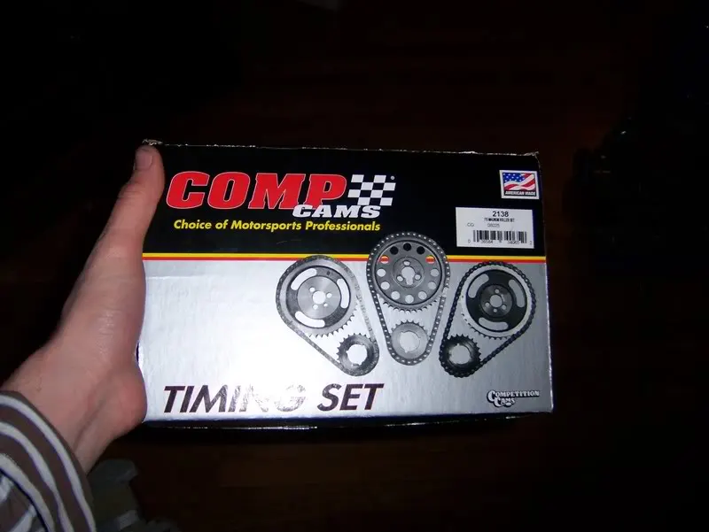

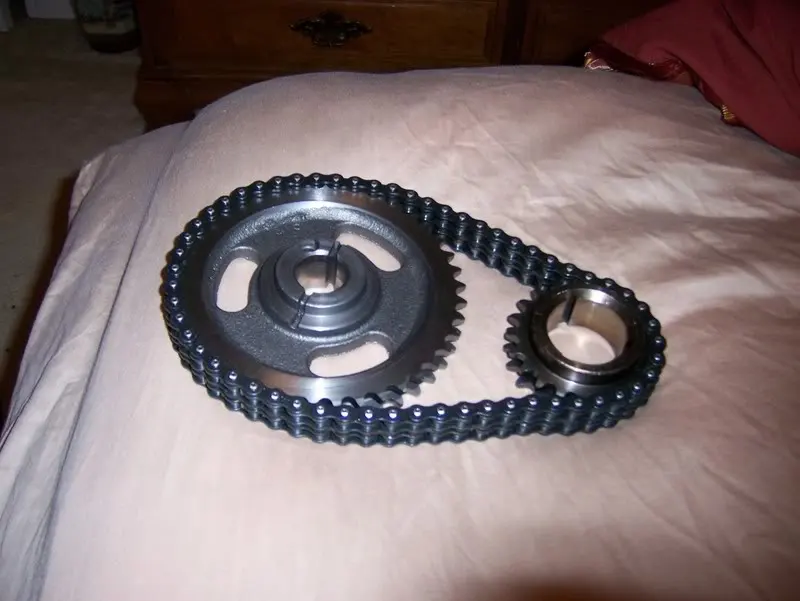

Ok guys project is back into full swing as of the arrival of my timing chain. I have off tomorrow and wed. so I should have it running!!
44 dollar timing chain:

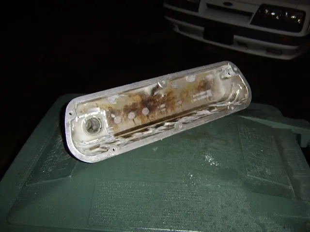

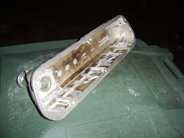

Should I buy a set of lifters?? While I am in there? I mean it will be another hundred bucks or w/e but I am not sure. If I have to I might as well, its not like its that hard to do down the road. Also do you think my stock VCs will clear the 1.6 harland sharp RRs? If not, what VCs around 100 bucks would clear and clear my intake with a 1/2 inch spacer?
the lifters are kinda meh, they are rollers so its not like they are gonna really wear out.
for my 1.6 roller rockers i had to clearance the valve cover... a lot actually. but i got some cheap ones that were huge. HS maybe alittle smaller because they are a higher quality aluminum.
i cut the baffles out of the top, and all the support rails out of the sides, then used a little jb weld to fix the few places the grinder cut through.
