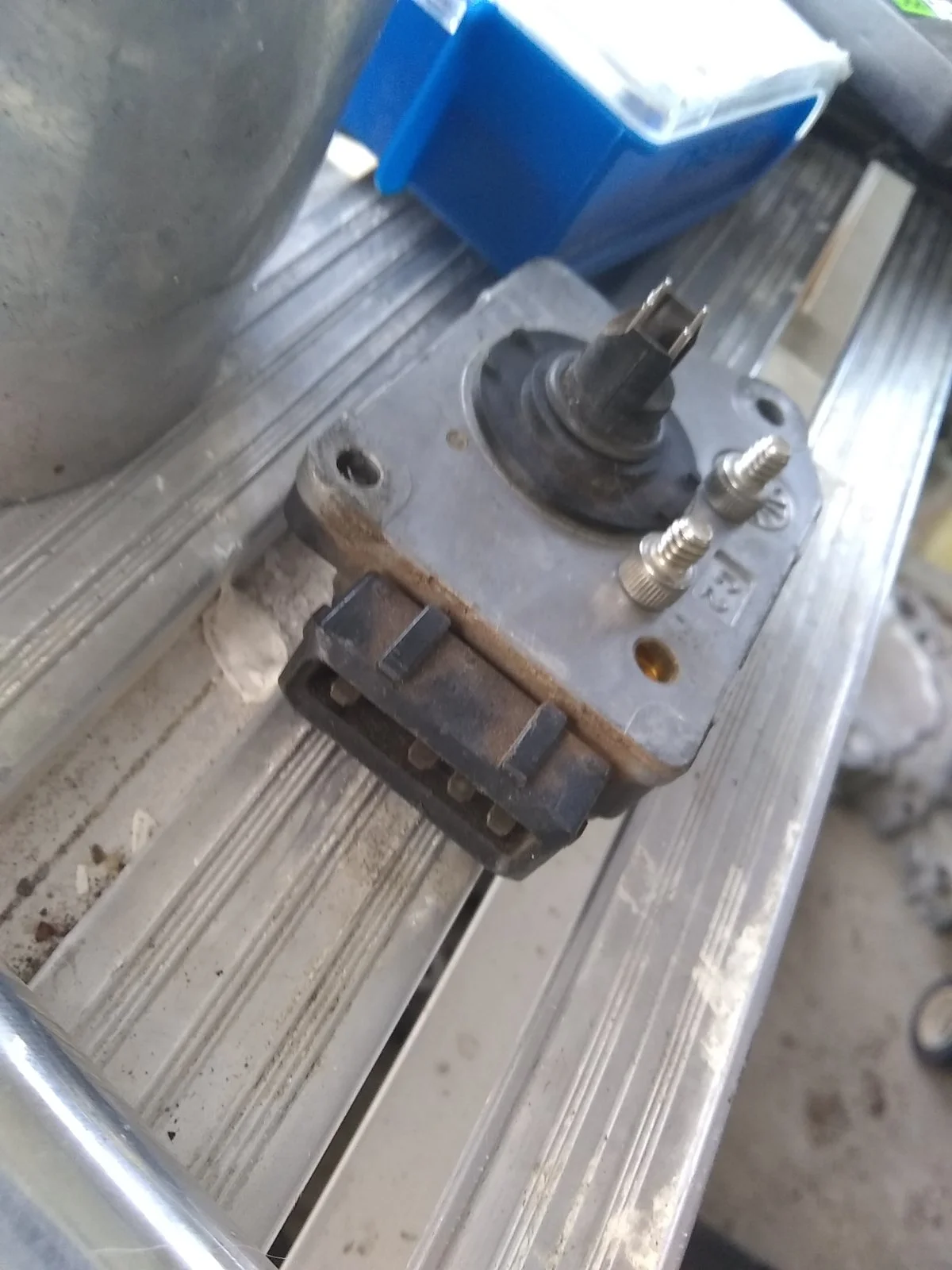

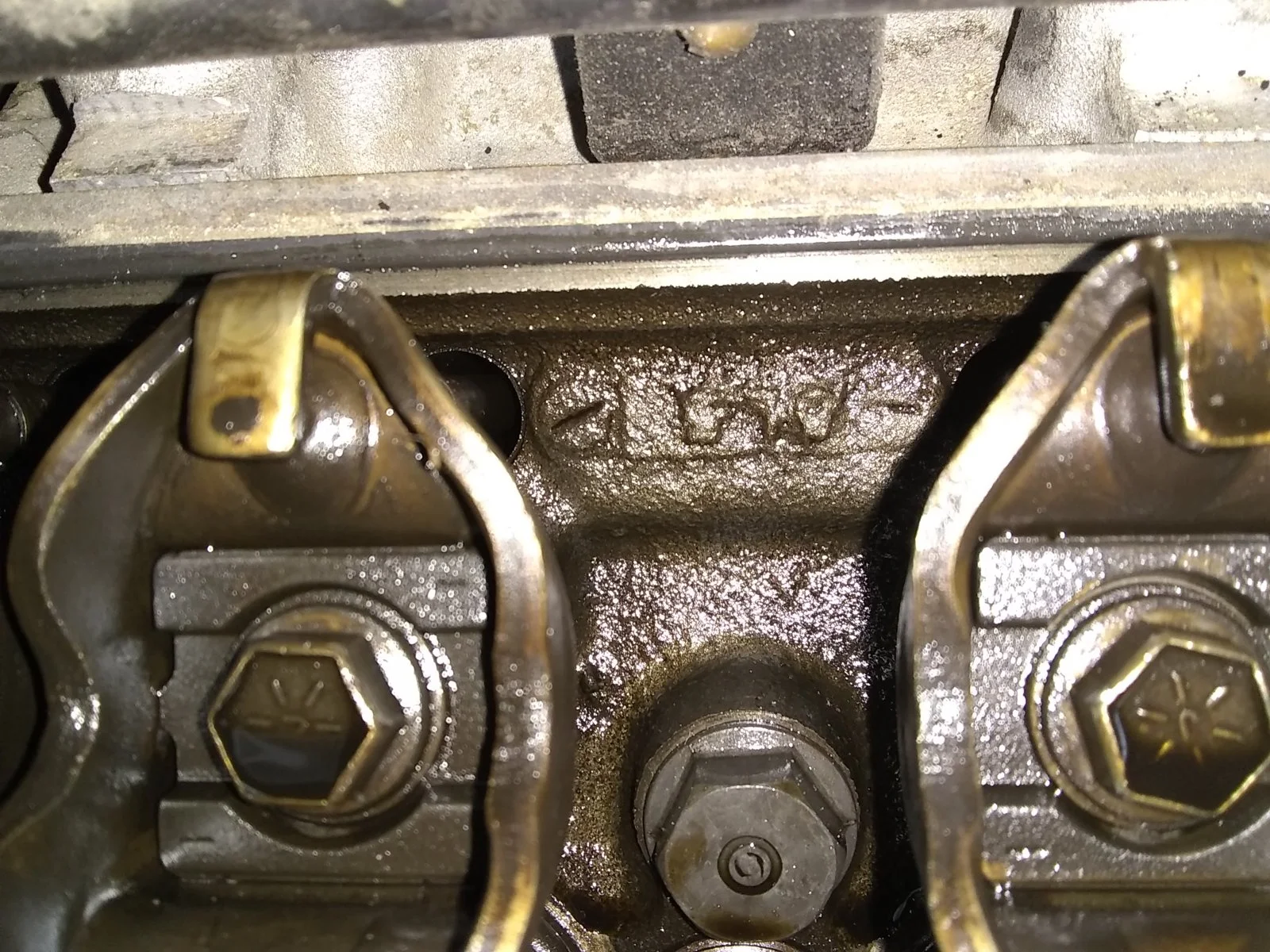

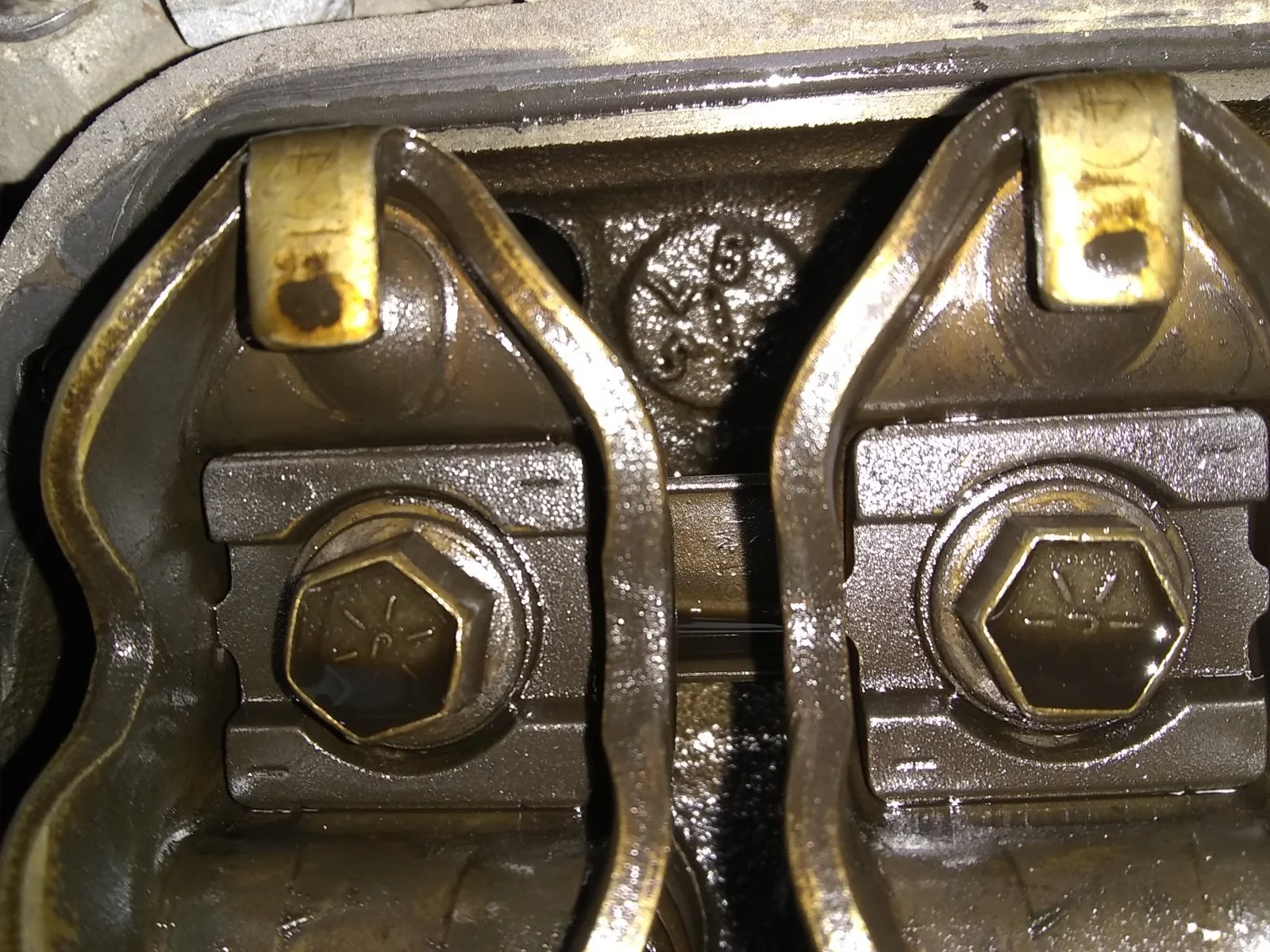

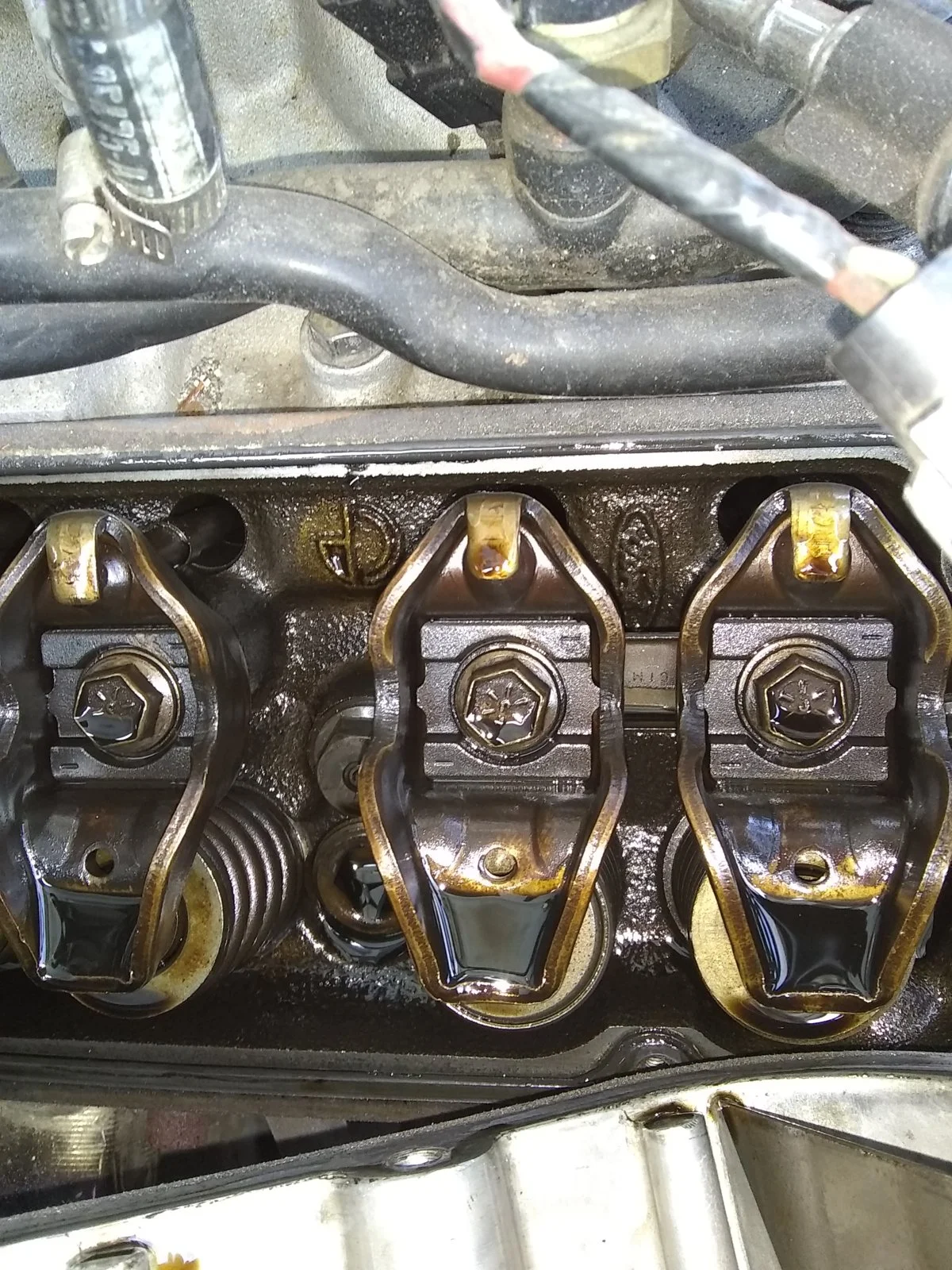

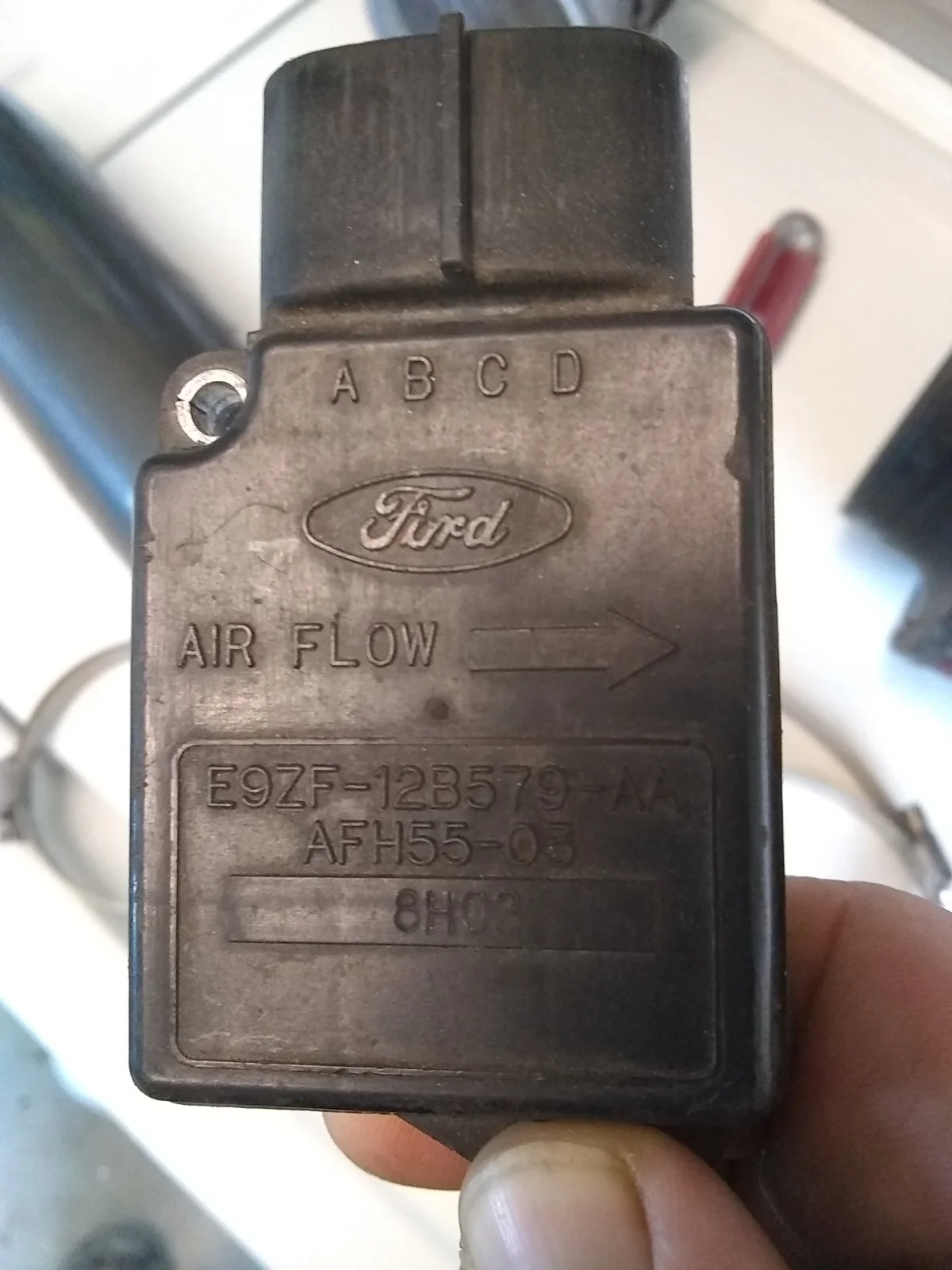

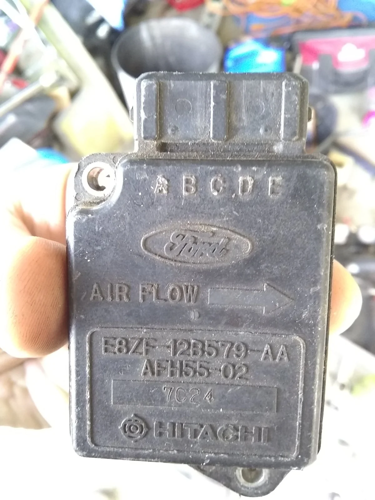

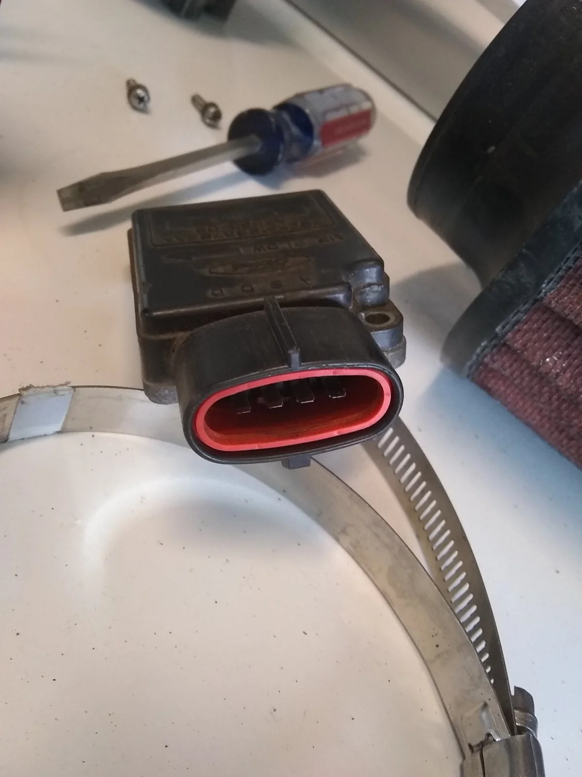

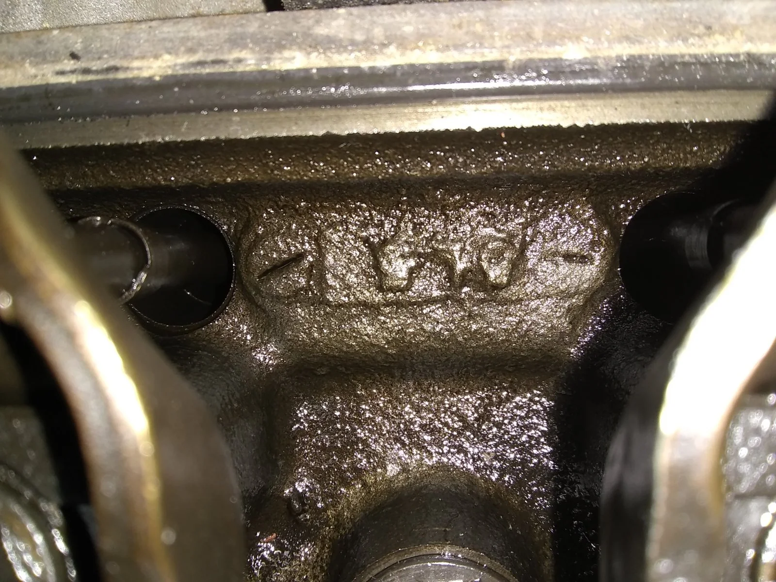

The guy that sold me the car didn't know much about it and gave me a few loose parts with it including this BBK MAF, he said was calibrated for 29lb injectors so I assume he meant 24lb. I've read E7 heads have no marking on the top side of the head and I pulled my valve cover today and there were some markings I couldn't quite interpret. Before I purchase the GT40P heads, I would like to know what I've got. I'd also like to know what this MAF actually is, as I'll be running 24lb'rs. Please see pictures for the casting marks on the heads and markings on the MAF. If anyone could help me identify these I would greatly appreciate it.
The 12B579 is the Part Number.
E8ZF=
E= 1980 (decade of manufacture)
8= 1988 (year within decade)
Z= Mustang (product line)
F= Engine Accessories (source of part)
That MAF sensor is California only, since in 1988, only Cali cars had them. All got MAF in '89 & all were ABCD.
I can't explain what the "E" terminal is for.
Makes sense, since you are in Nevada.

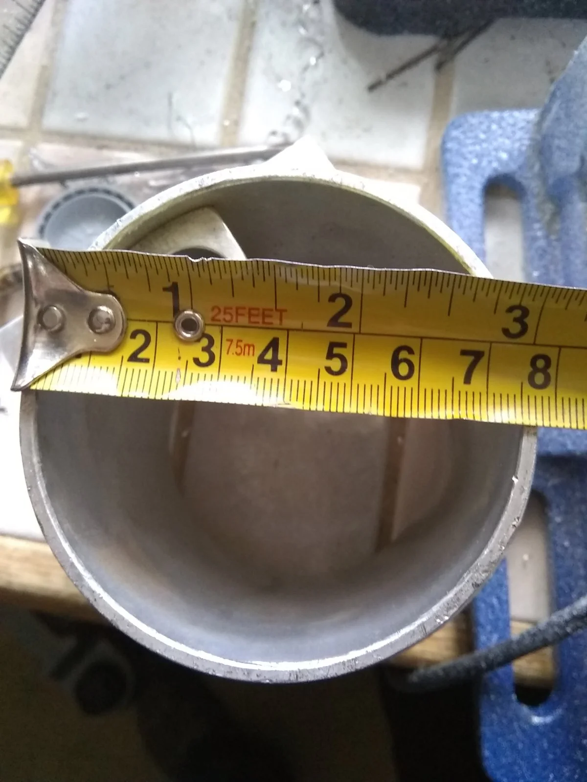

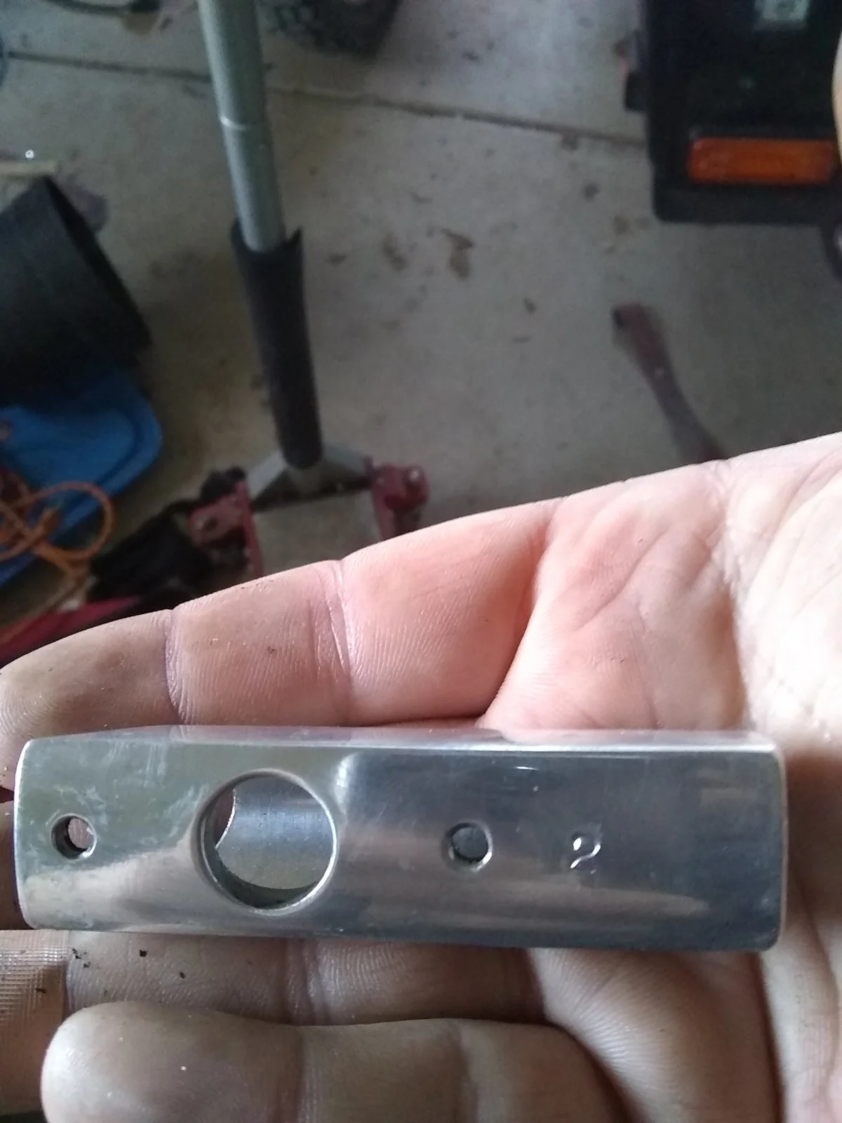

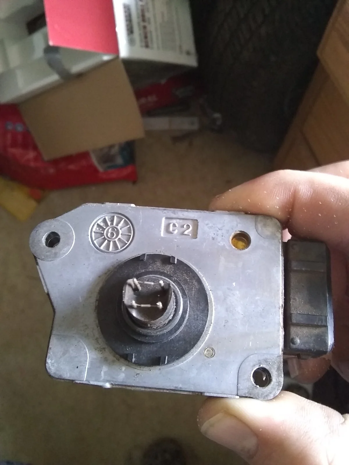

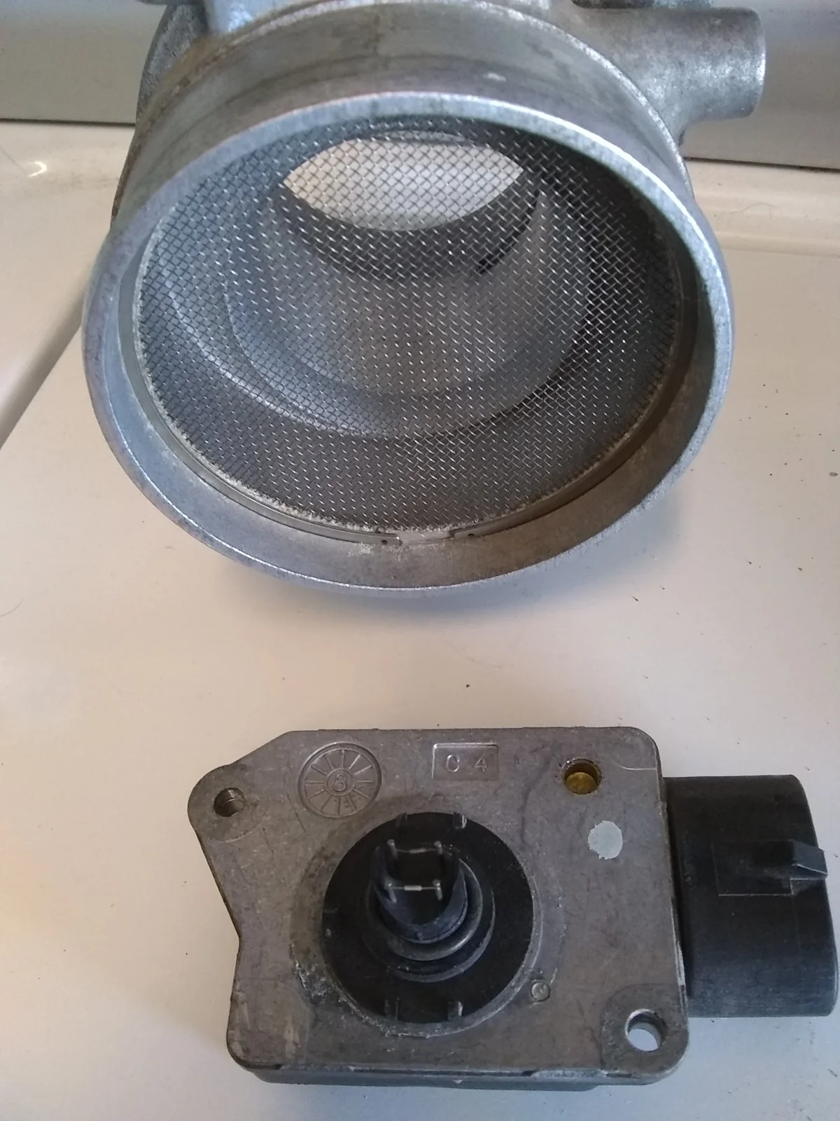

Can't tell the BBK calibration, unless I can see below the sensor or a pic of the inside. I think the BBK's were C&L, but not sure. If it is a C&L, the calibration tubes are removable & color coded, when you remove the sensor. Measure the ID of the housing, probably 73mm, not the 76mm. You can still get the calibrations tubes from American Muscle who bought C&L.
Can't help with the heads.
It's not a C&L sensor; they only provided the housing, not the sensor.
The casting marking don't mean anything.
That's a newer calibration tube. It's 24lb for the 73mm.

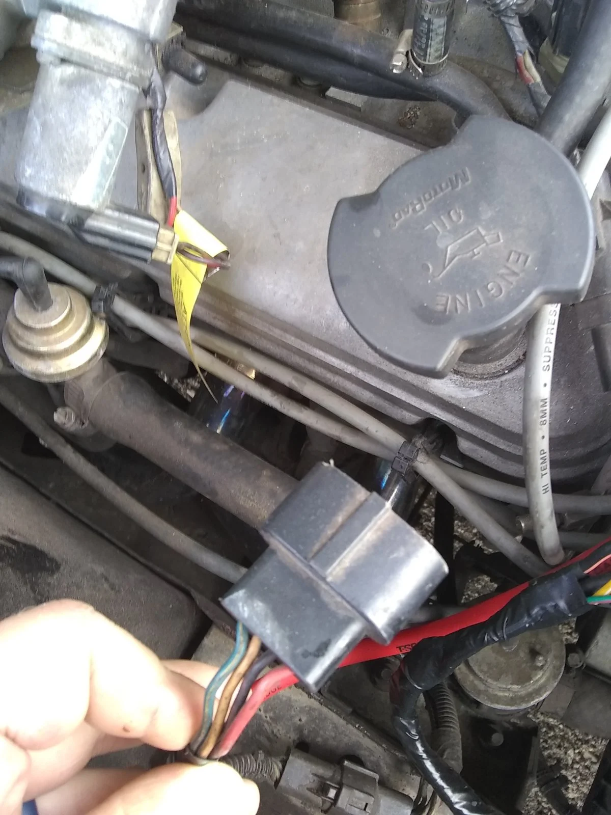

Ford has used a Hot-Wire type mass air flow sensor for many years that either comes with or without an internal air temperature sensor. If the MAF sensor has 6 wires, then this is a dead giveaway that it has the air temp sensor integrated inside. If the Ford MAF sensor on your car has 4 wires, then it does not have an air temp sensor integrated within it (the air temp sensor will be somewhere on the air duct that connects the MAF sensor to the throttle body or somewhere on the intake manifold.

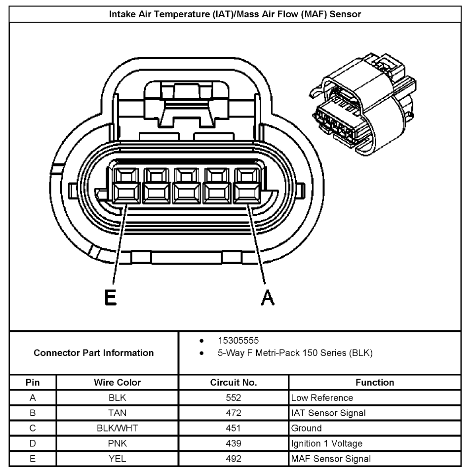

Does your connector look like this?
What harness is actually on the car, 4 wire or 5 wire?
You can swap the sensors from housing to housing.
First 4 wire MAF sensor pigtail on car

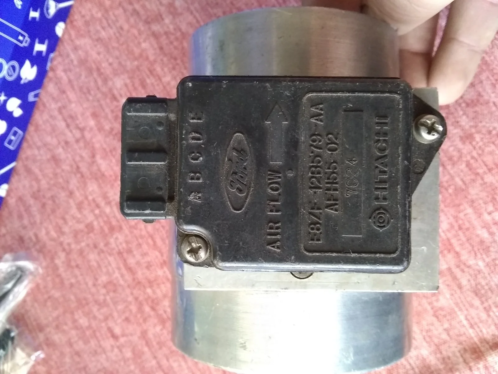

Second MAF sensor mounted on car and stock housing
Third MAF sensor mounted in the C&L housing.
So it looks like I can use my current 4 pin sensor in the C&L housing with 24lb'rs?
Thank you so much for your help, saved me the $250 for a new MAF!
Case closed. I'm thinking are E7's. Plus I don't think I can go wrong getting a set of cleaned up GT40P heads with Lunati dual springs for $300
