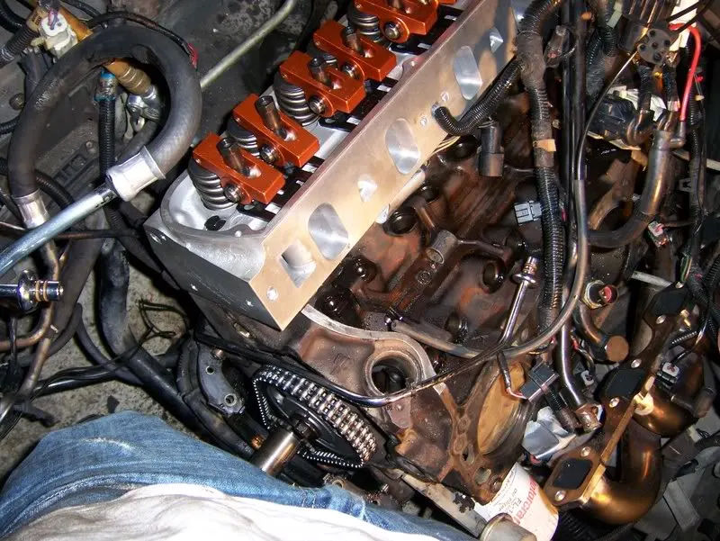

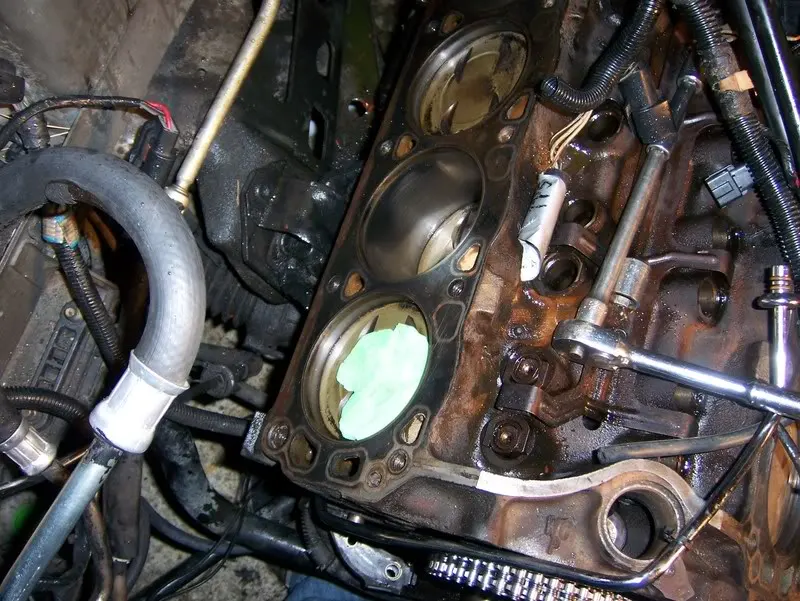

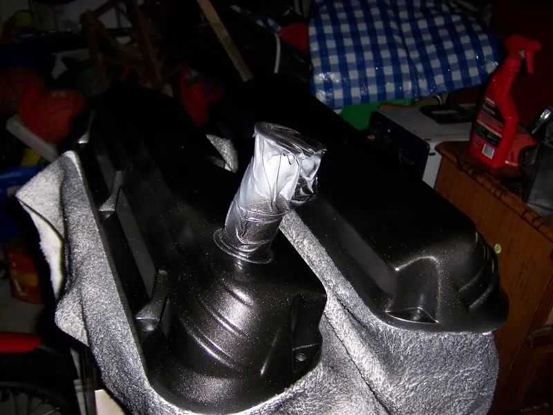

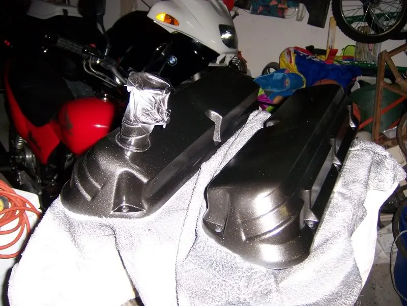

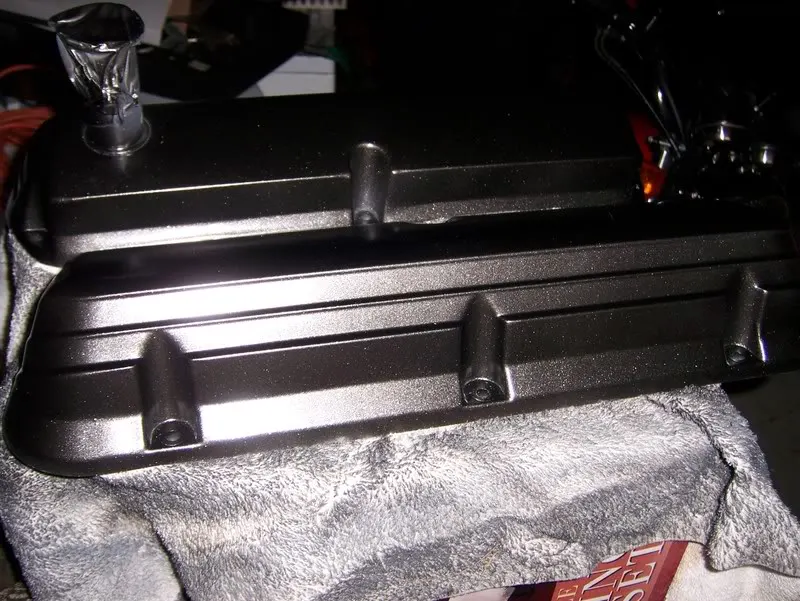

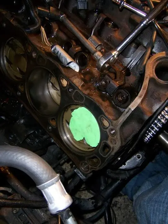

Cam is in along with new timing chain. I bolted down the head and a set of RRs, put some play doh on the pistons and turned the engine over a few times. IT HITS!!! Dammit, now the engine is getting pulled tomorrow on a borrowed lift and it gets taken down to Coupe Performance friday hopefully to get the pistons notched. Then the engine goes back together while on a stand and dropped in as one. The valve covers were primed and painted tonight by my friend while I did the dirty work and they came out AWESOME! They match the upper intake.

well.....post some pics

They were uploading, up now

nice, like the color. what is it?
grey5.0beast
Cookies should never be DUNKED!!!
Aug 3, 2004
atl ga
Feb 12, 2008
#68
  • Feb 12, 2008
  • #68
IDK exacly what the color is but I believe it is a rustoleum metallic, like midnight blakc or something like that, although it is more charcoal.

Did those valve covers need any clearancing?
grey5.0beast
Aug 3, 2004
atl ga
Feb 13, 2008
#70
  • Feb 13, 2008
  • #70
Yeah the pass side is gonna need some work. I'll have to do what that guy above did, I'll just be a little more careful and not cut through the VC

Why do they hit? What combo you running again?
grey5.0beast
Aug 3, 2004
atl ga
Feb 13, 2008
#72
  • Feb 13, 2008
  • #72
Stock pistons, lunati 51014 cam, Patriot Performance 185cc heads w/ 2.02 and 1.6 valves

doesnt surprise me that they hit with that 2.02 valve. I dont think any 2.02 will clear the stock pistons....perhaps with a stock cam...idk.
You made the right call to pull the motor and re-ring it...while you are notching the pistons.
Should be a sick little setup. Might want to send that lower intake out for some porting while you have the thing apart for so long. T-moss would be able to hook you up with another 15-20 hp easily on a combo like that.
You arent going to run the stock 19# injectors are you?!
That color is awesome, put on a few coats of clear and it looks even better (like a good car paint job). I painted a few old dirtbike parts and my gt40 upper and lower, and vc's and came out good when I did it.
