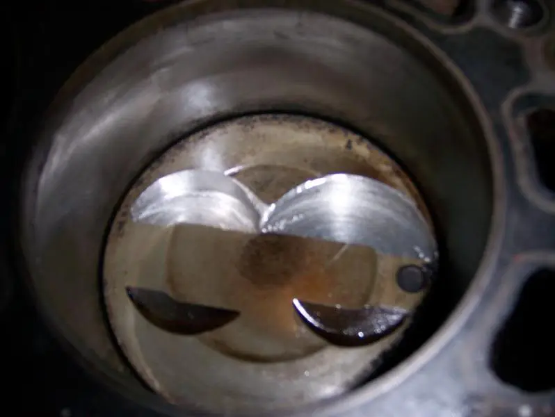

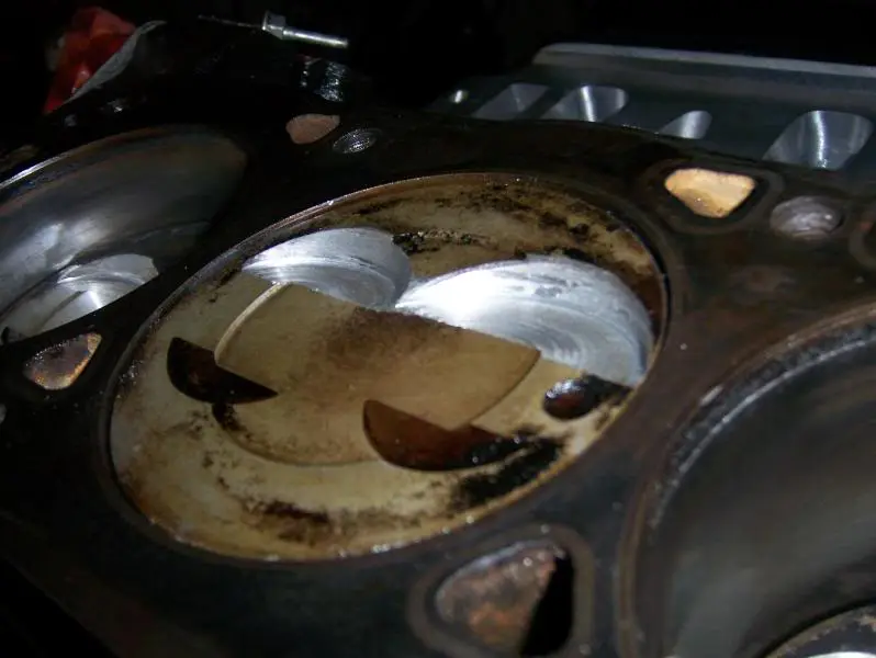

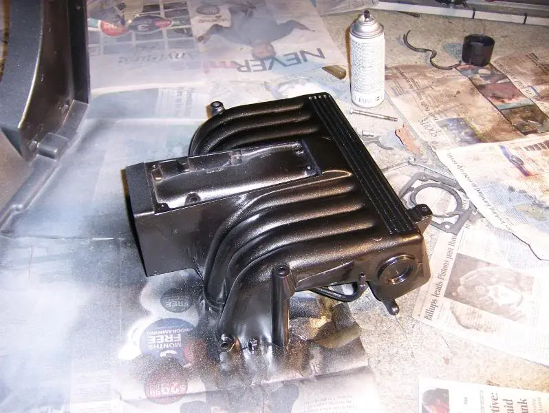

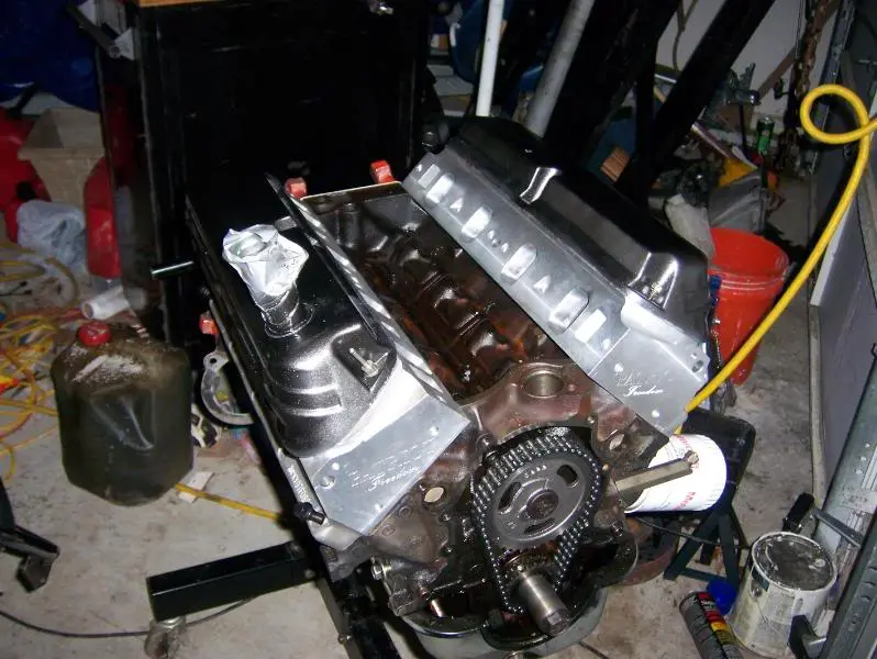

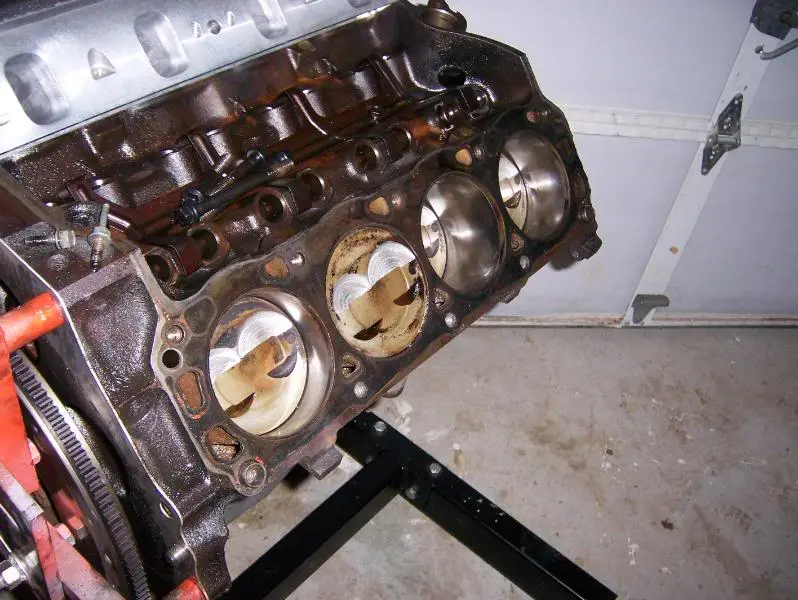

So today I went to the engine builder to pick up my block. Pistons are now beautifully notched and ready to go. He notched them a little bit over in case I ever wanted to go bigger on the cam. He also checked my pushrod length and said it was between 6.25 and 6.30, he said it would be fine to run the stock ones.

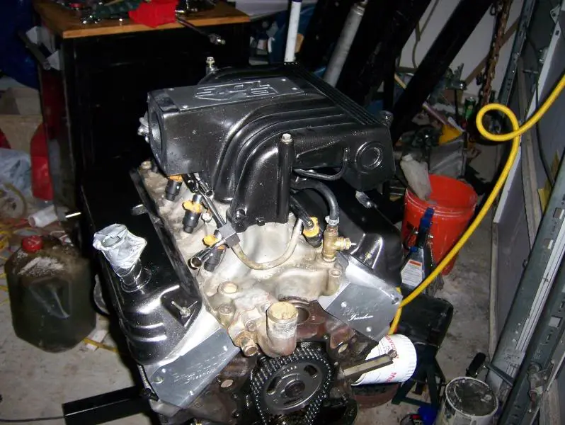

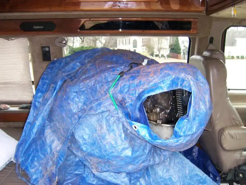

This is my engine in my van. Me and a buddy awkwardly lifted the damn thing into the door opening. You can see the timing gear and chain marks in his chest from when it flipped over backwards and he just got underneath it and squatted it upwards...he is a beast lol
On the way to the engine builder(Coupe Performance in Covington, GA) the asian engine lift was taking a nap

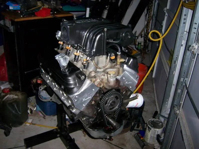

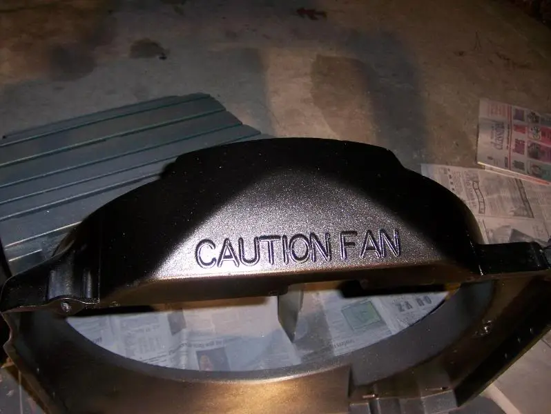

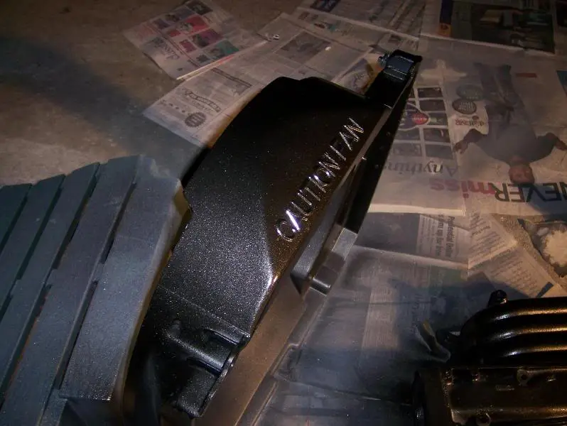

And we repainted a bunch of stuff. I also polished the tensioner pulley, the egr valve and I am working on the t-stat housing

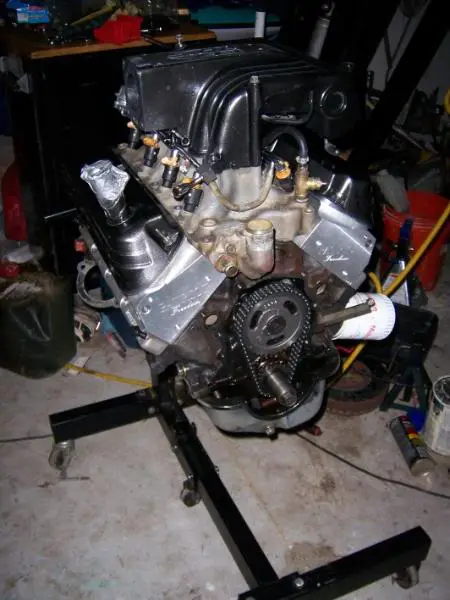

All mocked up, don't worry, I am painting the lower intake silver tomorrow.

man it looks like he took a deeper cut, i hope the piston isnt too thin there now.
so did you get the new rings and/or bearings???

The pistons are cut exactly where the valves hit. And it is not much deeper as it is wider than the stock reliefs
