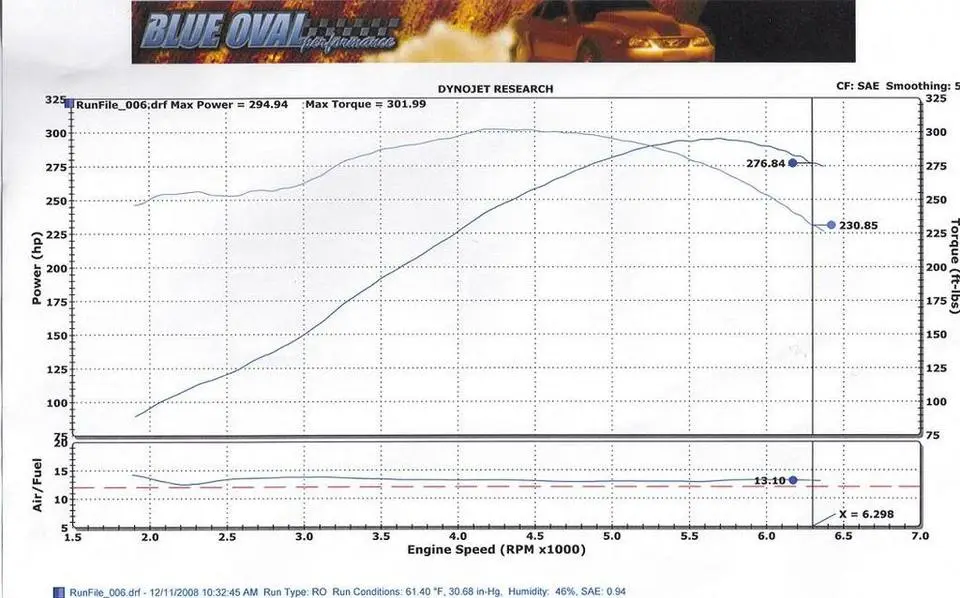

Kind of skipped down to the bottom so if i missed something im sorry. but this is my dyno 165 AFR's with 1.7 Crane RR's Steed #19 cam and trick flow track heat intake. and the bolt ons in my sig
i ran a 13.5 before the HCI, and im getting it S/C before the track re opens so i wont know exactly what this did besides how it feels, from the oem stuff to this its a blast. the cam doesnt sound amazing but the whole combo together works out great. and 294.9/301.9 isnt bad right? 112k on the motor.

Thats pretty neat :D Maybe you can do that when i get my vortech/meth inje. in. that'd be cool to see vs others with different cams. also thats with a tune/and 42#'s. All of these parts me and my tuner chose for the end result wich is very close. so lets see how it all comes together in the end :)
