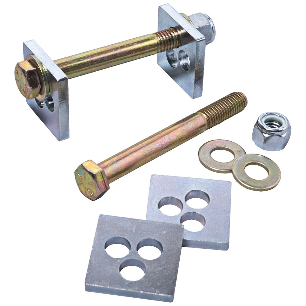

You adjuster is basicaly a cam lobe or excentric that rides in a boxed area ,as you turn the bolt the excentric moves the lower control arm in or out depending on what direction you turn the bolt . The problem is somehow this bolt is turning on its own . Could be rough roads or possibly oil or grease under the excentric . Your best bet would be to get the excentric eliminate kit ,it bolts solid using several holes to chose from for the correct setting . You can get this kit from any of the Mustang parts dealers

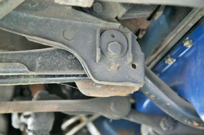

I don’t think it’s the camber adjuster anymore and now it’s starting to look like worn lower ball joints. I’ve started hearing a squeaking noise (like a mattress with worn out springs) when I drive. And what’s a good way to check bushings on suspension?
there should be NO movement in any front end JOINT, that includes control arm bushings, ball joints, tie rod ends, pitman arm, any part that pivots. Jack up one side with a floor jack or a bottle jack under the lower control arm as close to the tire as you can without touching the tire. hold the bottom of the tire and push in and out, if you feel ANY play or click or thump, you need to have someone look for that movement while you're doing it. Then repeat with the top of the tire, then move to one hand on the front and one hand on the rear and check for any movement there.

Hey guys I think I’ve got it!
I checked the lower and upper ball joints and it showed no sign of wear. So we checked the bushings and sure enough they’re dry rotted out. What we think causes the camber to change so suddenly is that the lower control arm has a lot of play where it meets with the camber adjustment lobe. I think the bushing is bad...or maybe the control arm is just worn. The control arm still pivots off that bushing where the cam is but...it also travels a good bit linearly in and out of the bushing which seems like a red flag.
What do you guys think?
Thanks!
Torch the bushing out and replace it with a poly bushing. Also when you put it together, slather the frame/torque box side and the bushing faces that contact the frame with silver antiseize, this will keep the poly bushings from sounds crunchy and squeaking like crazy.
