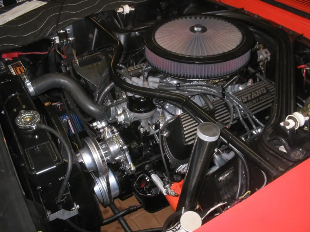

Hi,
I'm running a 331 (333 w/.040) OEM 5 bolt street warrior. It's running, TW 170s, with a little bowl cleanup, cam matching springs, 10.6 CR, Performer RPM, TRI-Ys, 2.5" (63mm) exhaust into "X" balance, custom hydra-roller CI billet cam (.570/.562 net lift), the dizzy has been custom curved to arrive at 38-39 degs at 3100 Rs, has a full roller setup, when running a custom 680 Holly DP XE, it made the dyno numbers mentioned below.
This engine makes 17" vac at idle, idles very nicely at 900, Initial timing is 16 deg. This engine responds best with full vac to the dizzy.
I have no over-heating issues with running a 4 row brass rad, Flex-lite 17" with a shroud and coolant recovery system.
Oh, forgot to mention, it's mated to a T5z with a 8" 3.55 rear and gets about 15-17 (5th only) depending on my foot action?
This engine Dyno-ed at 392 RWHP At 6100 with 401 RWTQ at 4200 Rs, all while still running a K&N cleaner.
Hope this provides a little insight.
