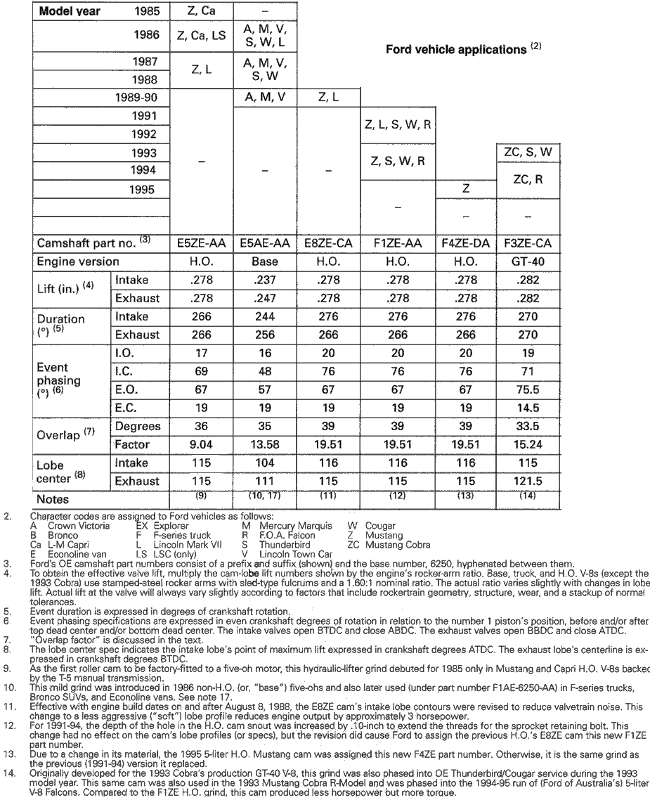

gaslog4 New Member Aug 15, 2016 7 0 1 Raleigh NC Mar 26, 2023 #1 Mar 26, 2023 #1 With these #'s can any Identify this 8.2 deck, SBF Cam... 44-27-00 001-855 F1SE 6250B 200510
2000xp8 SN Certified Technician Aug 8, 2003 8,039 1,625 194 NJ Mar 26, 2023 #2 Mar 26, 2023 #2 F1SE is a just a ford 91 to 96 block. I wouldn't think aftermarket camshaft companies would add that number to a cam, but i'm not sure. My guess would be it's just a stock mustang or explorer cam depending on what the engine came out of.
Mustang5L5 That is…until I whipped out my Bissell Mod Dude Feb 18, 2001 43,271 17,959 224 Massachusetts Mar 26, 2023 #3 Mar 26, 2023 #3 Sure it’s not F1ZE?
