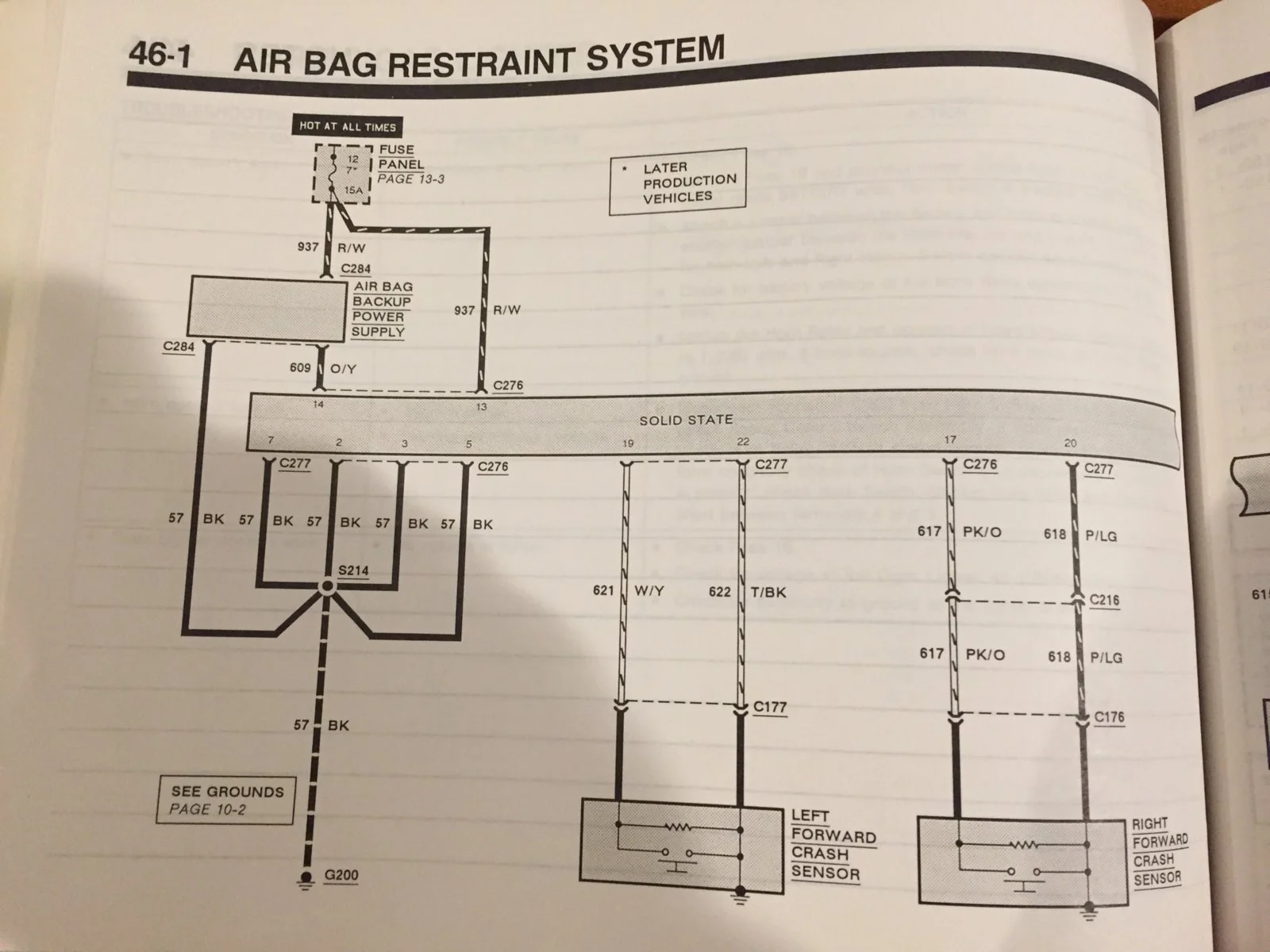

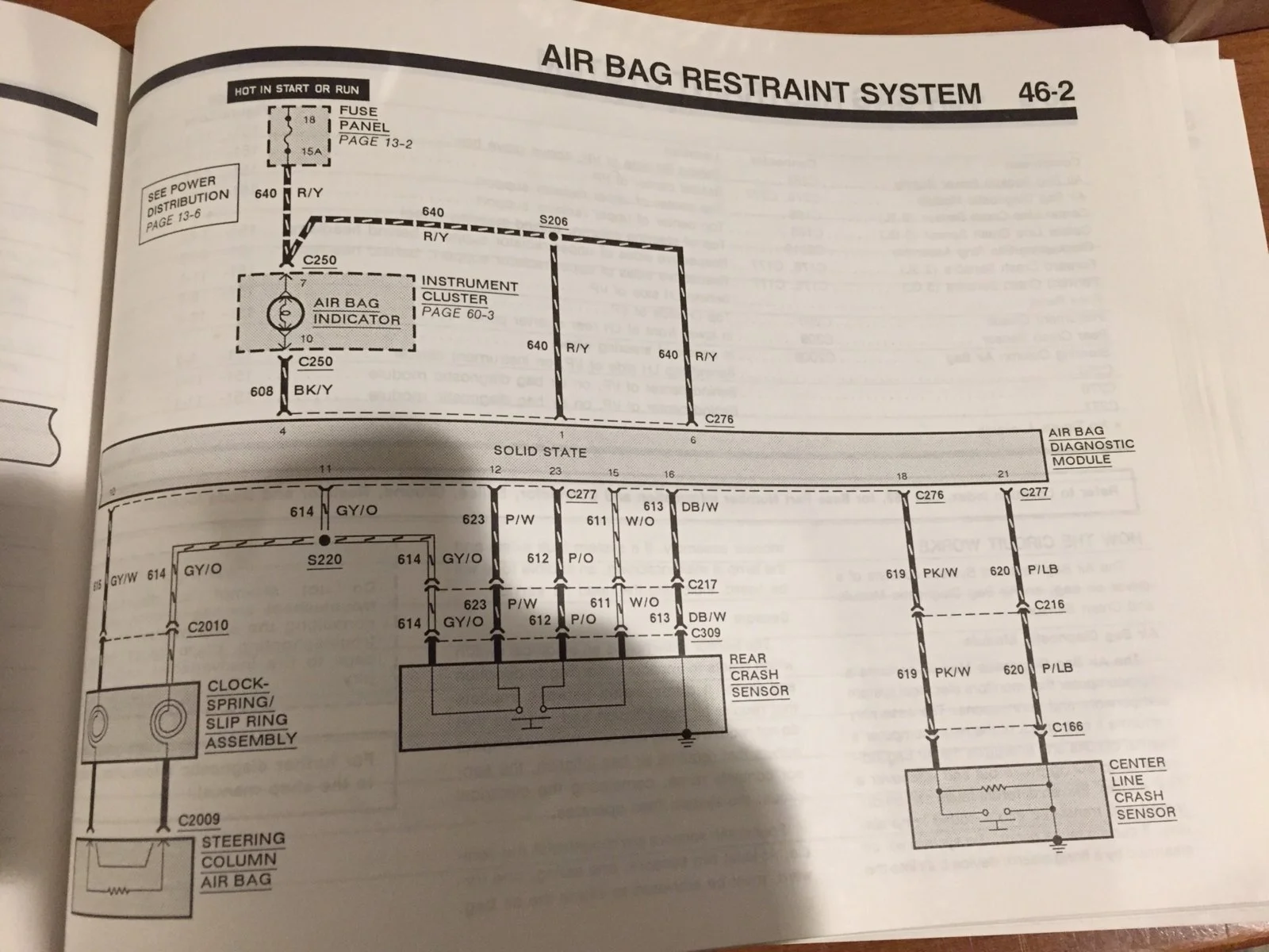

Airbag is completely separate. Has it’s own diagnostic module. As you can see, no connection to the ECU.

Blinking airbag light is displaying a code, so I’d try and ID the code
