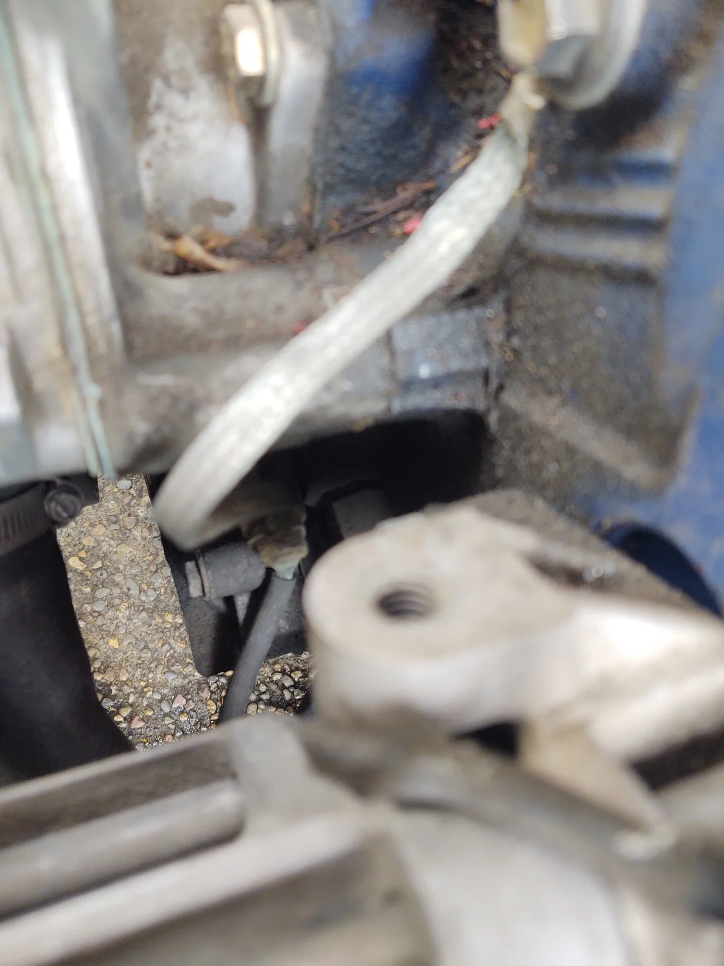

I got the rubber mounts top and bottom with a sve radiator. I did clean the ground connection firewall to cylinder head with sandpaper, and the battery ground cable goes to the engine block. The engine block cable looks a bit green. I tested the voltage in the coolant while it was running and it was under 0.17 volts.

I'm putting the multimeter ground on the battery ground and the positive suspended in the coolant not touching the metal. I do have a new ground cable I think, might try that. But it seems to be gone now, at 0.17 volts. Which from what I have read isn't too high to worry about.
